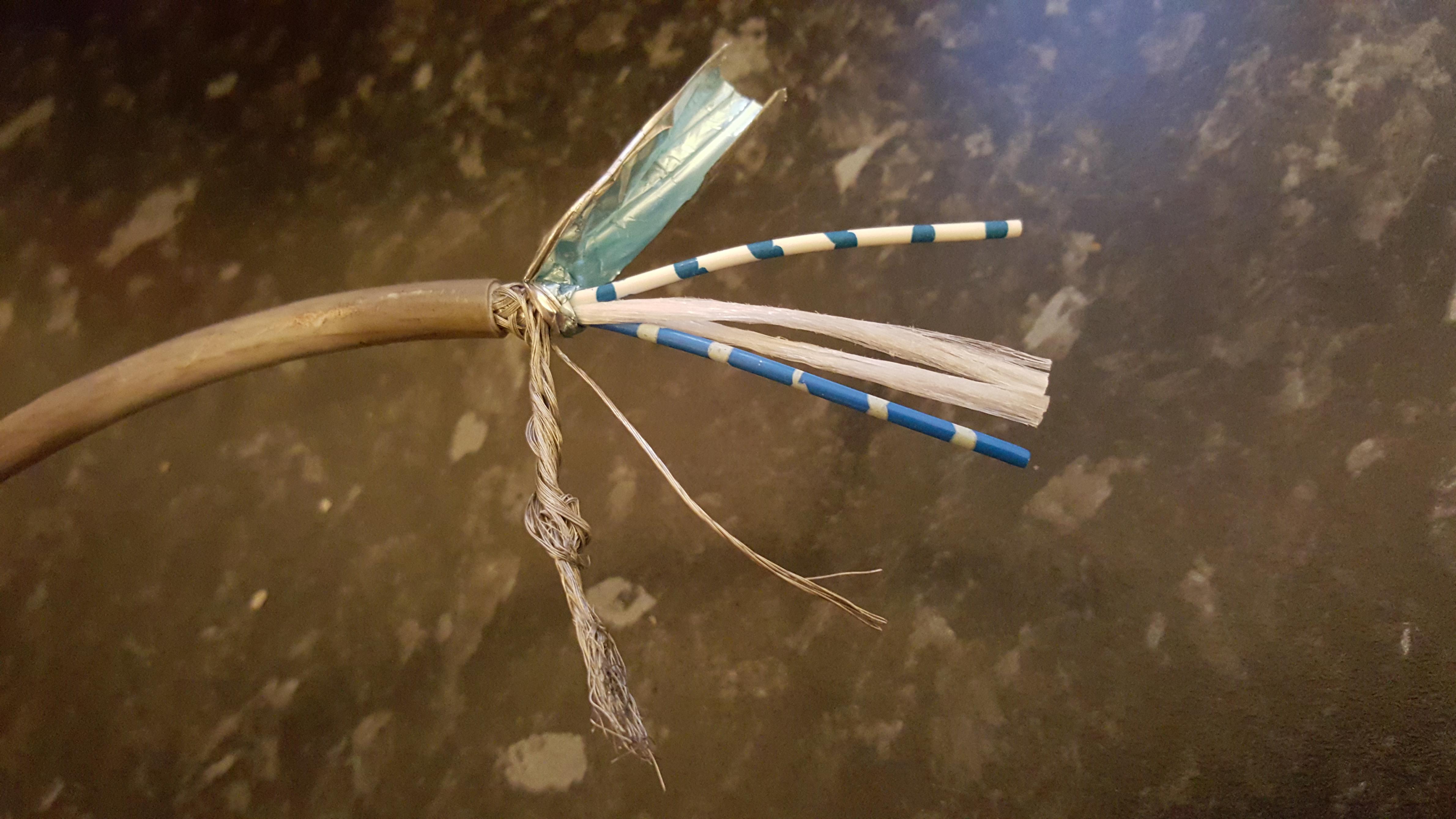

                      I looked at your picture again. Are you not using coax for your lead in to the coil? You should use coax and make sure the shield is on the ground side. Also coil polarity is important try it both ways,
                      • #86
                        I will get some coax tomorrow and try that but i do not have a shield (yet)? also how does the polarity affect the coil as it is a mono loop 'bunched' coil?

                            The coax ground will do most of signal shielding. The coil may be polarity sensitive if there are significantly more windings on the outside of the coil they will act as "self" shielding. If the coil is just randomly wound the coil polarity itself may not make much difference.
                            • #89
                              Hey old cart I have managed to get this Click image for larger version
ID:	345020 it is a two core foil covered 1mm cable with a mesh shield any good?
