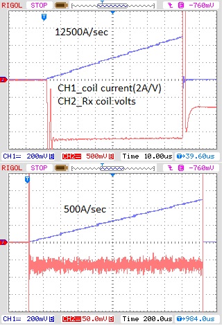

            Thanks, I can control ramp rate(20A/sec to 12500A/sec) or hold current constant at .5A with my target tester. Connected it with separate Tx and Rx coils(Rx amplifier gain=500) to see how low a ramp rate I could detect. Current is in a control loop, looks good when scoping current feedback resistor, but Rx signal to noisy when Tx is on. Current not in a control loop with moodz circuit so it should work. Reply back when I get the circuit working.

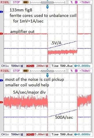

              Thinking I should have tried without the amplifier. Both Tx and Rx were 8inch diameter around 300uH coils. Rx was shielded(thicker) and was taped to Tx. (E=IL/T) 12500*.0003=3.75V, 500*.0003=.15V. (Coupling)1.7/3.75=.453. 0.15*.453=.068 close to measured. 1A/sec calculates an offset of 136uV at Rx(68mV change at amplifier out, gain=500).

                Tried again with the amplifier. Used 133mm fig8 Rx. Looks like I'm getting closer to be able to see a 1A/sec change. Still learning, anyone have any suggestions how to improve the resolution.

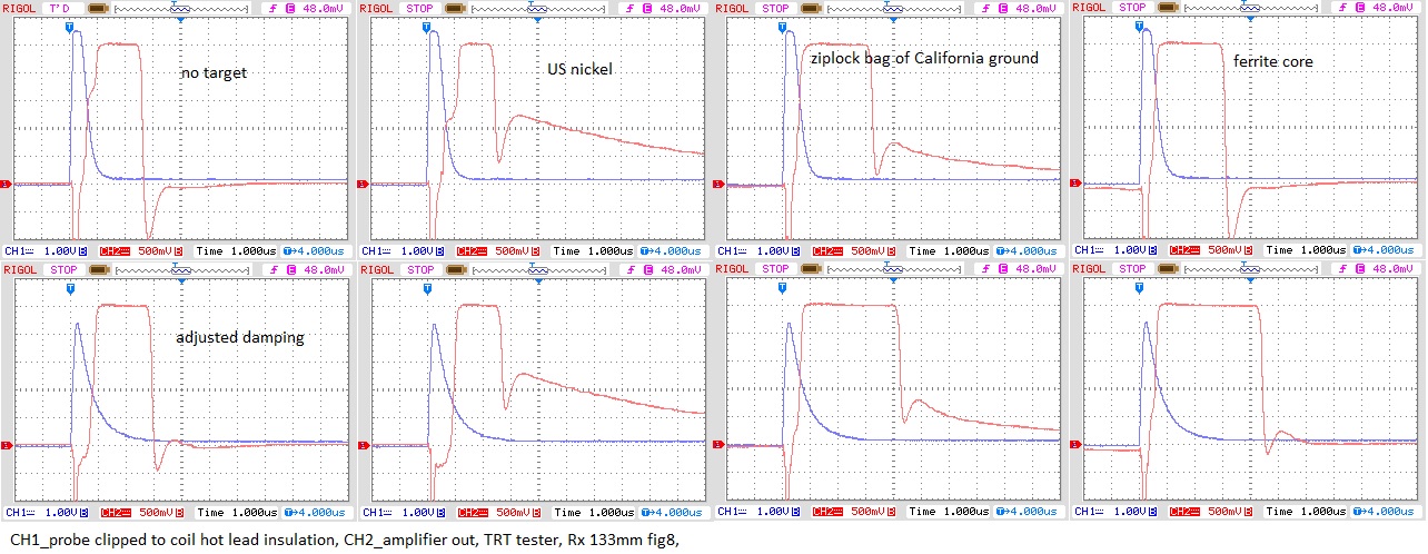

                  Still thinking about measuring steady state current(A/sec)after polarity change, X signal. Still wondering if .2, 1 or 5A/sec is to much. Thinking 250us on time each polarity, .5 to .6 A peak(1 to 1.2A change). I can sample at 4us with the bipolar circuit I'm testing now. Looks like I could sample sooner with Moodz CCPI circuit in spice. Think I might need the X signal gone around 3us after polarity changes. Coil current change is probably between 1 and 2 million A/sec at switching polarity. Still wonder if I can detect a 1A/sec change 3us after a 1.5millionA/sec polarity switch. Wondering if there might another method to detect X signal I tried looking at amplifier out with some different targets with my unipolar circuit. The nickel went negative(X signal)before going positive(R signal). Ground appears to have X and R signal. Ferrite appears to have X signal an maybe small amount of R, R signal maybe do to my circuit. Wondering if there is a ferrite target that has X signal only. Overdamped coil shows more X signal.
