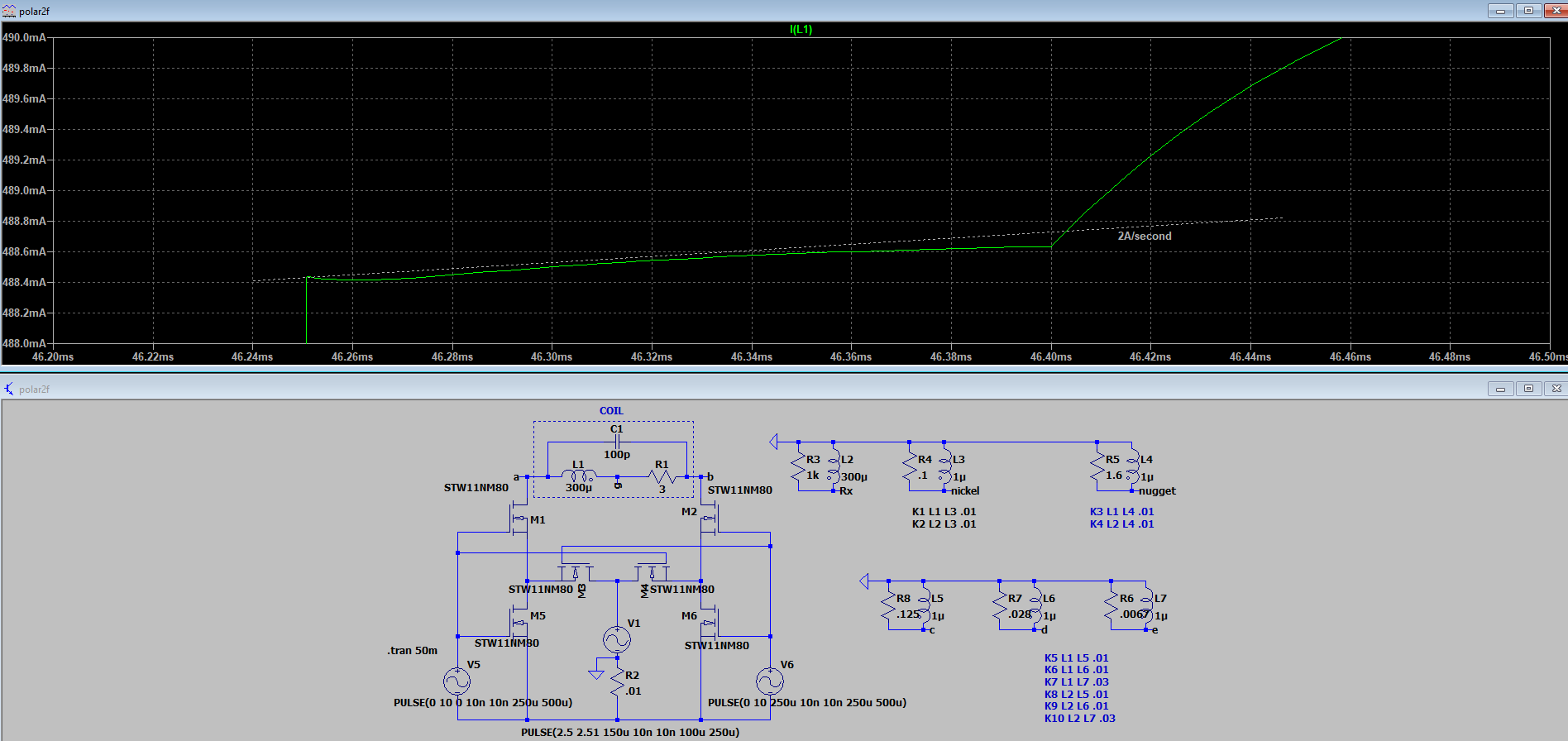

    Is there a way to modify the circuit to make the ramp less steep?
    If I understand your question right. You can add more parallel capacitance across the coil. This will widen the half sine, slowing the change in current. This will also lower the peak flyback voltage. Tfly = 3.14*sqrt(LC).
      I tried stepping the capacitance C1, 100p 200p 400p in spice polar2D(reply #30). Appears ramp is steeper with increasing capacitance.
        The relatively high resistance of your coil is causing the ramp ... increasing the capacitance only makes the ramping worse in accordance with an RC constant.
        You are losing more than half a watt in your coil due to I2R losses.

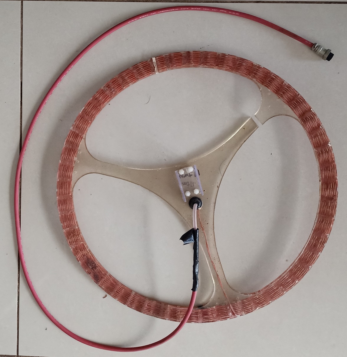

          Thanks, could you describe your coil to get 300uH, .2 ohms and 100p. Diameter, number of turns, wire size, winding method(bundle, spiral, ?)and cable length.

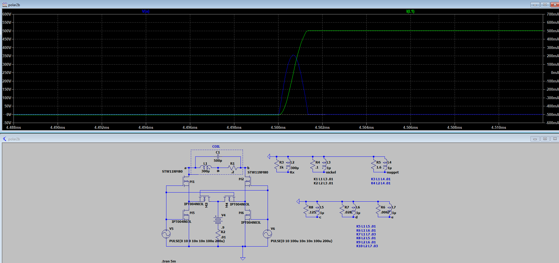

            The polar drive circuit is interesting, would like to try it. My Tx coil resistance is closer to 3 ohms. Tried a spice circuit with Tx=3 ohms and all MOSFETS STW11MN80. Get about 18A/sec ramp at switch point. Is 18A/sec acceptable? Is there a way to modify the circuit to make the ramp less steep?
            Circuit change that reduces ramp with spice. Don't know if would with real circuit.

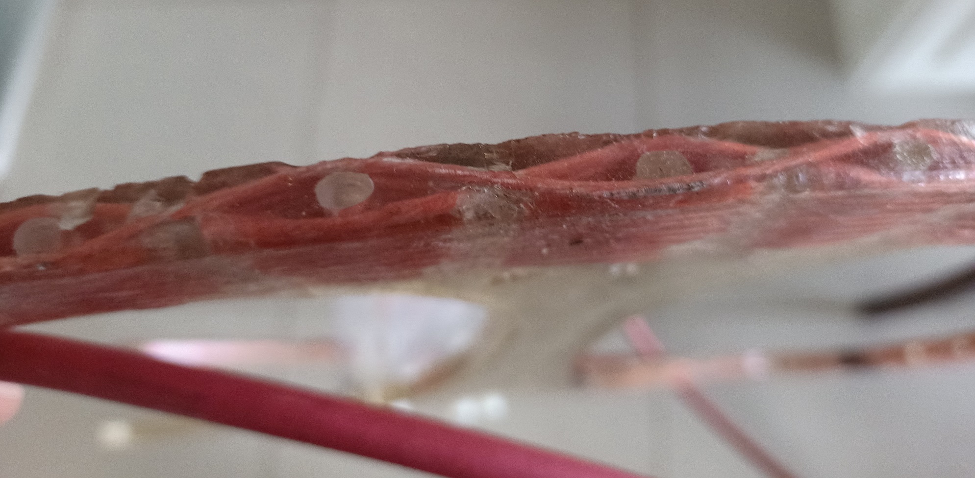

              The coil I use for bench testing is "old faithfull" .. which admittedly has seen better days. The resistance is actually 0.29 ohms. It has 17 turns of very expensive .. at the time I bought it several years ago ... litz wire ... might be 2 mm x section area .. and the diameter is 18 inches.
              Its unsheilded ... and the winds are flat spiral basket weave for minimal capacitance. 296 uH last time I measured it.
              But that is not the point ... a coil is a current operated device .. you dont want series resistances if you can avoid ... just adds to charging times if reactances are involved and power loss.

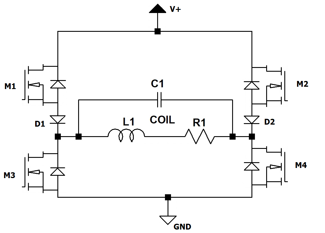

                Hi moodz,
                Thanks for sharing your circuit! Can you please explain how it is performing better than the standard H-bridge circuit with diodes instead of your isolation switches? Is there any benefit in using the MOSFET body diodes instead of normal diodes? In terms of efficiency your additional switches add a bit more resistance in the current path when turned on, though that would be negligible if low on-resistance MOSFET is used.
                Is a single gate driver capable of driving all 3 the transistors at once?

                  The standard H-bridge drive like you show is not capable of square wave current drive. That is the purpose of Moodz' circuit, it is a completely different class of operation.
