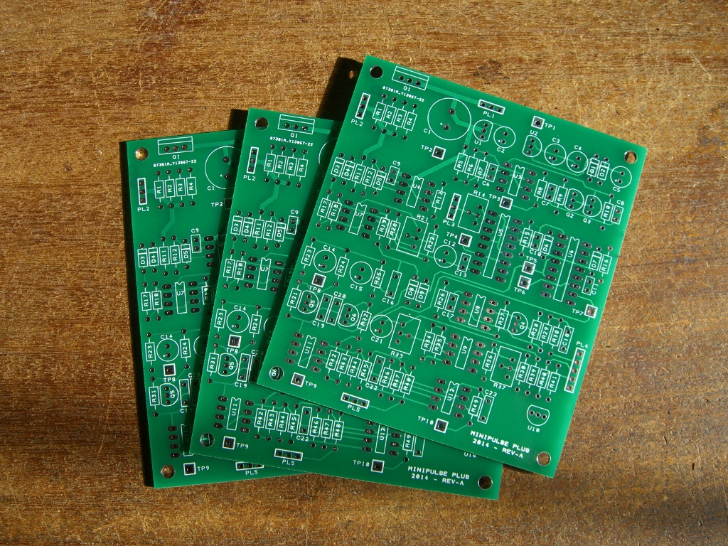

            It appears that this error was in fact flagged by the DRC report, but I missed it (human error ) as a result of modifying the PCB footprint for the cermet trimmers to add a 4th pin. This extra pin produces a number of clearance errors because of the copper track embedded in the footprint, and the track-to-track error near Q4 was buried in the list.
            I'll fix this layout issue later today, but this of course means the first batch of Silverdog boards will need a simple cut and strap operation.
              Just received 3 PCBs today from Siverdog. Once I've got the components together I'll build one unit to check everything is OK, and then write a "build document" to try and prevent the same failures that Surf-PI builders are experiencing.

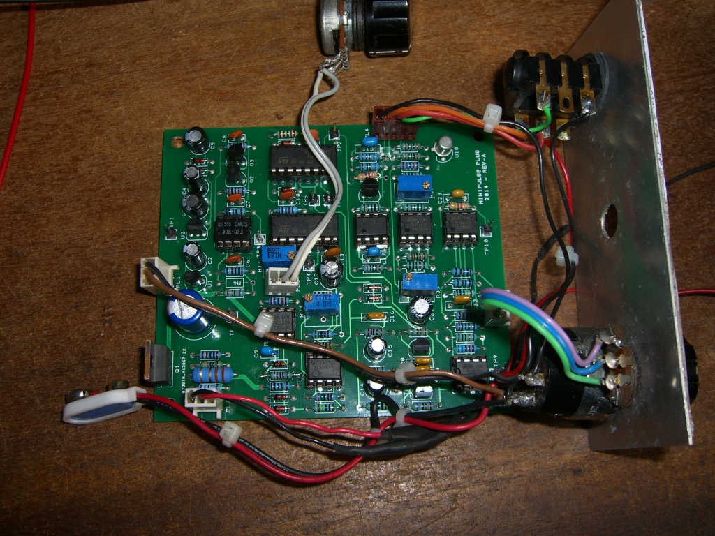

                          I received some sample PCBs from Silverdog last week, and now have a fully working board on the bench. The REV-A build document in currently being written, and in the next couple of days I will send this document to Silverdog, so that he can also complete a working unit. Once this has been achieved, all the information will be uploaded to Geotech, and you will be able to purchase kits from Silverdog shortly afterwards.

                              With the trimmer footprints supporting both in-line and staggered pins, it would be easy to fit a 3-pin connector in place of the trimmer, and take this out to an external pot. A better option for sensitivity would be to make R16 externally adjustabele, as this controls the sample pulse width.
