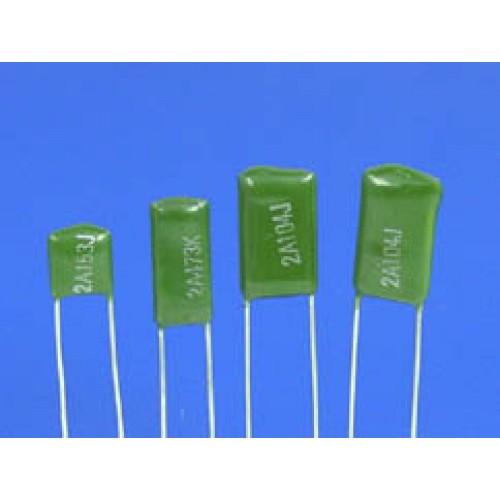

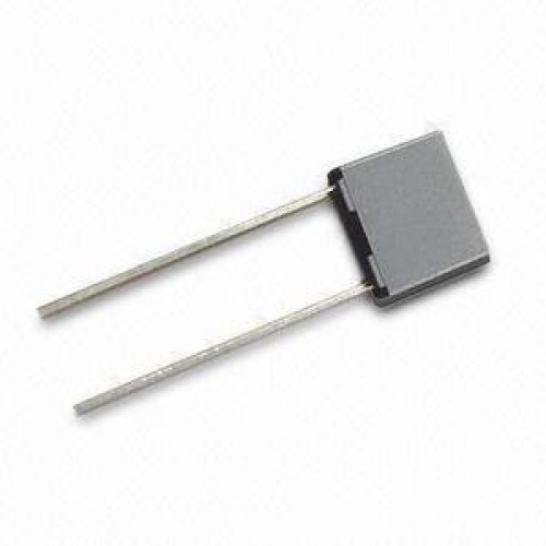

                                Are there any guidelines or rule of thumb for selecting the types of non-electrolytic capacitors in detector circuits and are some types more suited to some parts of the circuit than others? The parts list suggests poly. capacitors and I was looking at purchasing the poly caps in the attached images but noticed that different looking caps had been used in the image in post #27 which seems to suggest that more than one type of capacitor would be suitable. In searching for caps I have also come across ceramic NPO/COG types that look like they could be suitable for some areas, are they worth considering? Thanks.
