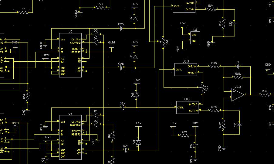

        • Hello everyone.
          I want to replace the transistors channel field effect "N" on my GS4 homemade, built by 4066.
          I have several questions, about feeding the 4066., Ie with (+5 and -5) or (+12 and -12).
          Same question for the time base, composed of integrated 45038, (+5 and -5) or (+12 and -12).
          E seen different configurations in the forum,
          I have a partial outline, made of Dip Trace. I appreciate any help.
          Jose
          • If I understood you correctly, you wish to replace the FETs with 4066 switches in your GS4. Unfortunately it is not possible without corrections to the power supply to 45028, and a level shifter for their signal input.
            You could add 100k resistors in series with the FETs' gates that would force them to behave.

                    • Thanks to all
                      What I try to do is GS4, with some improvements as it has in GS5, with the greatest simplicity.
                      The idea is to try to use bilateral floodgates of 4066 instead of the J113.
                      In the scheme of the GS5 published, you can see they use the same time base GS4, but with the addition of 4 diodes and 4 capacitors, 1N4148 100 nf.
                      I hesitated, for I see in some schemes timebase fed (5 and -5 Volts) such as the Surf PI.
                      In GS4 and GS5, the time base, are fed (12; -12.. GS4 ) and (-10 and -10 ... GS5).
                      The floodgates of 4066, are fed into the PI, HH1 and HH2 surf with (5; -5).
                      Attached is a screenshot of part of the scheme, for better understanding and opinion on the matter.
                      Thank you.
                      JoseClick image for larger version
                        This is why I prefer the LT1054, with an operating range up to 15V, and (when used as a voltage inverter) it doesn't drop out until 8.4V (1.05V per cell).
                        Also, the LT1054 provides much lower voltage losses than the ICL7660A.
                        After a long while, I realised that the whole function og LT or ICL in sync mode here is a dumb MOSFET complementary pair driver with some silly bells and whistles that are not used at all, and that I can get it all by simply replacing the IC with a pair of mosfets, say 2N7000/BS250. And get the whole thing running at 1/10 price of a chip that refuses to get synced. :duh:
                        I'll see what it takes in LTspice tomorrow.
                          I'm not sure what schematic you attached, but this kind of change is a complicated one, and benefits are marginal. You could do better if you replace TL074 in integrators with a faster low noise op amp with FET input.
                          Diodes and capacitors in the attached schematic form a sort of level shifter that can be used to control 4066, and only because in GS4 the 45038 are supplied with -12V.
                          • Thanks Davor
                            On reflection, and when in doubt, I think I will use the J113, or any replacement. This way I'll have an easier PCB and fewer headaches.
