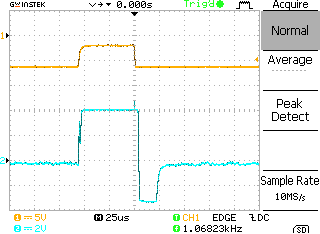

        Before you do the modification, connect scope channel 1 to TP1, and channel 2 to U2 pin2. You will see the two signals are asynchronous.
        Then fit the 100pF capacitor and you'll discover the two signals are locked together. Simple really.
        I tested for any unexpected side effects, such as the +5V supply dropping out at a higher voltage, but could not see any difference. There was also no discernible difference in the detector's sensitivity, but at least everyone can stop mourning the demise of the sync pulse. I will update the latest (REV-C) Build Document tonight, and post the fix in both the REV-B and REV-C threads.

          The LT1054 is still running at its normal internal clock of 20kHz, but the signal at U2 pin 2 goes high during the time the TX pulse is high (Q2 collector low). Effectively, the TX oscillator is giving the LT1054 a swift kick at regular intervals of about 1ms, with the result that it's not being directly clocked at the slower TX pulse rate, and we have a win-win situation.

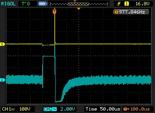

                            • I am attempting a REV B build, just finished the RX stage. The signal at TP3 seems a bit noisy, is this normal? This is without the sampling integrator added, which starts with R18. Picture attached. Top trace is the flyback signal.

                              • Originally posted by joop View Post
                                [ATTACH]30670[/ATTACH]
                                What are the details of your coil? The timebase on your scope is set to 50us, and the RX signal is still settling. Or perhaps your damping resistor is not the optimum value?
                                Here is a scope shot of my MPP. Channel 1 is connected to TP1, and channel 2 is connected to TP3. As you can see there is some noise on the signal, but nowhere near as much as your's, and this is running from a bench power supply (which is also noisier than using batteries) and next to two computers, and low-wattage fluorescent lighting. I'm using the original Minipulse (500uH) coil, and you can see that it settles within 25us,
