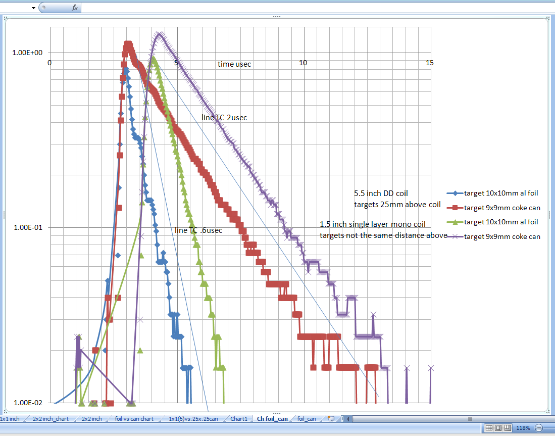

    A 0.47 gram nugget (7.25 grains) can be emulated with a 9mm x 9mm aluminium square from the side wall of a Cola can. Your 10mm x 10mm square of aluminium foil is much thinner, so I doubt you'll be able to detect it.
    Thanks for the information. It's the first time I remember seeing a target size referenced to a nugget size. I recorded some data with the two targets. Did it with two different coils to see if the time constant stayed the same. Got .6usec time constant for foil and 2usec time constant for the can.
