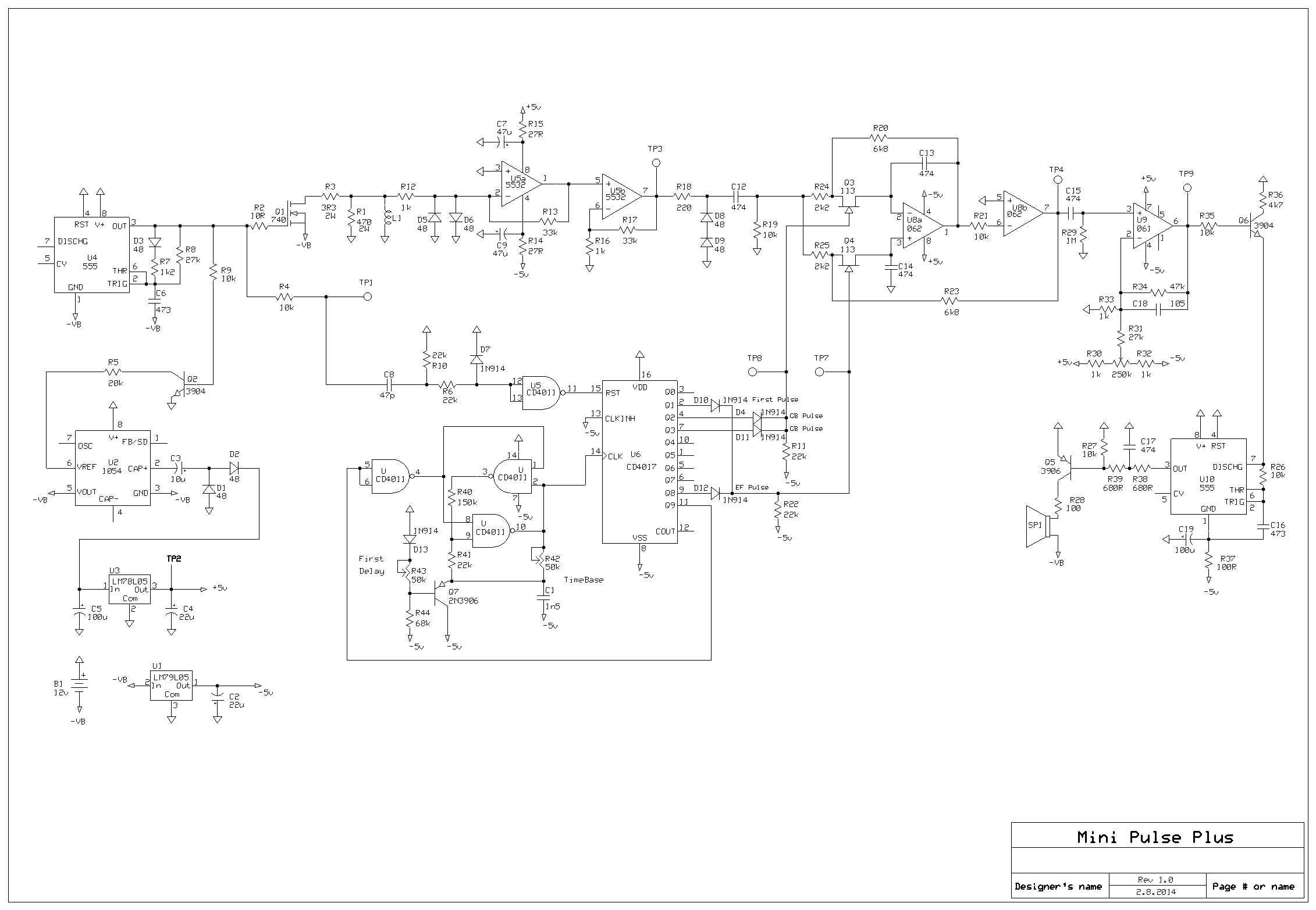

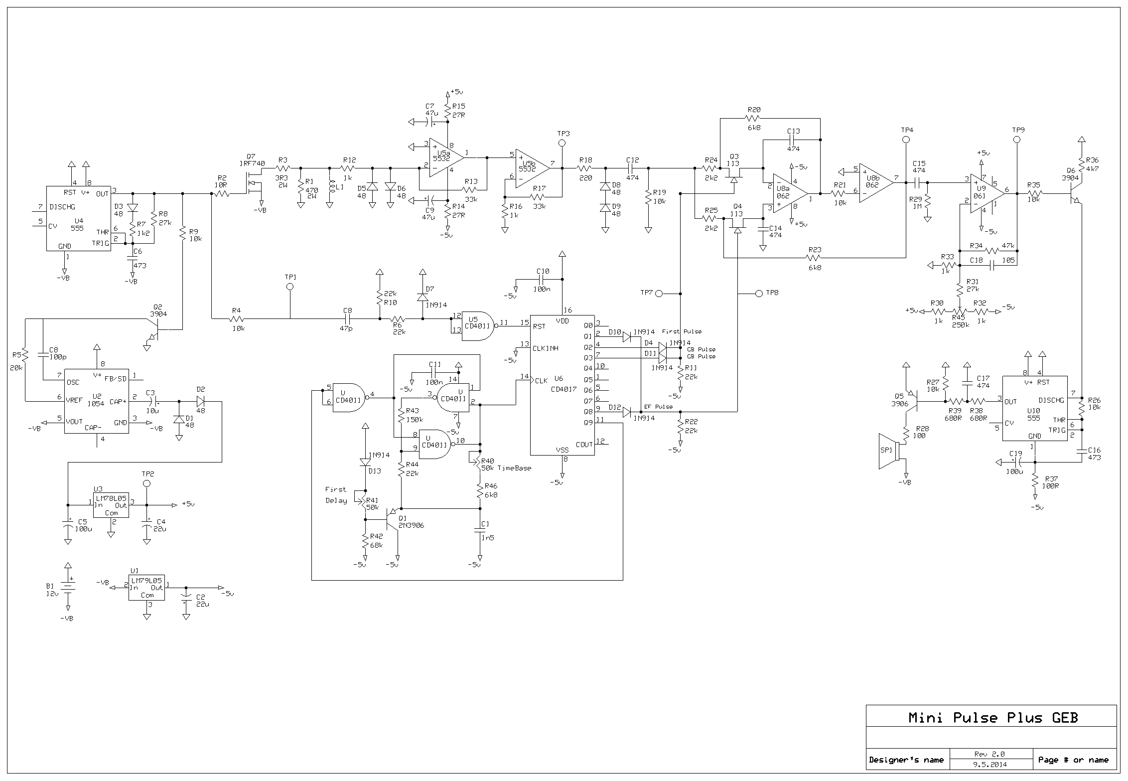

  • So I'm working on a MiniPulse build and hope to incorporate the gorund balance circuit
    from the start. Here's my schematic. Can someone give it a look and make sure I have
    everything correct? The power configuration is a bit funny...

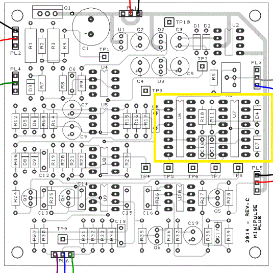

      • Your welcome! I'm hopeing to make an upgrade board that will sit where the
        removed components are and show the layout here. They would go in the yellow
        box in this picuture;
        Still trying to figure out how to connect the new board. Wires can break if handled a lot
        so maybe stacked sockets so it can just plug in...

          It seem mostly OK. R42 needs some resistance in series, say 6k8, to prevent overload. Also there is no decoupling on U5 nor on U6.

            The 100pF sync cap is missing between Q2 collector and U2 pin 7.
            • Ok I fixed it. Here's a picture and the ExpressSCH file;

              • SD thats great work thanks,
                could you please consider providing pads for a series diode between the coil and fet ?
                if people dont wont to fit the diode then they just insert a jumper , but the holes need to
                be about 1.2mm to account for the thick legs on some of the fast diodes, thanks.
                • SD Davor suggested R42 to be 6k8, your schematic has it at 68K.

                      • Do you know were I can find the unmodified ver C circuit diagram for the MMP. I want to do a side by side comparison with your GB version diagram.

                            • Originally posted by josewashere View Post
                              Minipulse Plus REV-C
                                You mean R41 from SD schematic?
