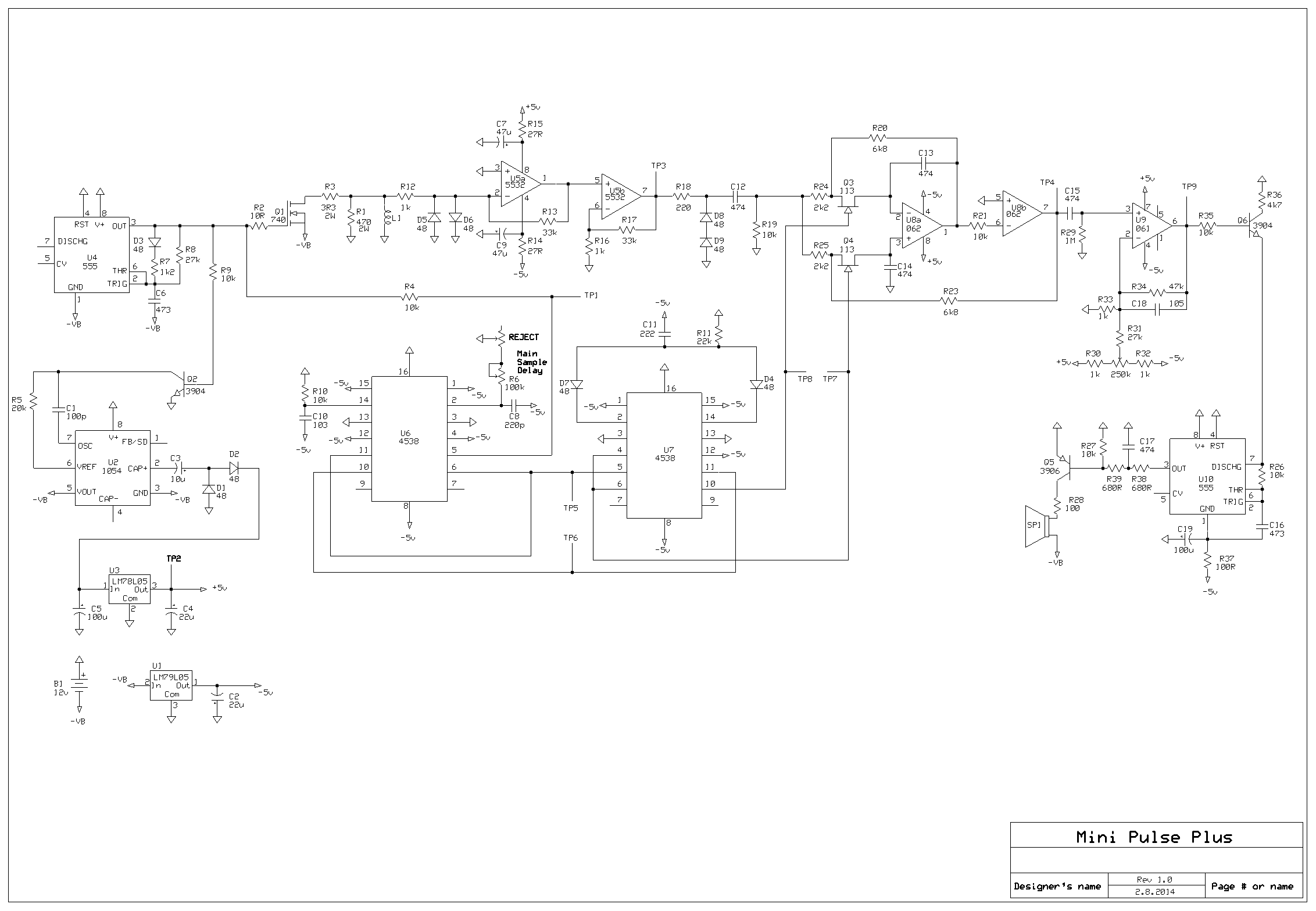

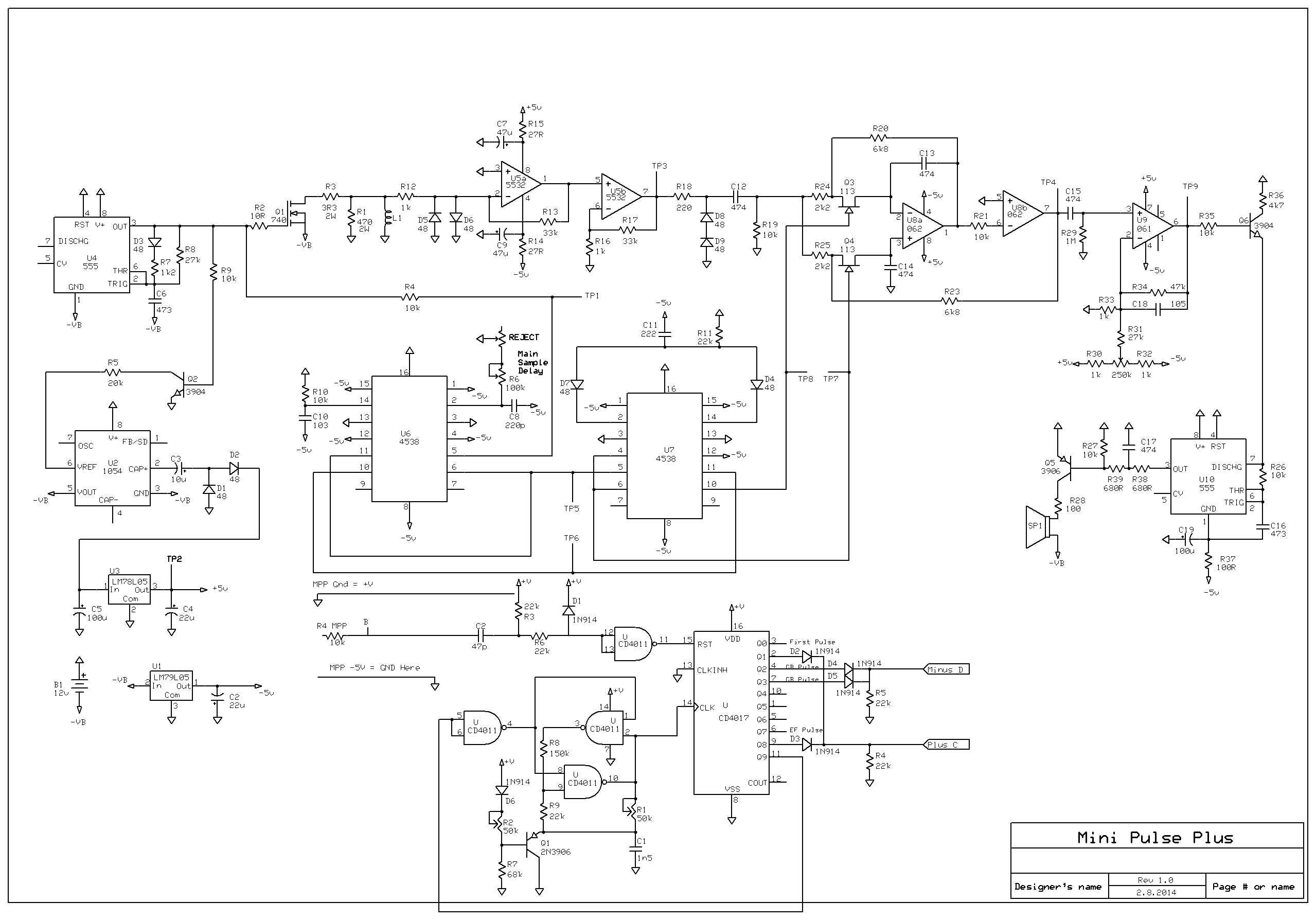

  • Here's the picture and SCH for ExpressSCH for the original by Ivonic;

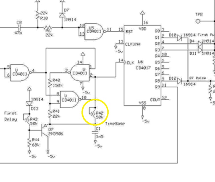

    Oops I edited the schematic at work and posted it but didn't bring it home
    so reedited it at home and so now some of the designators are different...
    Here's where R42 is that Davor was talking about. You need a min value for the
    pot;
    • Here's a picture with both circuits on it;
      • Originally posted by Silver Dollar View Post
        [ATTACH]31152[/ATTACH]
        Thanks that's what I wanted! Great work!
          Thanks Qiaozhi I wanted one that used the same layout as the GB one by silver dollar as I wanted to see what the GB changes were. Would be good to make the changes on a small pcb that just plugged into the existing ic sockets. Now I want to have a good look at both diagrams to see if its possible.
            Ok I fixed it. Here's a picture and the ExpressSCH file
            That's more like it. Thanks!
            BTW, 1N914 and 1N4148 are basically a same thing, only 1N914 are produced with somewhat tighter tolerances. In the GB part there is no specific need for 1N914, and whoever will make a BOM may simply turn all 1N914 to 1N4148 to make things simpler.
            • Thank you Silver Dollar for what you shared with us your great work... best regards!

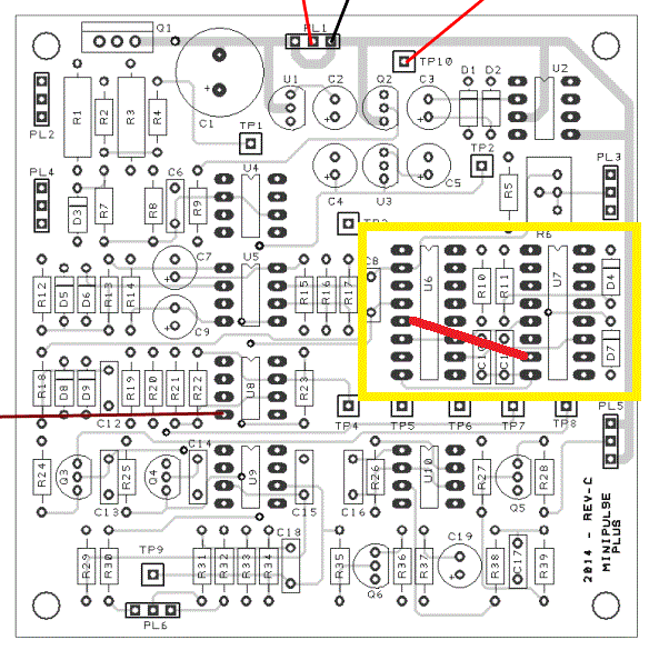

              • I though of jumping pin 5 on U6 to the nc pin 7 on U7 then using a machine pin socket
                to plug into U7 where you can get all signals. I also have thought of using this circuit
                on Hammer head and DeltaPulse so a small run of boards might be in the cards. Unfortunately
                the chips are layed out a bit differently on those boards so I have to analyze the situation
                a bit before building.
                The add on board would be here in yellow
                • SD you keep changing the designations of the components the resistor 42 I was talking about was from post 501, then its changed designation to R44 in post 511, now its R7 in post 512.
                    [ATTACH]31164[/ATTACH]
                    Sounds great!

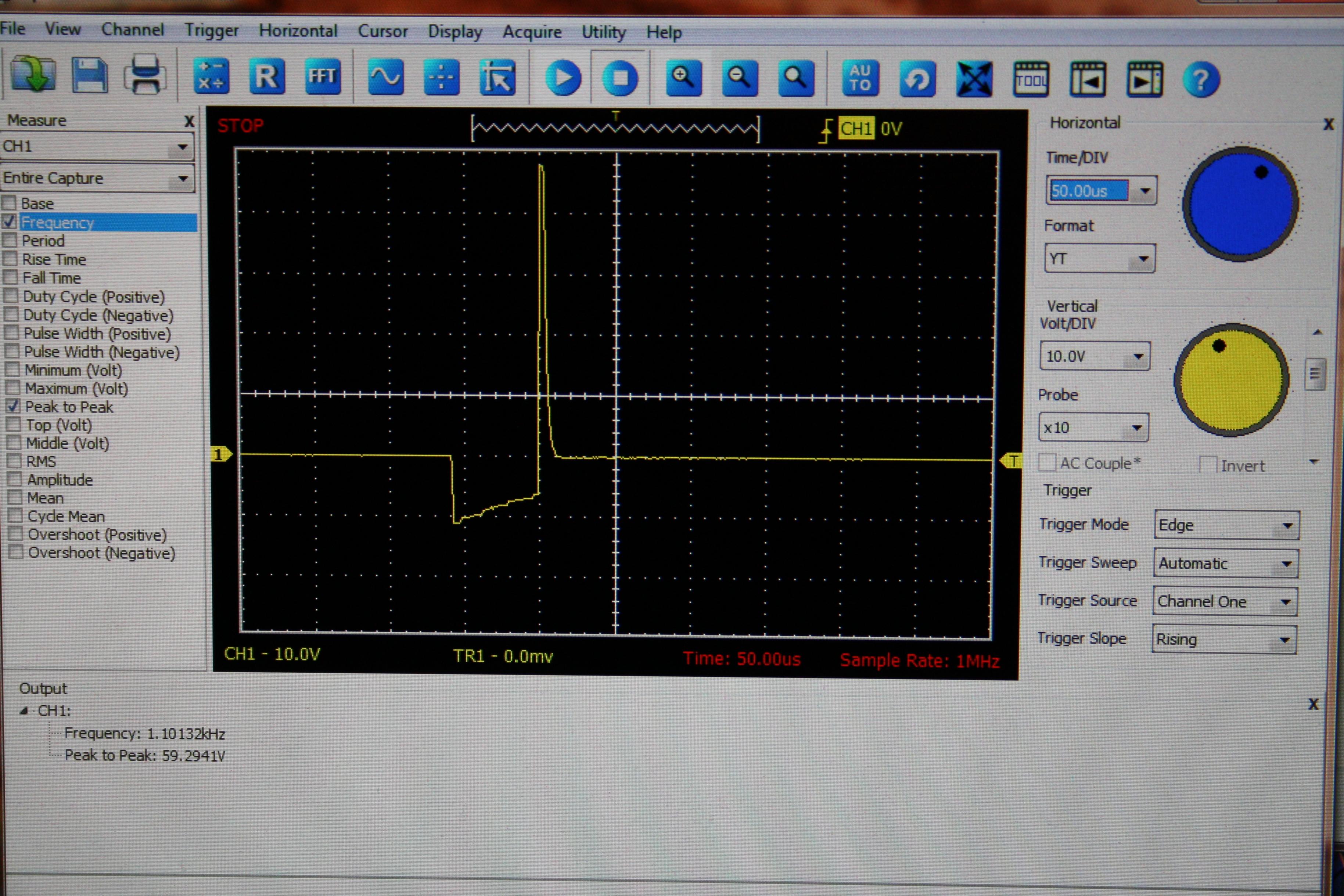

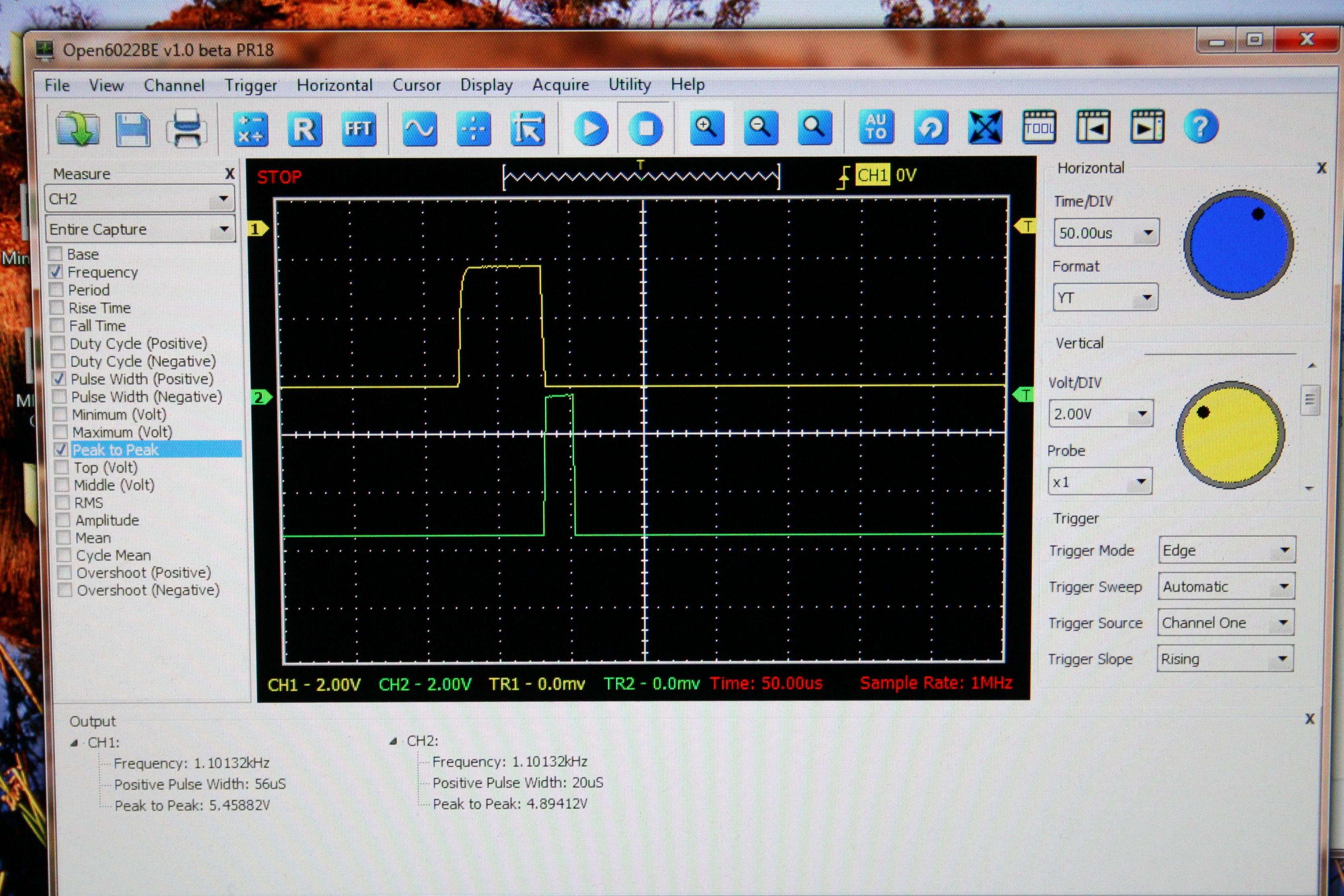

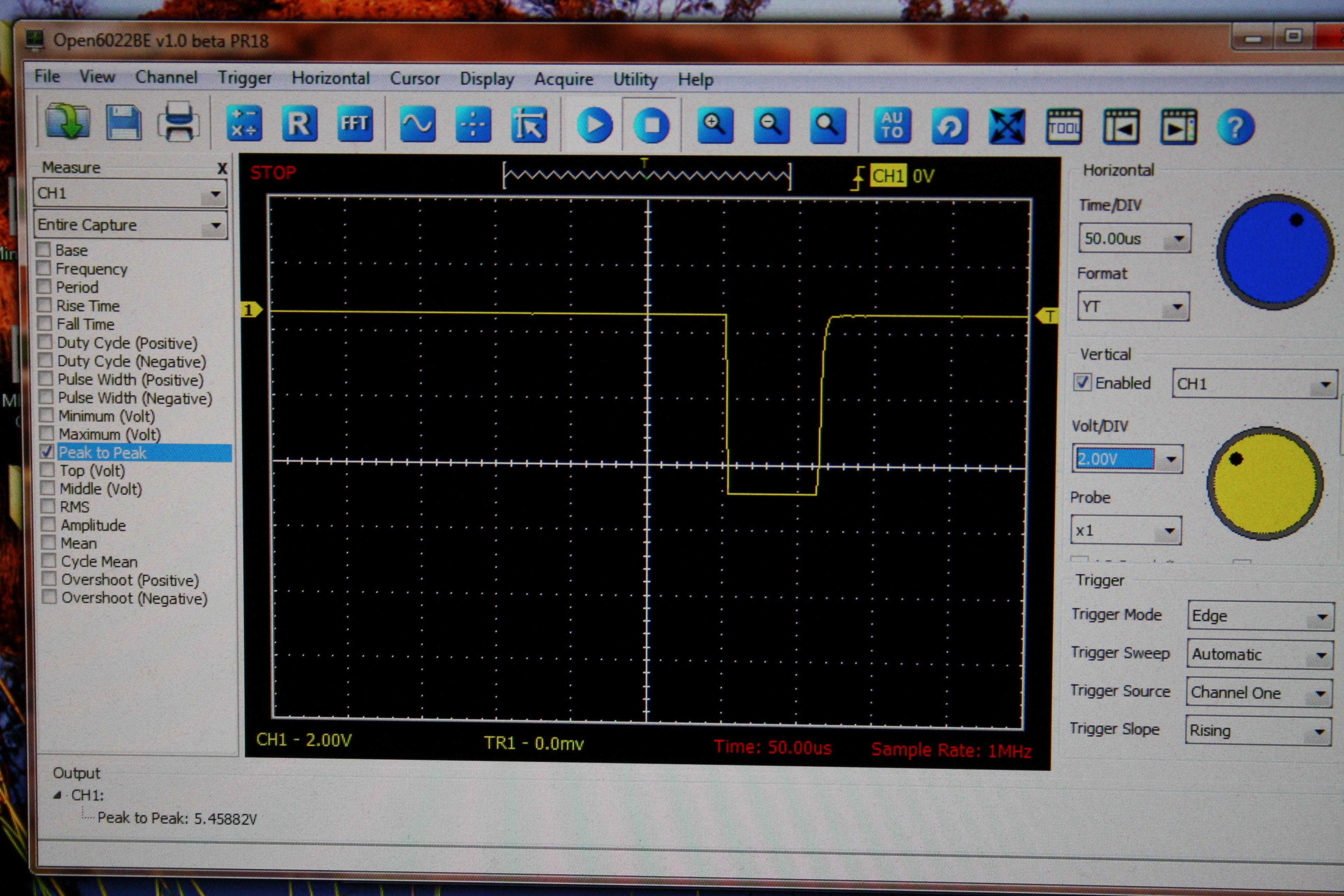

                      • Low flyback voltage.??
                        coil 398 uh
                        1.1 ohms
                        scope shots with coil and without. (10nf cap)
Name:	Tp1 and Tp5.jpg
ID:	341696 Click image for larger version
ID:	341694 Click image for larger version
                        • Originally posted by johnandles View Post
                          coil 398 uh
                          1.1 ohms
                          [ATTACH]31183[/ATTACH] [ATTACH]31181[/ATTACH] [ATTACH]31182[/ATTACH]
                          Your probe is set to x10 in the flyback image, so the voltage is actually 10 times higher than displayed.
                            The probe is set to 10x, but the software being set at 10x only multiplies the actual reading by 10.
                            If I leave the probe at 10x and put the software at 1x it reads 5.9 volts.
                            So I believe my flyback is too low?
                            Any ideas?
                              Any ideas?
                              In that case your PC scope is working differently to a normal oscilloscope. In fact, I see what you say is correct, as the charging period appears to be the right voltage.
                              Is the detector completed, or are you part way through the construction?
                                The board is completed,not housed.
                                Trying to find the problem.
                                The scope is a Hantec usb scope.
                                The coil is a hand wound magnet wire formed to a fiqure 8 to reduce chatter in my interference infested room. lol
                                cheers
