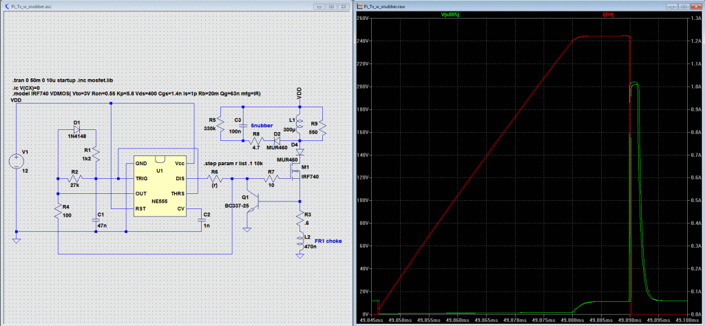

                      Here is my attempt on a constant current drive with a snubber. V(n005) is a coil voltage (".step param r list .1 10k" is only acting as a switch)
                      It is apparent that even with a snubber that nicely shapes the flyback, with shutdown acceleration the voltage gets a bit higher.

                              My thought exactly, except that most people are blissfully unaware that there is a pin 7 of NE555 that only sinks current, and thus may come very useful in accelerating MOSFET shutdown.
                              Hi Davor, I use a MUR460 and 200v zener for my snubber circuit. The other difference between my circuit and yours, is I have the MUR460 connected directly to the Drain of the Mosfet.
