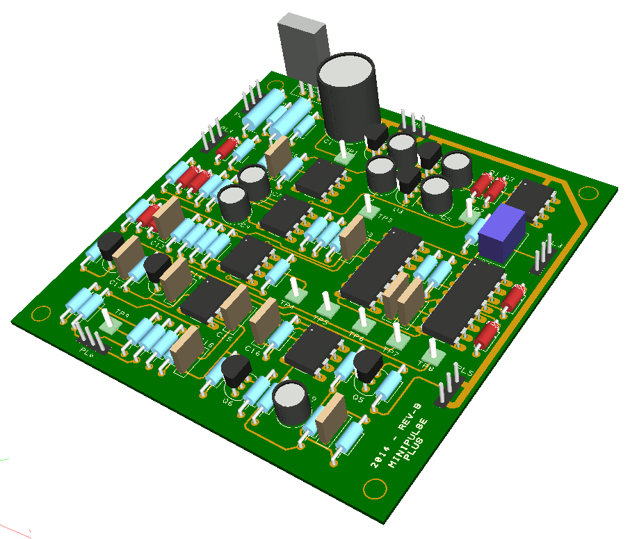

                    The MiniPulse Plus (Rev-B version) has taken a few steps closer to completion.
                    Tonight I managed to complete the component placement and completely routed the board ... without any DRC errors.
                    Sometime over the next couple of nights I plan to generate the Gerber files and get these off to Silverdog.
                    This latest version has the following features:
                    1. A 2-stage pre-amp, which will allow earlier sampling.
                    2. Diode pump circuit replaced with an LT1054, and synchronized with the transmitter. Both Silverdog and I had some unreliability problems with the original circuit. The battery pack can now drop from a nominal 12V to below 8V before the +5V supply starts to drop out.
                    3. PCB size reduced to 3.5" square.
                    4. There is now only one on-board trimmer. This is the setting for the minimum sample delay.
                    5. Battery check circuit eliminated. Silverdog persuaded me that this was not really necessary, and it was difficult to calibrate without a bench power supply.
                    6. There are separate connectors for TX and RX to allow the use of a DD coil if required.
                    7. The loudspeaker amplifier is now the default output, which simplifies the wiring for the headphone socket.
                    All of the above changes were made after building the Rev-A version, and deciding that there was little to differentiate the MiniPulse Plus from either the Surf-PI or the Barracuda. Hopefully these improvements will make this a worthwhile project to construct.
                    More later ...

                        The board is beautiful
                        The only component that may receive a bit of TLC could be the large electrolytic capacitor, as there is no room to bend it on a side ... unless the test point pin is omitted.
                        I like it
                          I like it
                          Me too. Exemplary design.
                          Qiaozhi you say that there is now only one on-board trimmer. What sort of outer controls are foreseen for Minipulse now?
                          Are there outer meter (something like VU-meter) provided?
                          • #73
                            The external controls are Audio (which sets the threshold) and Reject (which sets the sample delay).
                            Apart from that, there's the On-Off switch (can be incorporated as part of the Audio control), headphone socket, and coil connector.
                            There is no external meter. Why would you want that anyway?
