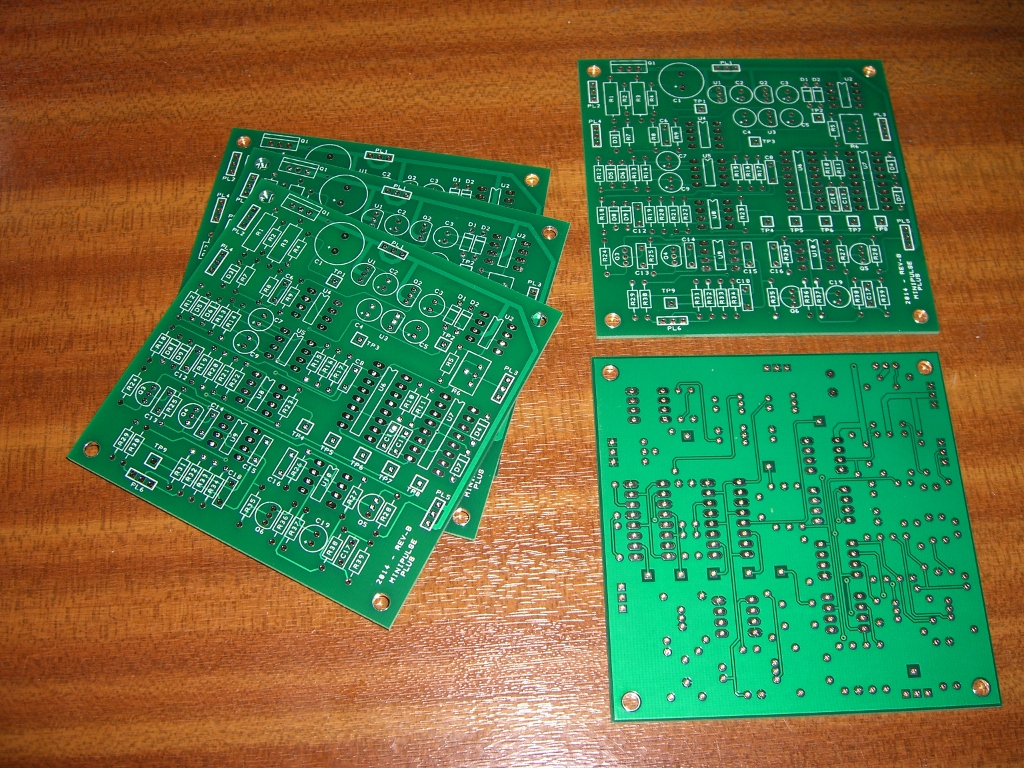

              • #82
                One small step ...
                Andy (Silverdog) sent me a few of the new Minipulse Plus REV-B boards, and they arrived today.
                They look good ... and now I just need the time to build one and write the documentation.
                So please be patient. We're slowly getting there.
                • #83
                  • #84
                    These look very good.
