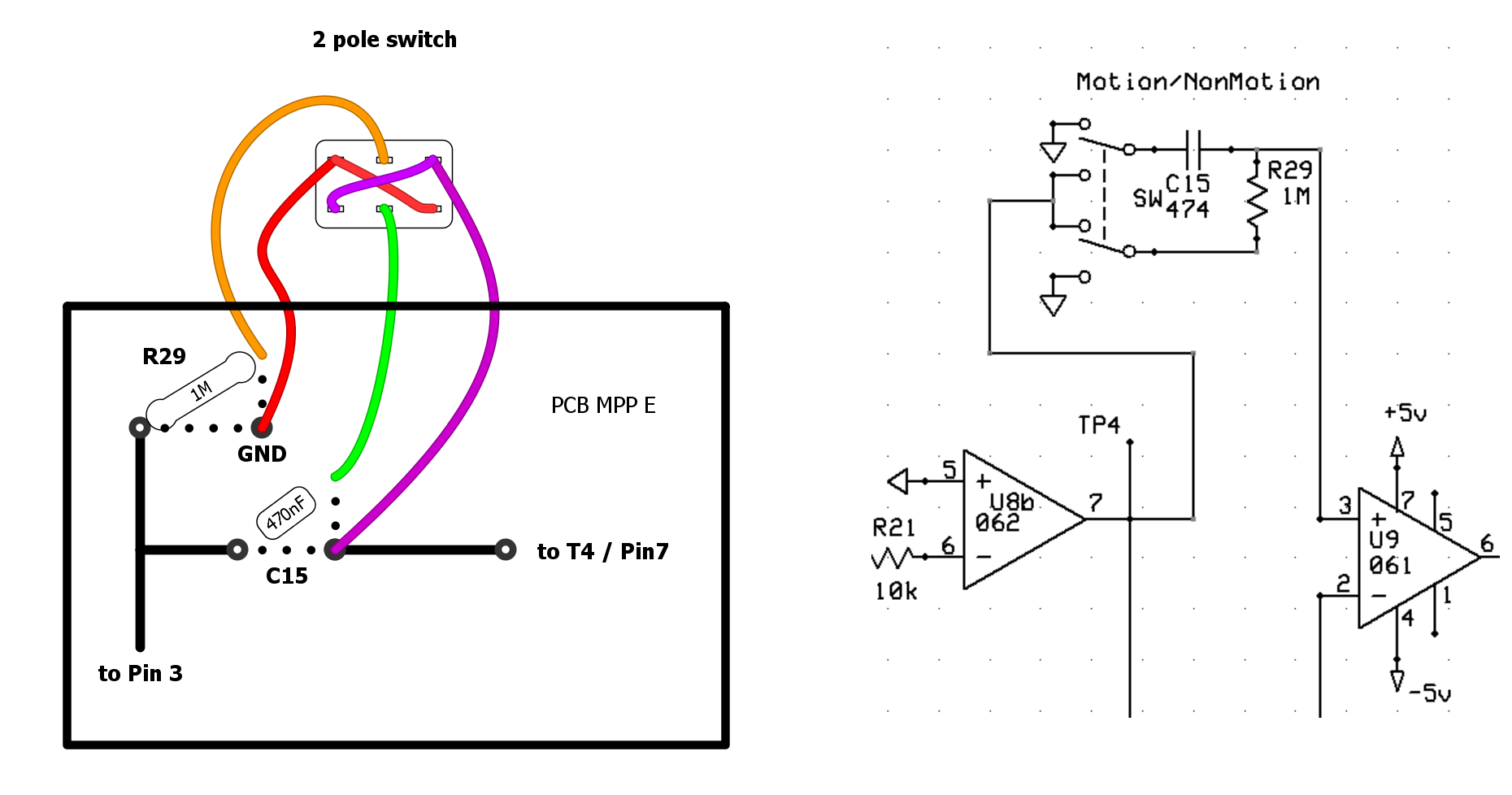

    To remove the SAT permanently and use non-motion, you can swap C15 (470nF) for a 100k resistor, and R29 (1M) for a 470nF cap. (See original MiniPulse schematic.)
    Or - you can probably simply add a switch in series with R29 to toggle between the two modes. I haven't checked this as a solution, so you'll have to try it.
    Hi George,
    I tried this with a double toggle switch. The static mode does not work, no audible signals at all.
    When switching back over to sat-mode the MPP works just fine again.
    What might be going on here?
    Here's my "translation" of the schematic for that into a wiring diagram. Maybe something is wrong!?
    I also tried an on/off switch in series with the 1M resistor like you mention.
    It works in a quasi static mode with constant reduction of detecting distance.
    Usable for around 15-30 seconds, too short for my pinpointing adventures.
    That is why I would like the first mentioned possibility to work.
    Any ideas?

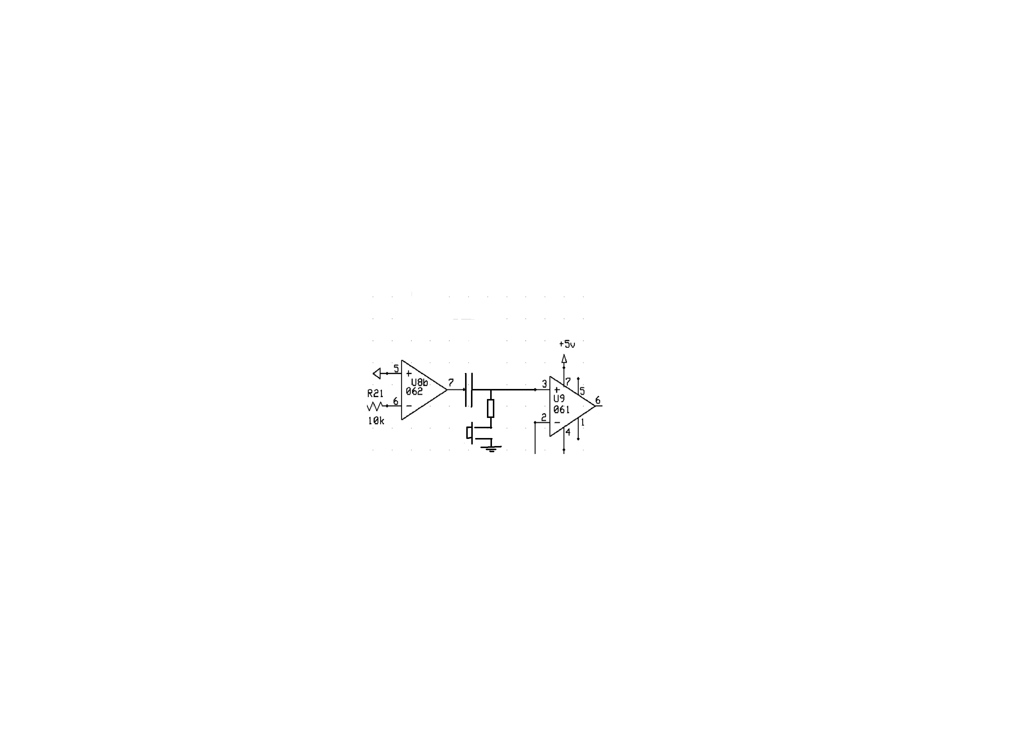

    • Not so easy, offset problem in the next stage, (061) "zero" button is necessary

      • Originally posted by Xtrem View Post
        [ATTACH]46466[/ATTACH]
        Thanks Xtrem. I do not want to install an extra pushbutton for this ... will be difficult.
        I might try toggling to a larger resistor when going in "static" mode. eg. 5-10MOhm.
        Or I might try what I believe Carl wrote "... important to have low input bias current ... " the opamp LMC6082AI has only 4pA, so might work for this.
        But am just getting into reading datasheets so it would be great to know if someone has already tried it or is this nonsense?
        I am not looking for constant static mode, but one that works at least for a few minutes without losing much depth.
        • 061 may do it for SAT, but 061 in a previous stage is the one feeding the offset and 1/f noise. Picking an opamp with a low 1/f corner frequency for the circuits prior to SAT will improve things a lot. Bipolar opamps tend to have a significantly lower 1/f corner.

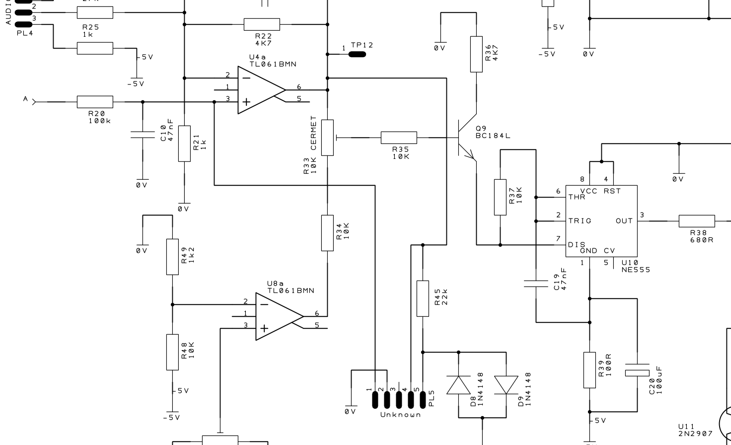

                Thanks Qiaozhi, I have been playing with the Crossbow version of the "static" mode you mentioned. It works quite well ...
                Am having a closer look at the original MPP circuit now. Is this the part that you mean with the swapped R 100k and C 47nF as compared to the MPP E 470nF & 1M?
                • Originally posted by Polymer View Post
                  [ATTACH]46571[/ATTACH]
                  Yes, that's correct. The original MiniPulse circuit does not provide a self-adjusting threshold, as the 100k resistor and 47nf capacitor form a low-pass filter, whereas the MPP uses a 1M resistor and 470nF capacitor as a high-pass. If the Crossbow's quasi-static mode works for you, then that's probably the best option. Reverting back to the original MiniPulse configuration (with the reduced gain) with not only lose depth, but will also require constant manual threshold adjustment.

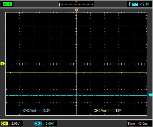

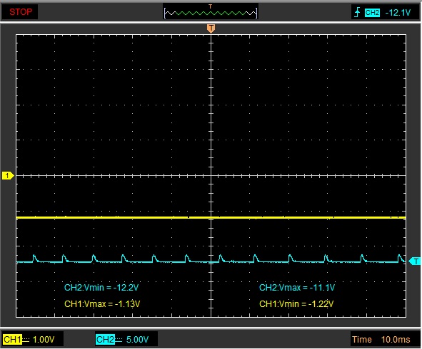

                          • I took measurement on my oscope with audio treshold low enought to cancel buzzer to ring. The second was took when it start to ring continously. All this experiment was made without coil CH1 on TP1 and CH2 on speaker positive.

                            • Originally posted by Albdelafar View Post
                              Thank you very much for the reply !! It is my second board of minipulse rev_e and I have the same problem on both but higer on this one who is the second that i build to do experiments on diff?rent pre amps. All steps are good until step 8 or I find -4 and +4v and variation when a taget is near the coil. So I suppose that my issue is on the audio stage am I right ?
                              Thank for the support !!
                              [ATTACH]54720[/ATTACH]
                              [ATTACH]54721[/ATTACH]
                              If the DC voltage at TP1 can be varied by the Threshold pot between +/- 4V, then the problem does appear to be in the audio stage.
                              • Yes it is. There is no problem on step 8 treshold pot voltage is between -3.9 and +4,1.
                                So do you have an Idea on what could be wrong on audio stage ? Capacitor I used are polypropyl?ne and resistor are 1% 0,5w all tested before soldering to pcb.
