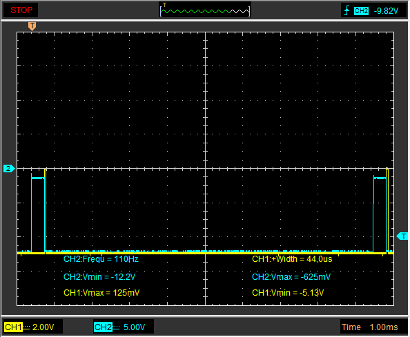

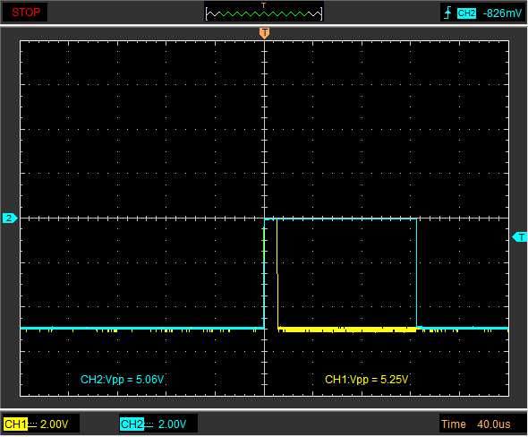

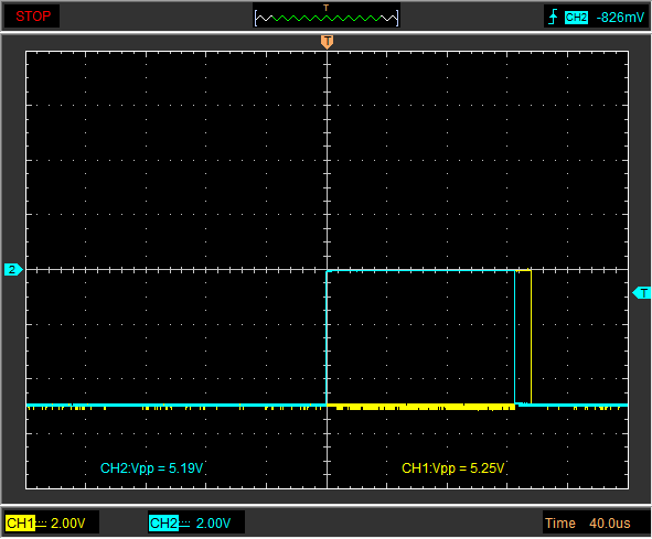

        • There it is all samples measurements !! to my mind all is right.
Name:	CH1(main sample delay) CH2(TX pulse).PNG
Name:	CH1(main sample) CH2(second sample delay).PNG
Name:	CH1(EFE sample) CH2(second sample delay).PNG
Name:	CH1(main sample delay) CH2(second sample delay).PNG
          • Originally posted by Albdelafar View Post
            [ATTACH]54729[/ATTACH]
            [ATTACH]54730[/ATTACH]
            [ATTACH]54727[/ATTACH]
            [ATTACH]54728[/ATTACH]
            Things mostly seem to be correct, except that the TX pulse width is only 44us, whereas the suggested pulse width in the Build Document is 400us.
            Your TX pulse rate is also slightly lower than the suggested 125pps.

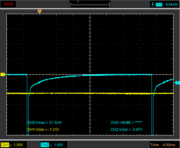

            Can you also post an image of the preamp output?
            Set CH1 = TX OSC (TP2)
            and CH2 = preamp output (TP3)

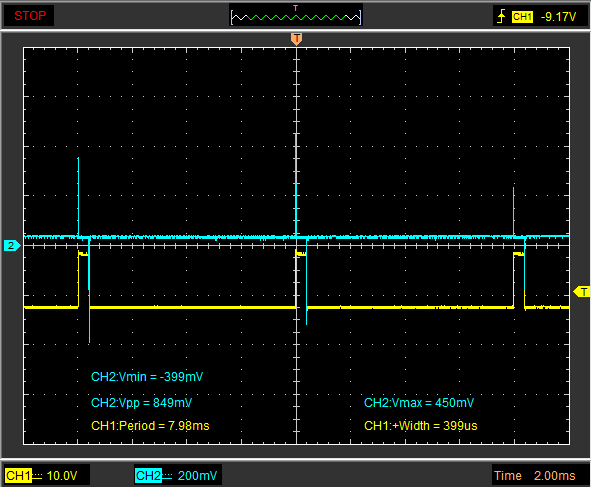

            • On the first screenshot I have the main sample delay (TP6) put to is maximum (44us) on CH1 and TX pulse (TP2) set to 340us on CH2.TX pulse period was set to 9ms.
              You can see here CH1 to TP2 and CH2 to TP3.
                From the image of your preamp output TP3, it does not seem like you have a coil attached.
                • Well analysed surfdetector yes it is. I disconected the coil to avoid a maximum of interf?rences. By the way my buzzer ring with or whithout coil when audio treshold is superior to -1.3V.

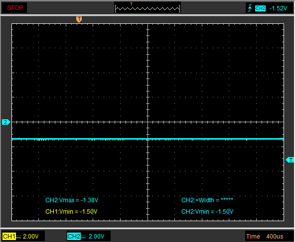

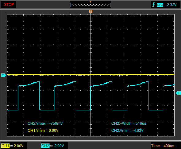

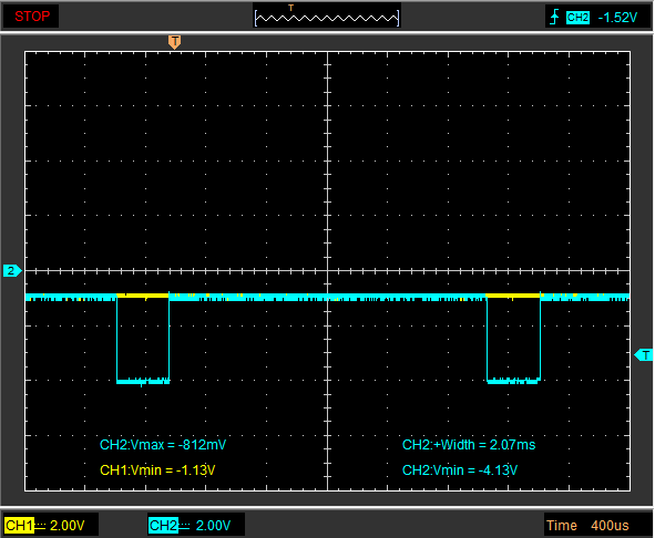

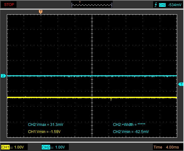

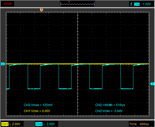

                      • I did somme measurements, without sound, with sound and with audio treshold set to 0V.
                        Looking on 2N3904 B
Name:	CH1(TP4) CH2(Q5 B)no sound (treshold 1.5v).PNG
Name:	CH1(TP4) CH2(Q5 B) buzzer ring (treshold -1.13v).PNG
Name:	CH1(TP4) CH2(Q5 B) buzzer ring (treshold 0v).PNG
                        and looking on NE555 out :
Name:	CH1(TP4) CH2(NE555 out pin3)no sound (treshold -1.6v).PNG
Name:	CH1(TP4) CH2(NE555 out pin3) buzzer ring (treshold -1.3v).PNG
Name:	CH1(TP4) CH2(NE555 out pin3) buzzer ring (treshold 0v).PNG
                        With that I suppose my issue is lockated between TP1 and NE555. Can anyone confirm this ?
