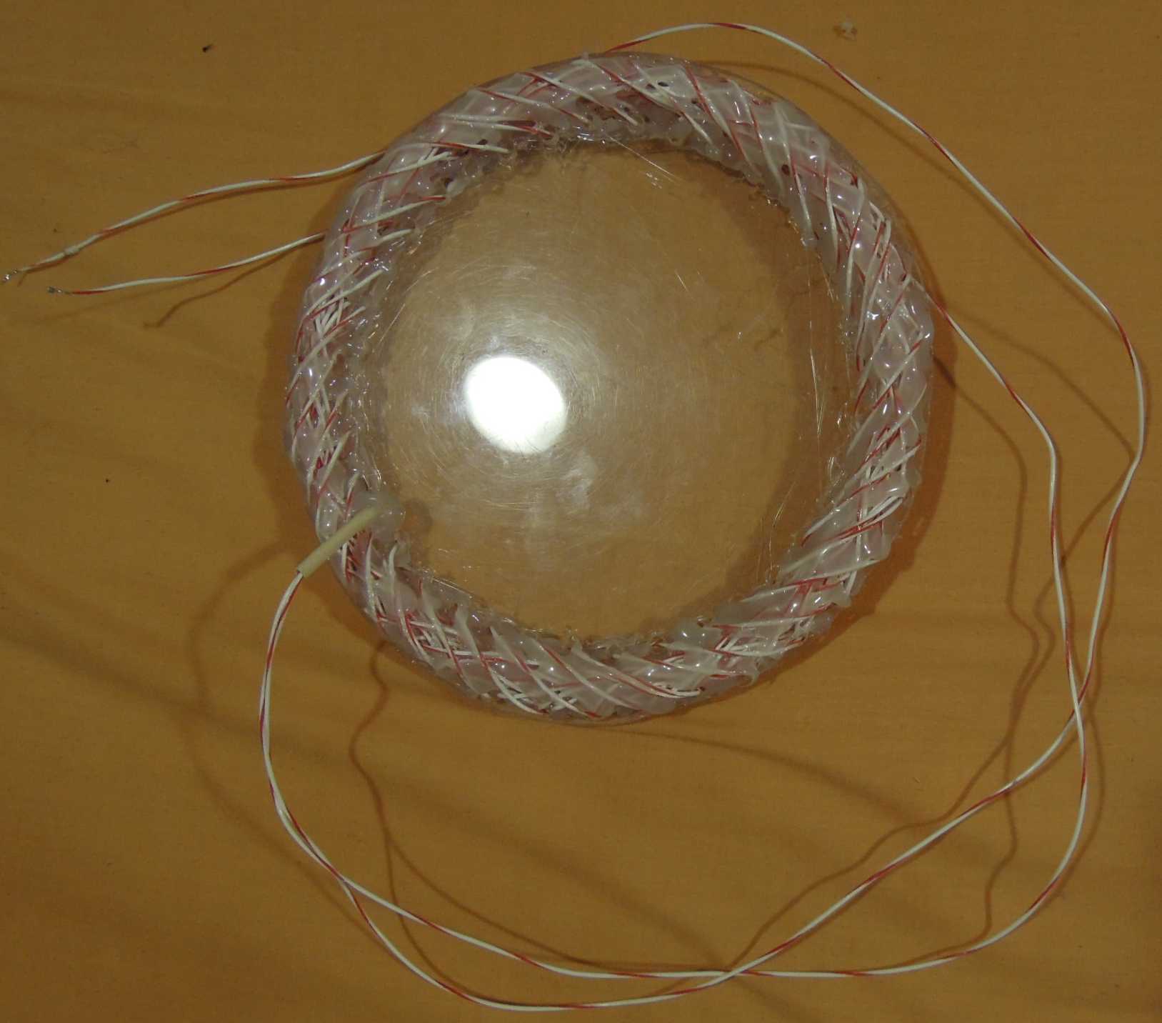

          Have you tried your woven coil? Been thinking of making one here but they just seem too hard to shield
          Not yet. Most probably on Monday. I populated the most of the board, but something else came up.
          The idea of a "spider basket" coil is to wind the hot end of a coil inside, and wind around and around towards the cold end and in effect the hot end becomes encapsulated in increasingly "colder" windings. That way the static-prone end becomes shielded in the very coil it is made of. Of course, I have no idea if it really works, and I made mine free-style, which means it is ugly-ish. It will serve its testing purpose.
          • I just ordered a PCB. Here's my BasketWeave Coil. It measures 320uh and 1.5 ohms.
            I'm hopeing it shields itself via the outer windings. I just drilled alternating holes approx.
            the size of 6 or 8 wires. If you look close I had to add an extra row as the wires take
            more space when wound. I don't have a working PI to try it on yet but soon.

                  • That's a great looking coil and looks like it could be shielded if needed by wrapping some spacer material and applying a shield over that.
                    It could well be ok as it is given that even just twisting two wires together creates a shielding effect.
                    • Originally posted by Silver Dollar View Post
                      [ATTACH]30887[/ATTACH]
                      What diameter did you make that coil and approx how many turns of wire? Any idea on what capacitance it turned out to be?
                      • the diameter is 7.5" or 19cm. How do you measure the capacitance?
                        • Ahh I see you need to find the resonant frequency and then
                          back calculate the capacitance. I don't have anything to do
                          that with at this time. Once I get a PI detector running I can
                          pulse the coil and see what frequency it rings at.

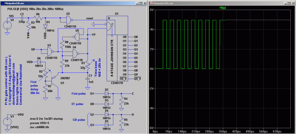

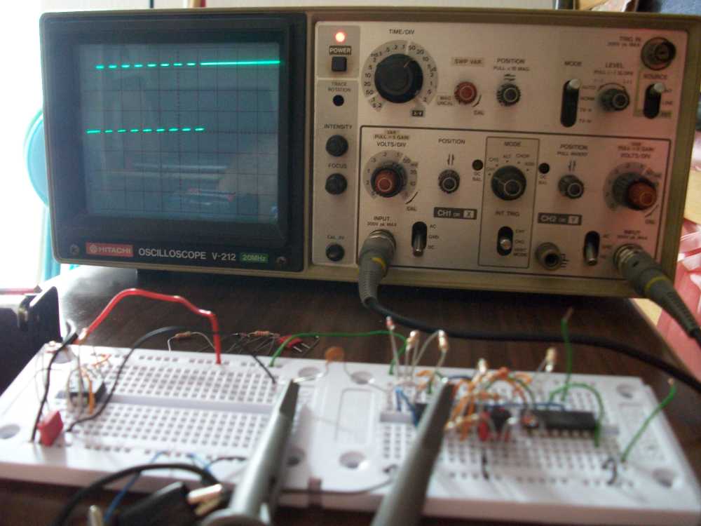

                          • GB circuit works!
                            GB circuit works! I made it on a protoboard together with a 555 generator to mimic real world timing, and I only skipped trimmers to avoid clutter - fixed values are OK for the proof-of-concept. Anyway, the timing works as it should. The next step is to place the components onto a perfboard and hook it to its proper places.
                            The attached files are as follows:
                            1. the corrected schematic using simple NAND CD4011 instead of a slightly unpredictable CD4093, and taking control over Schmitt trigger by means of simple resistors
                            2. CRO photo of a same thing in jpg format - obviously working as advertised
                            3. same thing, only as a zipped LTspice folder
                              GB circuit works!
                              Do you have this connected to a Minipulse Plus, or is it just standalone at the moment?
                              • It is completely disassembled at this moment. I'll put everything on a perfboard one of these days, but first I'll have to make a MPP work without it. It is populated (Ivconic style, but with IC sockets) and I have a coil, so it will be soon.
