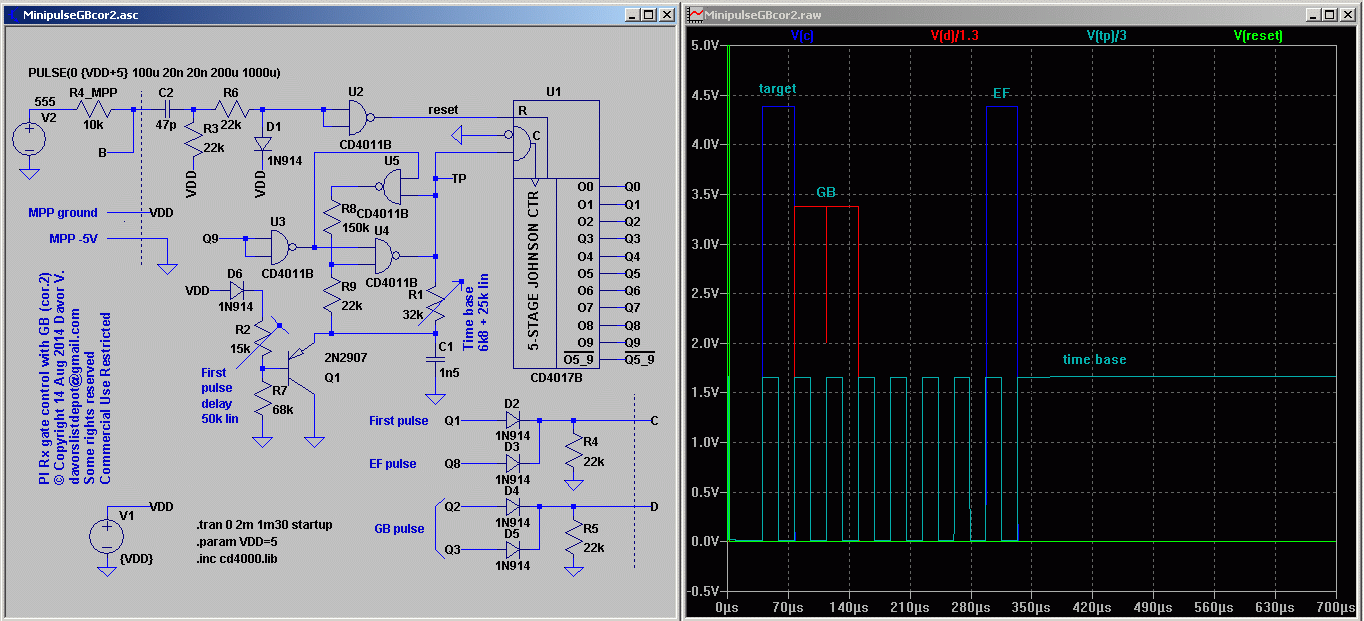

    GB circuit works! I made it on a protoboard together with a 555 generator to mimic real world timing, and I only skipped trimmers to avoid clutter - fixed values are OK for the proof-of-concept. Anyway, the timing works as it should. The next step is to place the components onto a perfboard and hook it to its proper places.
    The attached files are as follows:
    1. the corrected schematic using simple NAND CD4011 instead of a slightly unpredictable CD4093, and taking control over Schmitt trigger by means of simple resistors
    2. CRO photo of a same thing in jpg format - obviously working as advertised
    3. same thing, only as a zipped LTspice folder

                • Great work! Do you have a plain circuit diagram for the GB mod? and were it connects to the existing circuit? In my day we just used spice on the roast chicken lol.
                        I already placed labels C and D on the diagram to follow on the MPP logic. Here is the latest, only slightly modified circuit to facilitate using MC14538 sockets for a simple plug-in solution. Border between MPP and a add-on board is a dashed grey line. So the idea is to pull MC14538-s out, and plug the add-on board in. Connections B, C, D, -5V, and GND are taken from the MC14538 sockets, exactly where they are already.
                        There will be 2 potentiometers, one for time base (same function as "reject"), and another for GB. The MPP "reject" potentiometer loses its function and becomes replaced with time base (sample duration) potentiometer.
                        "First pulse delay" is a GB potentiometer. Because this delay is set to be relative to the sample duration, the GB solution position on a potentiometer is largely independent from sample duration. Hence you may shift sample duration left, right and sideways, and your GB setting will remain virtually the same. This gives me some nasty ideas on elimination of the hole ... later on.
                        • Excellent work! The GB mod is going to make this detector really nice.
                          • I certainly hope so. The other PI projects can benefit from this approach as well, but I'll have to see where to put what to make them tick.
