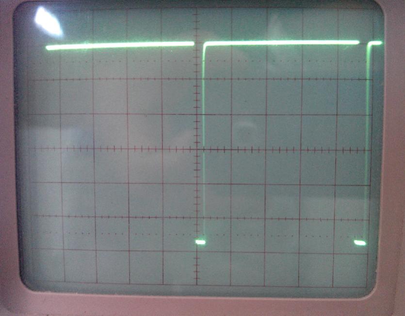

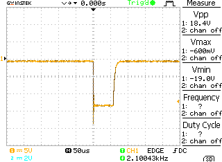

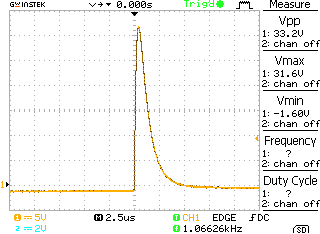

    With connection of scope on TP3, the image is identical to the one I posted earlier - although there is more deflection when my mini side-cutters are presented.
    Here's what the waveform should look like when measured across the damping resistor (R1).
    Note how the decay happens over a period of about 5us (even with the original [slow] Minipulse coil). Note the use of a x10 probe. The flyback voltage is measured as 316V.
    • I cant get an image like that. What could be wrong ?

        • Originally posted by greylourie View Post
          The problem definitely appears to be associated with the coil.
          BUT - just to be certain, let's do a simple experiment to test if the circuit is working ok.

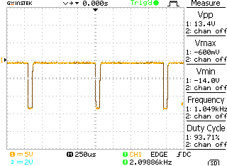

          Disconnect the coil, and replace it with a 10nF capacitor. Connect your scope across the damping resistor (R1) as before, and look at the waveform. Set your scope probe to x1, as the flyback will not be present.
          Here's the result:
          • Hi Mick, thanks for the tip. A continuous length probably my best bet. I only have about 1.2 m of cat 5 left - don't want to be joining lengths up. Will go see what the local hardware store has.
            Those images I posted in #255, are bothering me. I can't get the earlier part to display - like in Qiaozhis image. I am failing to get the scope to display the on-period and then where switch-off occurs.
              RE the CRO, connect a second CRO lead to the output of the 555 then set trigger source to CH2, then the full waveform should show up.
              • With 10nF cap on in place of coil, i get the following image. Approximately 11.5Volts.

                  Hi mick, all these knobs are doing my head in. I have a port for connecting an external trigger, haven't learnt how to use it yet. When I try running both channels at the same time, I find I don't have enough space on screen to display all information.
                  When I mentioned my images in #255 - not looking like the one posted by Qiaozhi, I meant mine does not show all the signal (TX off and start of flyback) when scope connected across R1. All I can see in my images is what looks like the pinnacle of flyback, and the drop back down, and the small oscillations on the tail. Counting squares get 275V, but that is only what is shown on the drop down, and I cant count from start and use as a proper baseline because it does not show.
                    That looks good to me.
                    Conclusion: your coil is the problem.
                    I would suggest that you go to your local electronics/electrical store and get a small reel of hookup wire. Then wind 20 turns on a 10" diameter former, leaving the tails long enough (about 12") so that you can connect it to the PCB. Simply wrap the wound coil with electrical tape, and don't bother about shielding. Also, do not twist the wires that connect to the PCB, and make sure you keep the coil away from any large metal objects.
                    • Thanks Qiaozhi. Will do.
