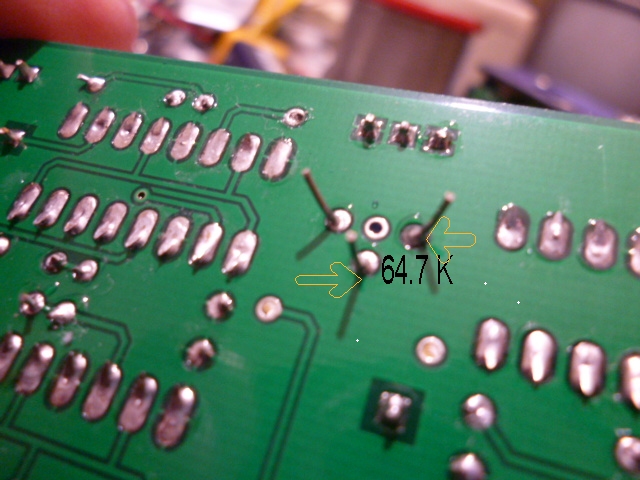

                        • Here is a little construction tip for those building the kit.
                          In step 6 to initially setup R6 100k for a delay of 22uS you need a CRO
                          however if you dont have a CRO then try this.
                          Before you install R6, first adjust the pot so its approx 50k between middle and outside pins
                          after you solder it leave the legs long.
                          Remove any power, and do not connect anything to PL3 .
                          Now useing a good multimeter adjust R6 so it reads about 64.7 K between the middle
                          and right hand legs of the pot, this should, if all things are correct, get you close to 22uS.
                            Also (as described in the Build Document) you can go ahead and complete Step 7, and then adjust R6 to give a DC level of around 500mV at TP4.
                            However, 6666's method will provide a more accurate setting.

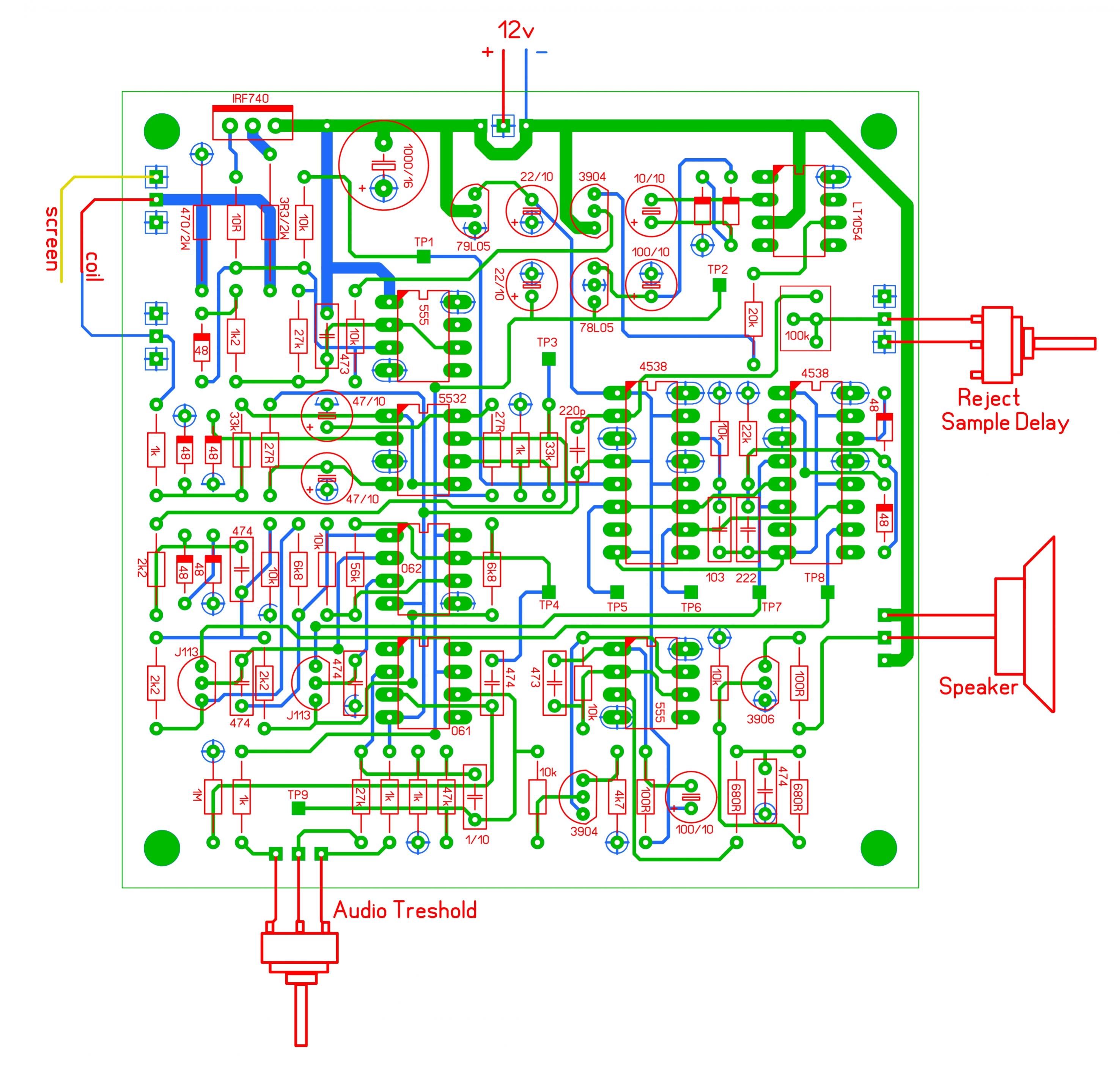

                              • If it was not done in Sprint Layout; it does not exist for me!
                                Nobody else did it; so i had to do it, again!
                                Recently i had to switch on Sprint Layout 6, so this was good exercise for me.
                                Personally i don't like the chosen size and spacing for 470nF capacitors... but that's just me!
