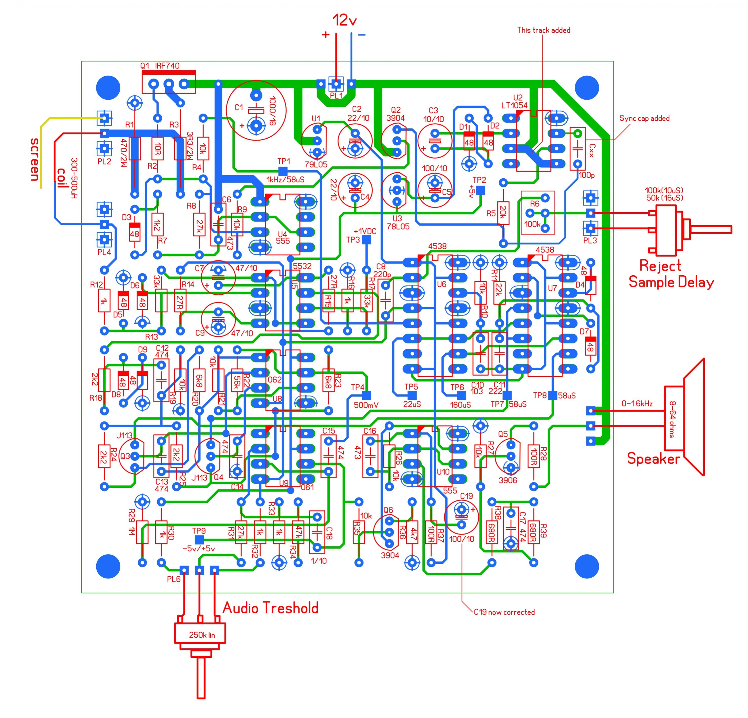

      Thanks Ivica,
      I've added your files to the Minipulse REV-B thread for use by other Sprint Layout users.
      Please have a look at the REV-C PCB. This contains 2 minor fixes (see MiniPulse REV-C thread) and the addition of TP10 for connecting a ground probe. If you make these changes to your Sprint Layout file, I will add that to the REV-C thread as well.

                Thanks Ivica,
                • SL files look nice
                    SL files look nice
                    Makes my life much easier in process when putting components on pcb.
                    I use to print such picture on paper and than work is much easier.
                    Would be even better if i had color laser printer, by now i have only b/w laser.
