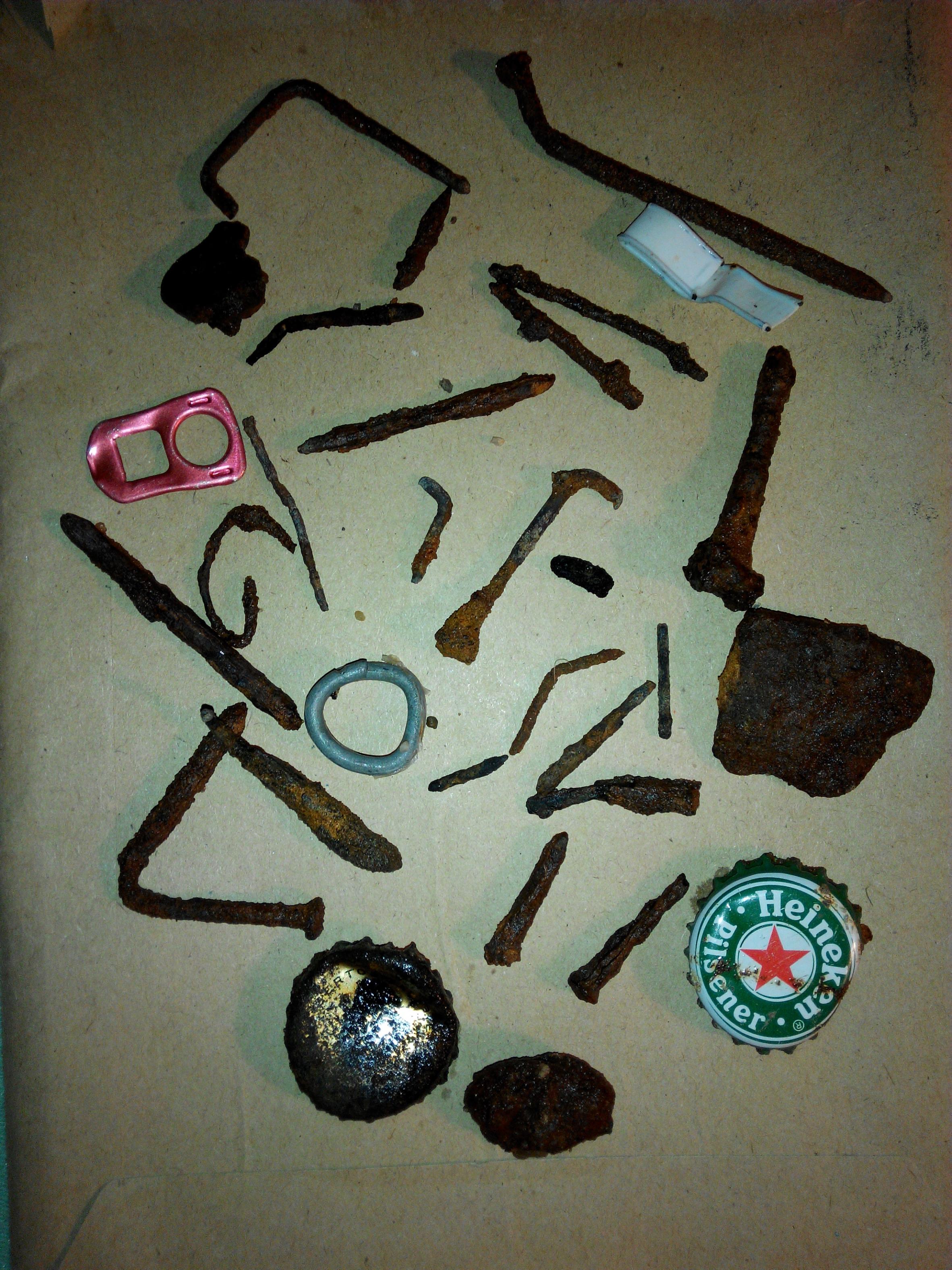

    • @josewashere: I have taken the detector out into the field. No problems as you have described, both on sandy soil and grass....
      Boy, is this detector sensitive to iron! Been at a sweetwater lake where people go for a swim and spend one hour in the sand. Here's a finds picture: Click image for larger version
      Have not played with the delay setting or reject knob yet.

      • Originally posted by joop View Post
        That's why PIs are good on the beach (salt water rejection) but rubbish in a ploughed field (unless you're a relic hunter).

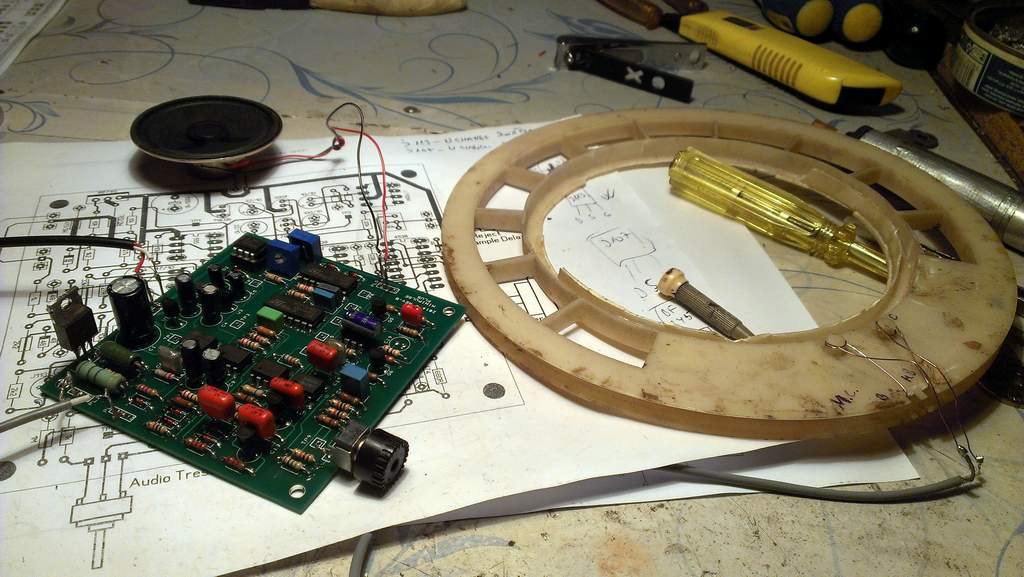

            • I just finished my copy of MPP.
              Switched it ON and it is working... awfully !
              It is acting opposite; when i close up any metal to coil : audio fades !?
              Audio is chatty and dirty, lot of "weh-wah".
              Coil is 300uH.
              Voltages are alright.
              I tried to adjust Reject Sample Delay with trimmer and pot, all possible positions, no good results.
              All components are checked and good.
              I only haven't put brand new J113 there, had 2 old from a scrap and used them.
              But those seems to be alright too.
              I haven't exactly followed whole this topic and read all the posts, is there any already posted video with good working MPP?
              Anybody made video? Anybody posted it?

                      "...I suspect you've been a bad boy and populated the whole board before testing..."
                      But of course i did... you know me!
                      Give me a break George! It has nothing to do with fact that i did it unlike you suggested!
                      (manuals are for woosies - not for tough guys like i am!)
                      I just founded what was the problem!
                      Arghhhhhhh!
                      I haven't connected coil properly! Can you believe it!?
                      You and your "dozen" pins for coil on pcb!!!
                      Actually; coil was connected between tx and rx pins only! Arghhhhhhhhhh!
                      It's your guilt! You and your 2x3 pins!
                      Ok, but before i realized that coil was not connected properly; i suspected those poor J113, so i destroyed them both when tried to remove them from pcb.
                      Now i don't have J113 no more...
                      But i do have my beloved J107 ! Ha!
                      So; J107's are on their places, coil is connected properly...and it is working now!
                      After half hour playing with it i collected some conclusions:
                      1) 8 ohm speaker sucks, 100 ohms speaker RULEZ!
                      2) Automatic Treshold is not making me very happy, i would like to have option to choose between. I prefer nonmotion mode.
                      3) Was it just me or i do hear significant audio amplitude decrease when detection signal increasing? I don't like that. I expect audio amplitude to increase too.
                      Ok enough for now. I recordered very short video focusing only on audio behavior.
                      Right now i will upload it on Youtube and later share here.
                      Cheers!
                              On the REV-B board there was a connection missing between U2 pin 5 and U2 Pin 3. This caused the audio volume to decrease when a large target was close to the coil. I'm not sure whether I'm hearing the same thing in your video, but since you're using a 7660 this may not be useful information.
                              There should be a small increase in amplitude, as well as a large increase in frequency, as the target gets closer to the coil.
