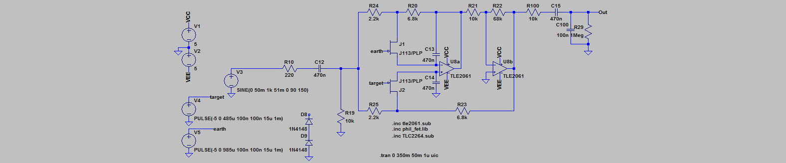

  • Been getting a brain cramp trying to figure frequency response and gain for the integrator. Tried building it in spice. Changing sample time changed frequency response and gain. Don't know if I did it right. Could someone give the formula for gain and frequency response for the integrator.

            Thanks, but I think this integrator is different. It acts different in spice. Maybe I'm missing something. What is the gain and frequency response formula?
                    Gain is R23/R25, LP cutoff is 1/( 2×3.1416×R20×C13 ), band stop is 1/( 2×3.1416×R24×C13 ).

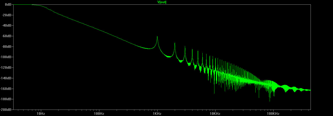

                          This of course is modified by the sample width and the filtering of the input and output circuits. My Minipulse Plus implementation with 15 usec samples and additional filtering of the output (a 10k in series ahead of C15 and 100n in parallel with R29 ) results in an effective gain of ~1.75 and a 6 dB cutoff of 11.5 Hz. I determined the effective bandwidth by using the FFT function of the simulated output.

                                ... I determined the effective bandwidth by using the FFT function of the simulated output.
                                There is a much more effective way of establishing the bandwidth and its nature in time domain. What you need is a step stimulus that you already have in a form of Ncycles in a sinus voltage source, and you observe the output. It most certainly lags against the stimulus, but the slope and its curvature say a lot. You'll notice that there is a slew rate limited slope, and not a classic LPF slope. It means this integrator will follow input stimulus very accurately, and will not flutter unless screwed up completely.
                                You can estimate inverse corner frequency (1/f for -3dB point) as 3 x rise time to 85% or 3 x fall time to 15%. You don't have to be extremely accurate on this.
                                More importantly, you'll notice that this integrator provides more of a constant slope, rather than an exponential one, which indicates a slew rate constraint.
                                In practice it means that you'll be able to miss some targets if you swing your coil as a lumberjack, but it will still be much faster to respond than a normal LPF response detector, and even more so than the one with overshooting problem.
