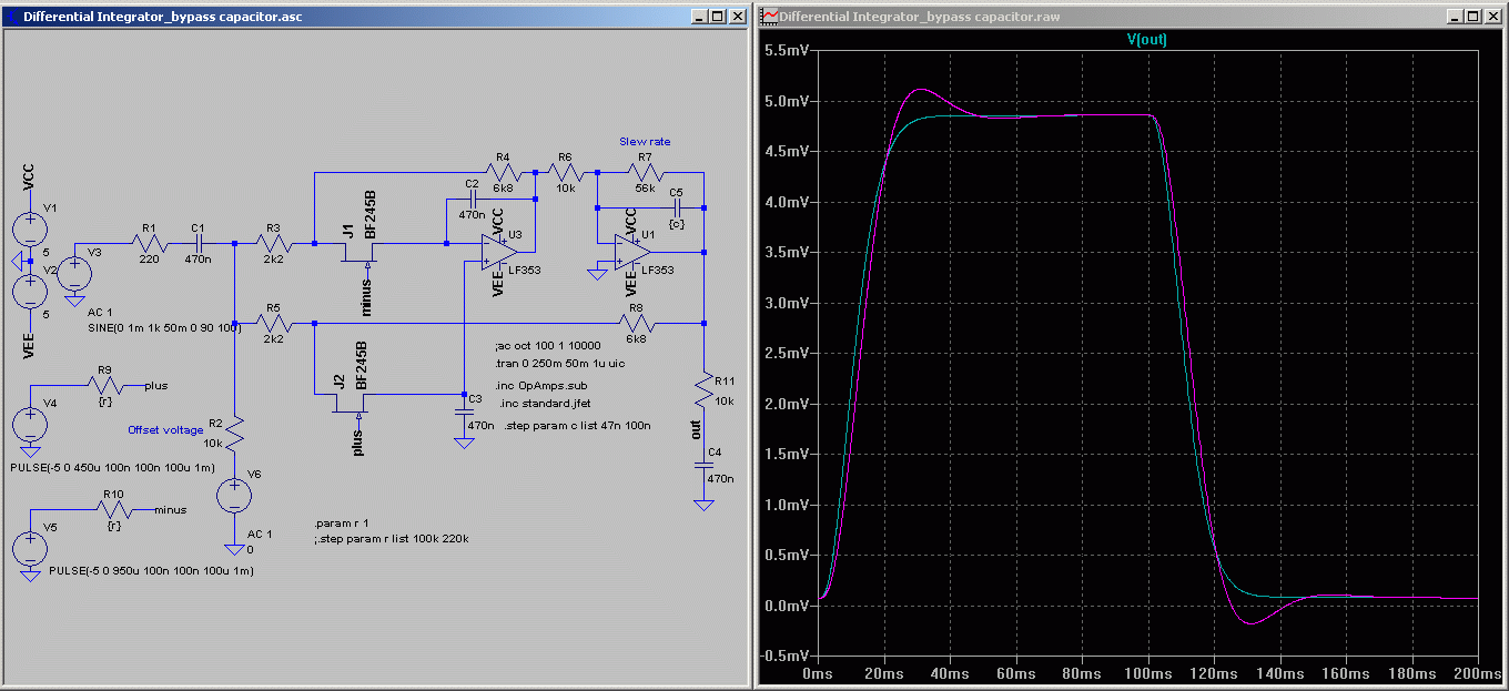

          • 100n in parallel with R22 destroys otherwise perfect impulse response to the targets, so it is not the kind of mod we want. What happens is that integrator response overshoots, so it results in masking of small targets in vicinity of a large one.
                I think "destroys" may be a little strong. But yes it does change the response of the integrator. I noticed this impulse response while testing/learning GS4 circuitry (Eric Foster incorprated this into the GS4). Although the impulse response is somewhat changed, it tends to improve the bandpass charactaristics... at least I like the result. Everything in the real world is a trade-off... there is no achieving the ideal... and every idea of the desired is relative to the one that desires.
                    Well, I checked what can be done with this as I abandoned the idea after seeing what it does with 100n and I simply did not try tuning the capacitor. But apparently yes, it can perform, only not with 100n. With 47n it behaves OK, but with 100n it seriously overshoots. See for yourself, the pink trace is 100n, while the bluish one is 47n.

                      To slightly reduce the "chattiness" and injection noise from the switches, try putting a 100n in parallel with R22. The longer sample widths made sense with the original higher inductance coil. But with the faster coils in the 300 uh range, earlier effective samplinding g (the sample/hold circuits will tend to integrate to the signal level at the end of the sample period) can be realized.
                      The GS4 has a 100nF cap fitted in that position, and I've been meaning to try this mod. However, now I've made the change, I couldn't honestly say that there was any noticeable improvement. Without the cap, the cutoff frequency is limited by the GBW of the opamp, but with the 100nF cap Fc = 28.4Hz. However, there was a small reduction in "chattiness" by using a 1uF cap, which reduces Fc to 2.8Hz. The mod did not affect the recovery speed of the detector.

                            I did try the 47nf cap across R22 and it didn't do anything for my detectors chattiness. 1 uF does settle it a bit but for now I just left it out. Still considering the 5k pot in place of R33.
