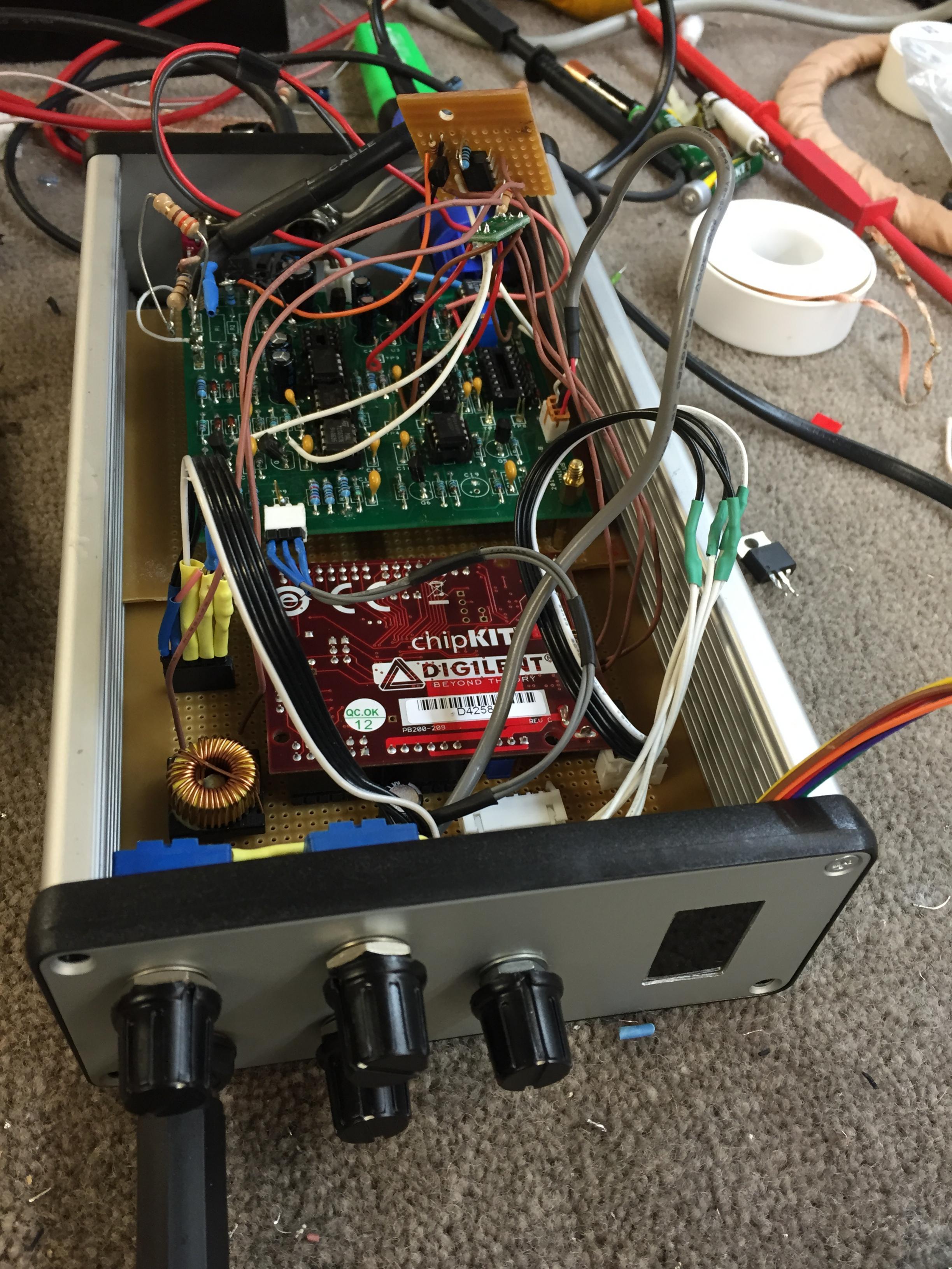

            • Here is a photo of my latest experiments with MPP all in a case ready to take into the field for testing.
              Has a rotary encoder to select different timing / sample experiments as well as small OLED to display various settings. I have set the case up so that I have options for the future.

              • Nice. Can you measure how much juice goes to chipkit?
                • Nice thanks for showing us Cas

                    Hi CAS
                    Nice job. Let us know how well it works. I have a MPP and a ChipKit and would like to do a similar experiment. Did you program it with the MPIDE or the MPLAB IDE software? So far I have got an OLED programmed and working but haven't started on the pulses and sampling.

                      A am just using the MPIDE. Its quick and easy. Adapting the Chipkit is pretty simple. I use a high speed isolator to control the sample gates and a high speed opto (due to the voltage gnd issues) to supply the pulses to the TX Fet and charge pump sync.
                      I was experimenting this afternoon and found that using the timings based on the ratios Davor gave me, along with alternating main sample widths, I was able to increase the audio threshold a little and gain about 15 mm extra depth in air on my small 5mm x 5 mm aluminum test sample.
