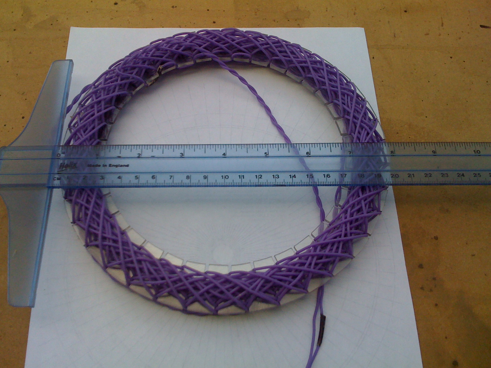

        • OK, I've build yet another 8" round SSBW (self-shielding basketweave) coil and I'm going to stick with it as I'm finally happy with the coil - I finally got it as tight as I wanted - to improve the magnetic field's strength, quality, and consistency. It uses exactly the same length of wire as the last one so has the same resistance, just wound tighter, and gave me a wonderful 20% increase in inductance (& presumably magnetic field strength) - without sacrificing even 1uS in speed, very nice. Previous coil was 300uH.
          Here are it's spec's:
          7 basketweave turns
          360 uH
          3.0 ohms (due to the small gauge 26AWG wire)
          2455 ohms critical damping
          Flyback spike recovered at 4uS after end of TX pulse - by monitoring the coil, and also at TP3.
          Flyback spike now at 500 volts due to the fast coil & I'm getting a bit worried I'll fry the mosfet, anyone have suggestions on a good higher voltage replacement? 800 volts would be nice...
          Also since this coil has has relatively high resistance & about the same ohms as current limiting R3 (3.3 ohms) I removed & jumpered R3.
          This coil should be very good for trying out the timings I'm going to experiment with. I am almost done putting the MPP on a pole setup, so more soon...

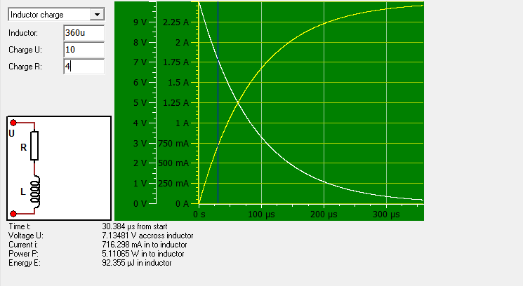

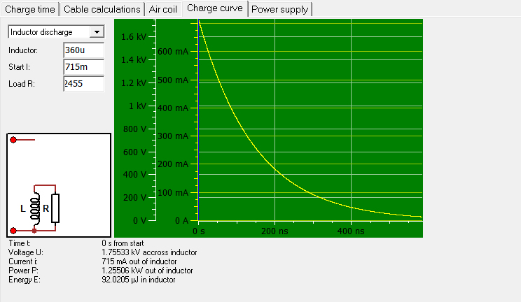

                  • Charge and Discharge.
                    What limits the flyback to 500 volts. Is it the mosfet diode ? Or mosfet breakdown ? If I try to use Miscel to see the inductor charge at 30µseconds, and then plug the figures into see the inductor discharge curve... it shows the initial spike in the 1.7kV range. And if I use figures from a 60µsecond On time, the initial turn off spike is sitting on just over 3kV.
ID:	343366Click image for larger version

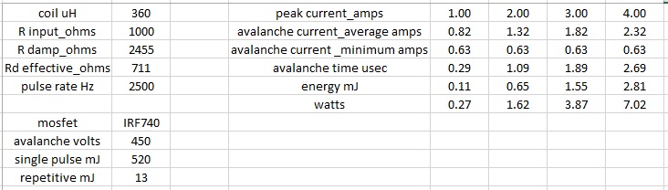

                    • In general, it is not a good idea to let the MOSFET go into avalanche mode. This causes the junction temperature to increase, and can cause premature failure of the device. Some [rugged] MOSFETS have an avalanche rating in the datasheet, but you need to be careful of this rating, as its meaning is dependent on how the manufacturer performed the avalanche tests.
                      Here's a detailed explanation -> http://www.vishay.com/docs/90160/an1005.pdf

                        Four questions on the coil.
                        What is the voltage rating of the PTFE wire insulation?
                        What is the Self Resonant Frequency of the coil?
                        Is 7 Basketweave turns the same as 35 turns around the coil form?
                        What is the width of the coil form?
                        Thanks,
                        Dan
                          Thanks for the explanation. I did a spreadsheet and included some IRF740 avalanche specs. Using KR's coil specs and 1 amp peak current the avalanche energy is less than 1% of the IRF740 repetitive value. I'm not suggesting operating the mosfet in avalanche. Just trying to determine at what energy level there might be a heat problem. With 1 amp peak current KR would need a snubber or a 800 volt mosfet to not avalanche. Would .110 mJ, cause the mosfet to over heat? Without a snubber, the mosfet avalanches at about 450 volts with all of my coils. Seems like any critically damped fast coil is going to exceed 450 volts on turn off with 1 amp or higher peak current. Does a snubber circuit have to dissipate the same amount of energy?
                          • [ Does a snubber circuit have to dissipate the same amount of energy?]
                            After thinking about it I think the energy has to be dissipated somewhere. R input, R damping, mosfet avalanche or a snubber. Another question, The amplifiers I've been using and the NE5532 have a pair of back to back diodes across the inputs. The spec sheet says to limit the current thru the diodes to 10ma. The MPP has the + input to common so the diodes are in parallel with the two 1N4148 from the - input to common. With 450 volts across the input resistor, 450ma has to go somewhere. With a 800 volt mosfet 800ma has to go somewhere. Is that a problem or is the time so short that it doesn't matter?

                              Haha, thx green, I believe it was I who was looking at it wrong - a late night post & I forgot to consider (if I'm correct on this) that the MUR460 diode was isolating the flyback spike from the mosfet. I think the mosfet will be fine as it's got life pretty easy.
                                In general, it is not a good idea to let the MOSFET go into avalanche mode. This causes the junction temperature to increase, and can cause premature failure of the device. Some [rugged] MOSFETS have an avalanche rating in the datasheet, but you need to be careful of this rating, as its meaning is dependent on how the manufacturer performed the avalanche tests.Here's a detailed explanation -> http://www.vishay.com/docs/90160/an1005.pdf
                                Thx Qiaozhi, good information to keep in mind.
