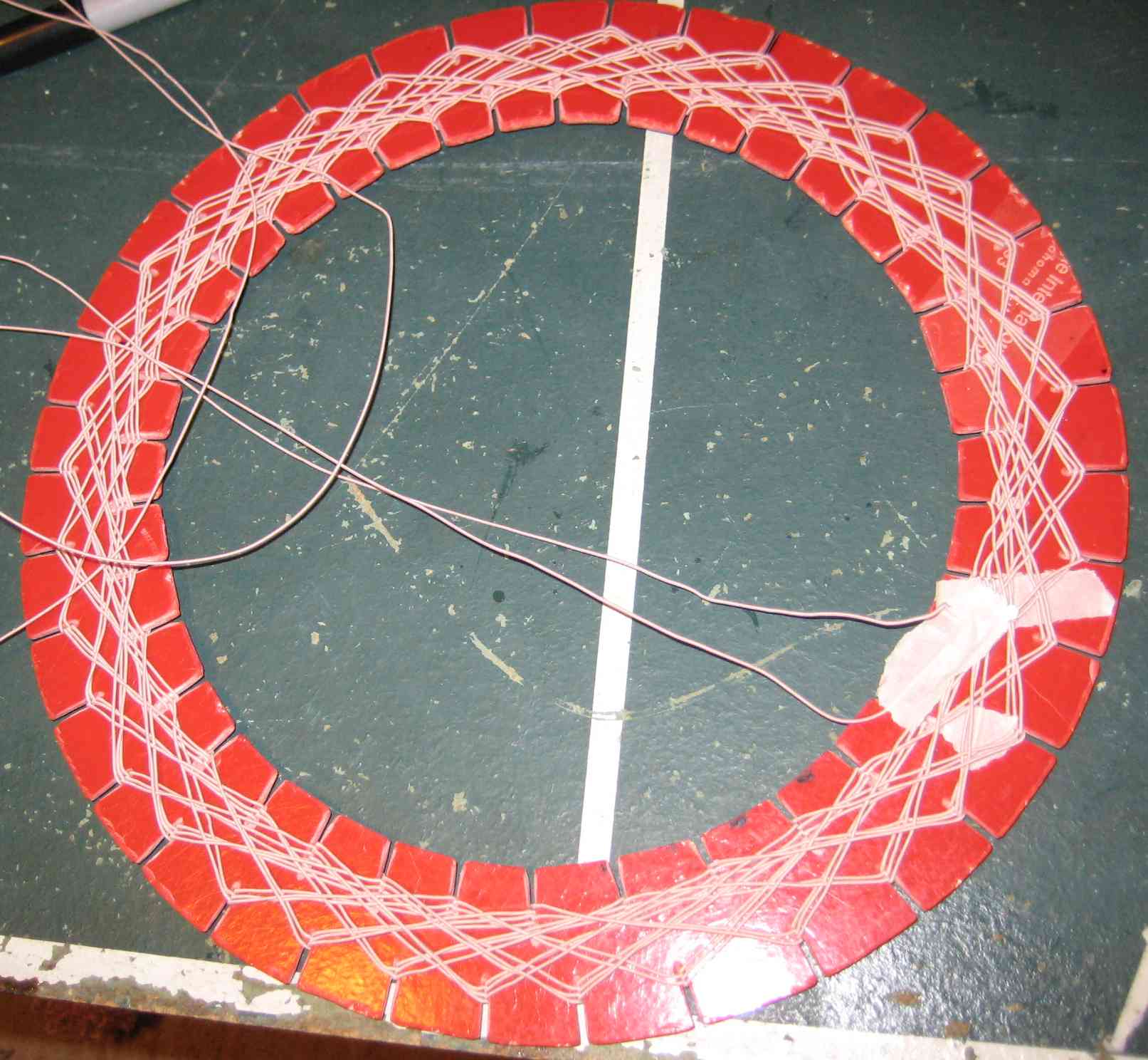

                            I have updated the basket weave coil templates for the increase in the inner wire slot depths from .4" to .55" to balance the wire anchoring in the slots. I have also added a version number to the templates in the lower right corner so you can know if you have the latest. The latest 8"x10" elliptical is v5, the latest 8" round is v2.
                            8 inch Coil Form v2.pdf
                            8" Round v2
                            8x10 Coil Form v5.pdf
                            8"x10" Ellipse v5
                            These are intended to be used with 32 turns (6 layers + 2 turns) (or less) of wire with OD up to 1.5mm, yielding about 324uH and around 3 ohms at 32 turns, depending on the wire you use. Smaller OD wire will allow even more turns and higher inductance.
                            As always, let me know if you discover any issues with these templates, and enjoy!
