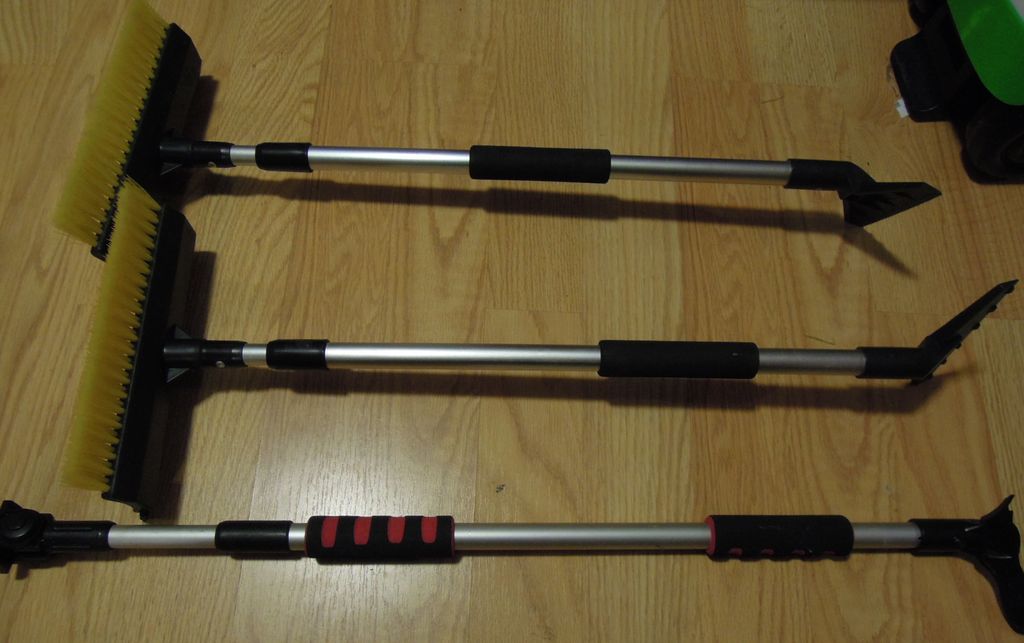

                    OK, so now it's time to figure how to put it together into something I can use in the field - needs a box to hold the electronics, a pole system to connect the search coil, arm rests, etc. Curious what others have used to complete their project...
                    I picked up a Whites Classic ID for not much - thought I could remove the electronics and use it for this project - but I made the mistake of trying it out in the field and found it to be quite a nice treasure hunter, I really like it - so now I don't want to make it a donor...but something like that seems like it would work well...

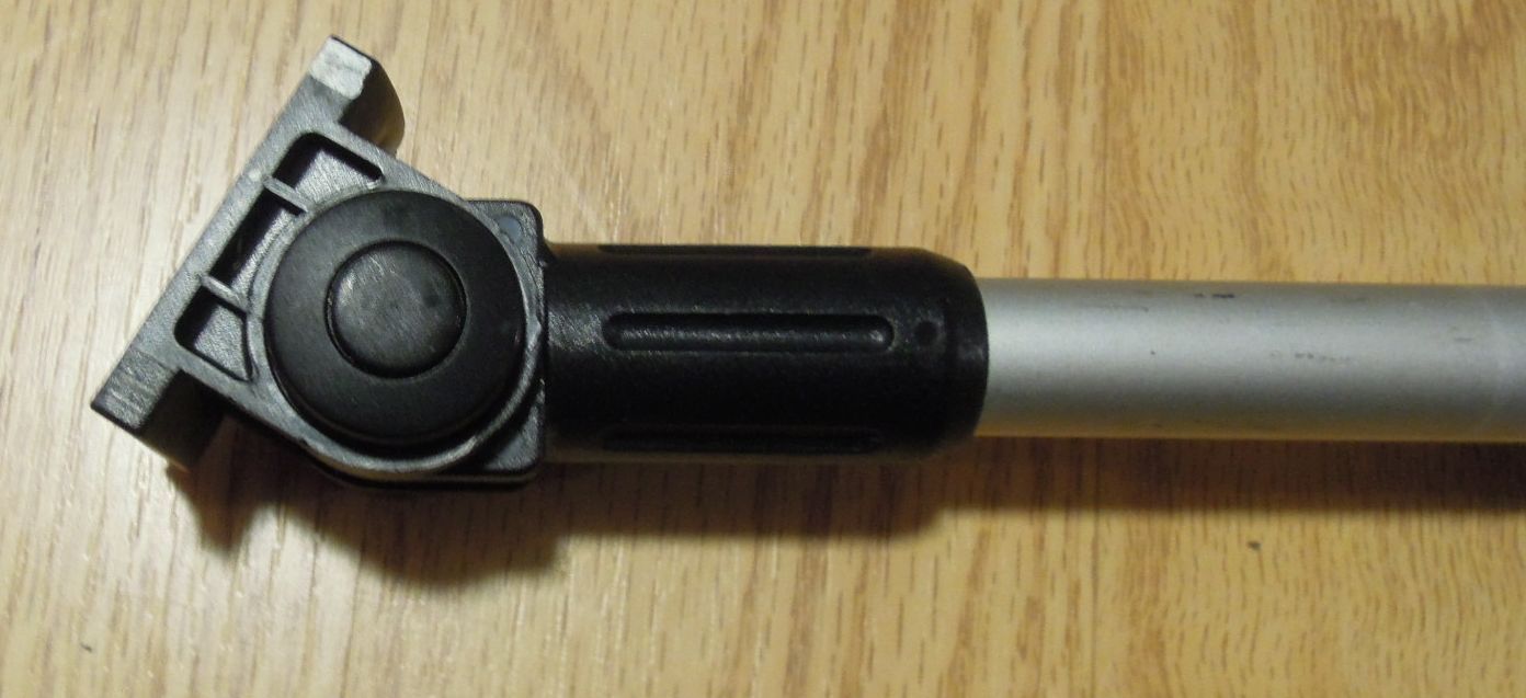

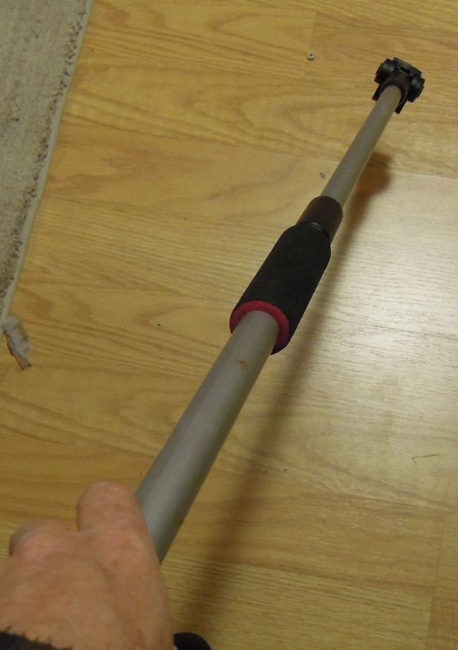

                          • You could use an ice scraper as a stick;

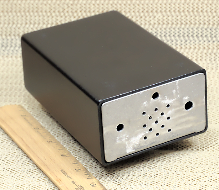

                              • I bought some GMT housings. They were about $25 each;
