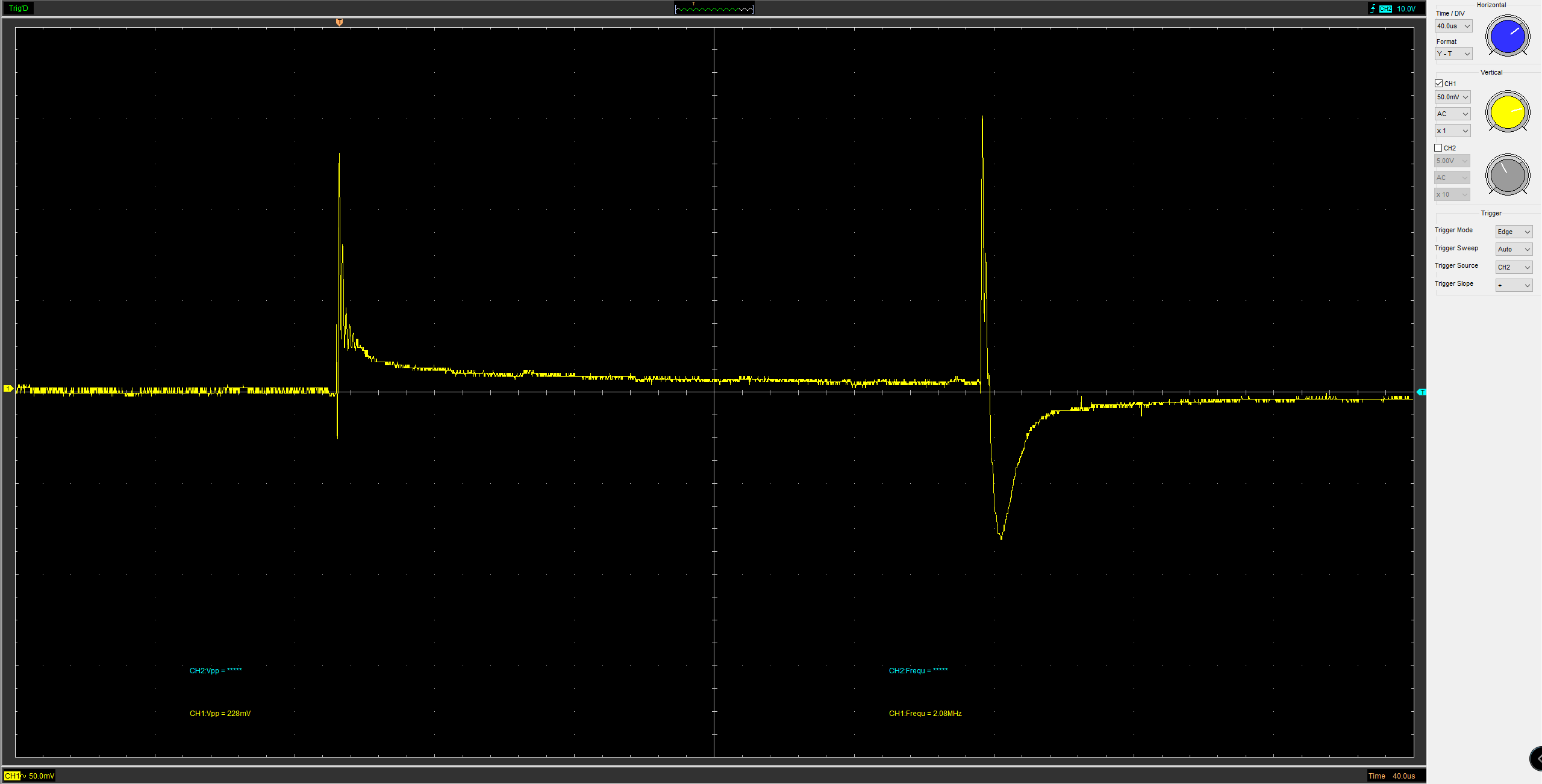

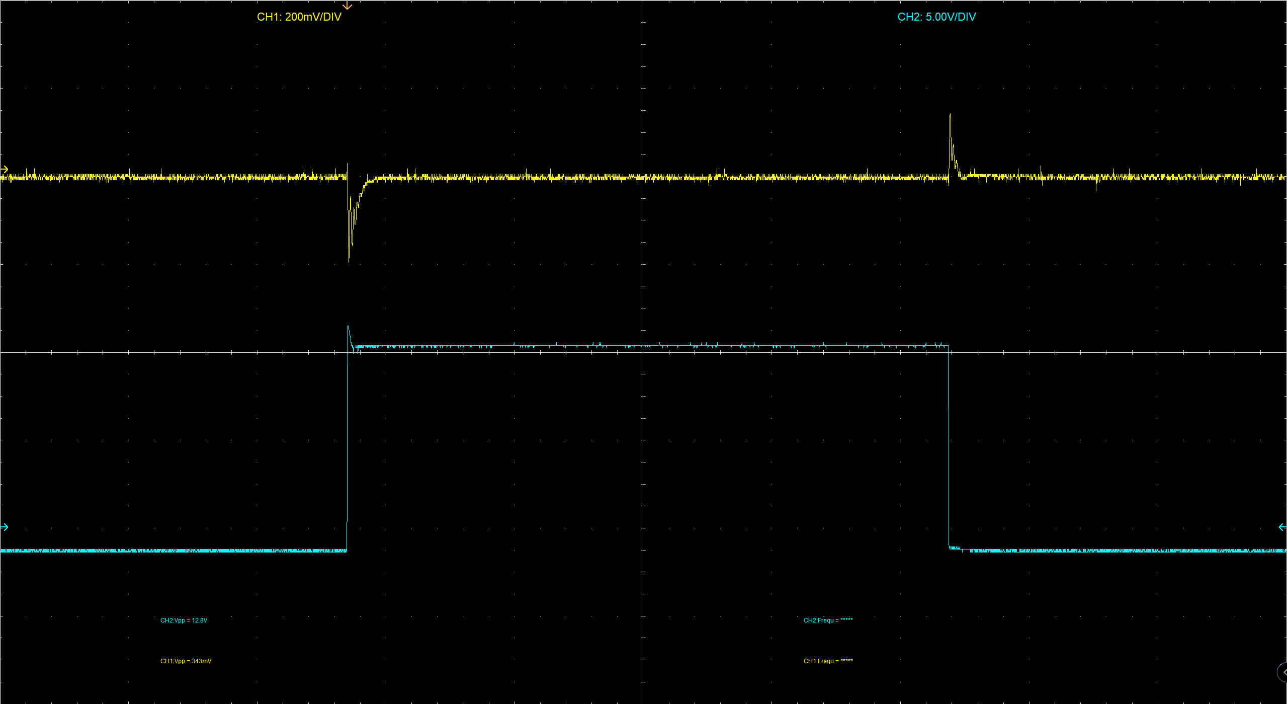

                          For my MPP rev-E i'm still waiting for my 2W resistors but i received my new oscope and somme other stuff.
                          I build the dampin resistor tool but i wait my 100X probe to test it I fear to burn my new oscope if I fail the voltage divider (I have only 1/4 w chinese resistors I am not confident with that).
                          I change all my connection pin and I solder RX and TX pin. I use the damping tool at 700ohm to replace the damping resistor.
                          I changed my pulse to 500hz with a pulse width of 200us and a pulse periode of 2ms but now i have my signal in tp3 like that :
                          CH1 TP3
                          CH2 TP2
ID:	357207Click image for larger version
                          What's going wrong for you ? Thanks

                            The time/Div on your scope is set to 400us. Looks like your TX pulse is ~1000us
                            Why don't you look at TP3 with a lower time/div? that way you can see what it looks like.
                            Cheers

                              Hi surfdetector in the first pick the timings are set up to 40 us by division. I forgot to mention it.

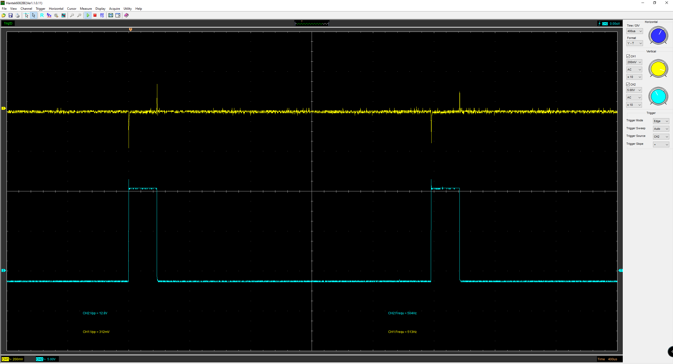

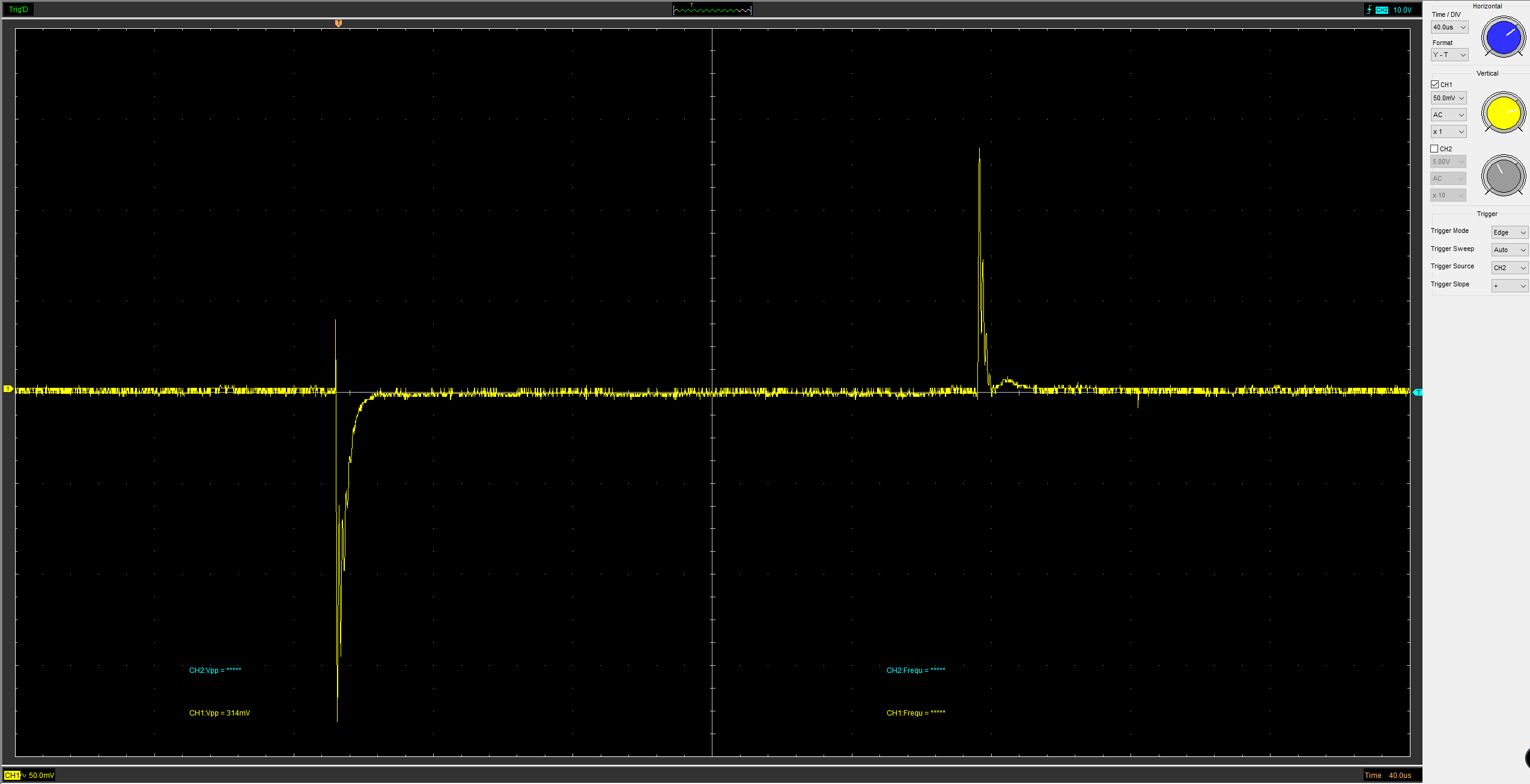

                                I did a test with another concentric coil and result is the same :'(
                                But I see an improvement when i touch the heatsink of IRF840.....
                                Could someone help me please to find the issue
                                Alban

                                EDIT: i have no signal on TX pin.... i will investigate on this side.
