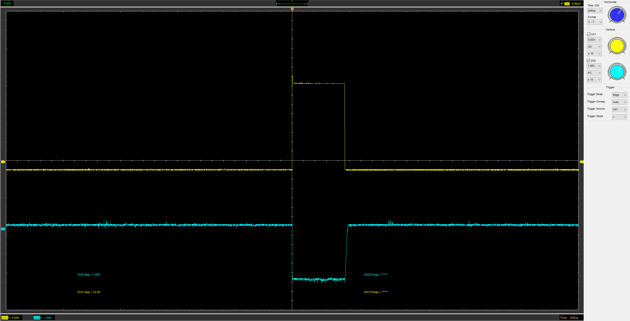

          Thanks you dbanner for the information i learned something. Do an isolant tape can do the job if the IRF840 don't heat to much or a mica foil is necessary ?
          For my problem i did a new measurement and i found my tx signal at my coil plug is good as you can see :
          CH1 is at TP2 after NE555 and CH2 is on my coil plug after my coaxcial cable.
Name:	CH1 TP2 CH2 TX at coil connector.PNG

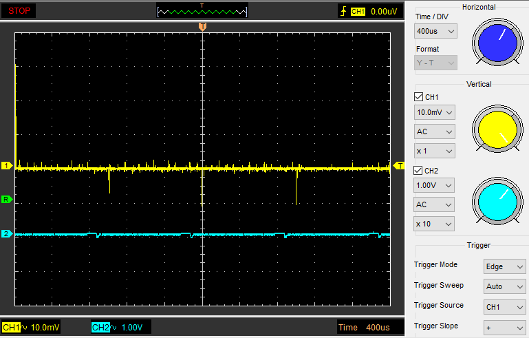

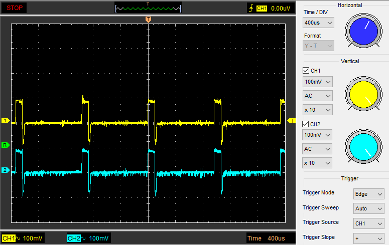

          But when i try to read signal at TP3 i see no differences with or whithout my coil plugged in. Do you think my NE5532 can be the problem ?
          • #50
            Try probing before the NE5532 at R1 and then also at R8 what do your waves forms look like?

                Hi surfdetector I tryed to measure signal to R1 and that was a good idea because i had no signal.....
                Only noise I think because i measured a very litle signal who was the same with or without the coil pluged in. So I checked again my two coil and all seems right so I thought to measure the resistance between RX pin and R1 and bingo it was infini. I probably broke something when i changed all the connection pins .
                I will try to correct that tomorrow and I hope that will resolve my problem.

                  Hello,
                  So this step is good with the shunt between TX and R1 I think the tx pad was damaged when I changed the pin. What ever now my TP3 signal is good noisy but looks like normal !!

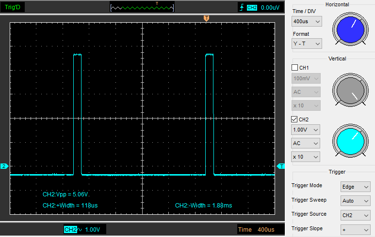

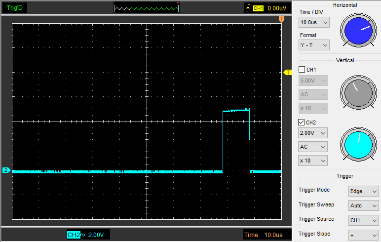

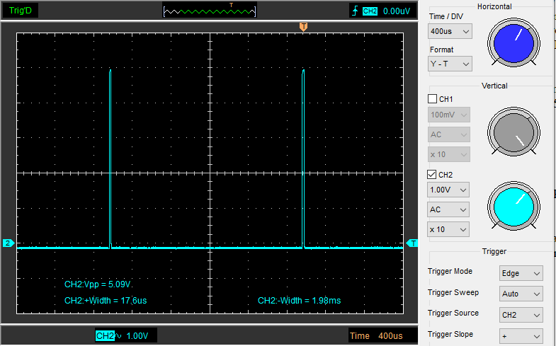

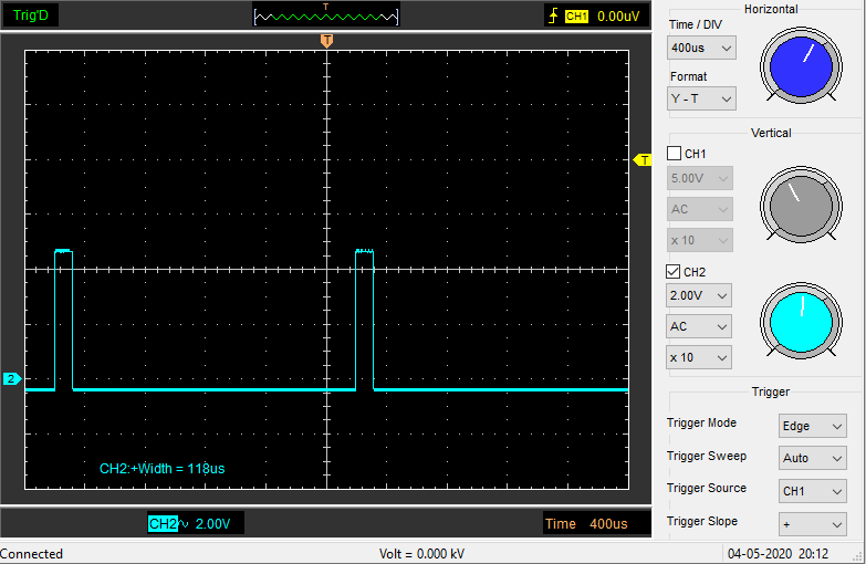

                  On the next step something differ from what is expected.
                  -EFE delay pulse width is expected to be approximately 100us but it is 118us as you can see here.Click image for larger version
ID:	357264. I'm no worry about it but it is close to 20% difeerence.

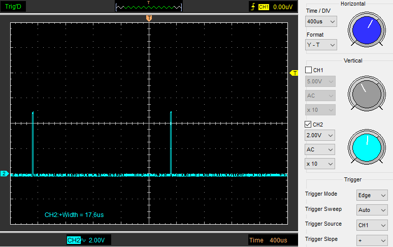

                  -Pulse width at both TP9 (sample pulse width) and TP10 (EFE pulse width) is expected to be approximately 10us but I measure 17.6us that i think is more anoying because it's 76% more than expected....

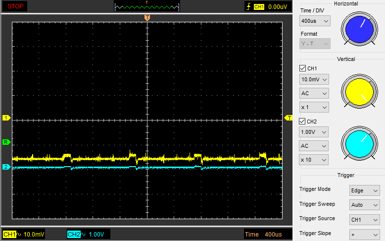

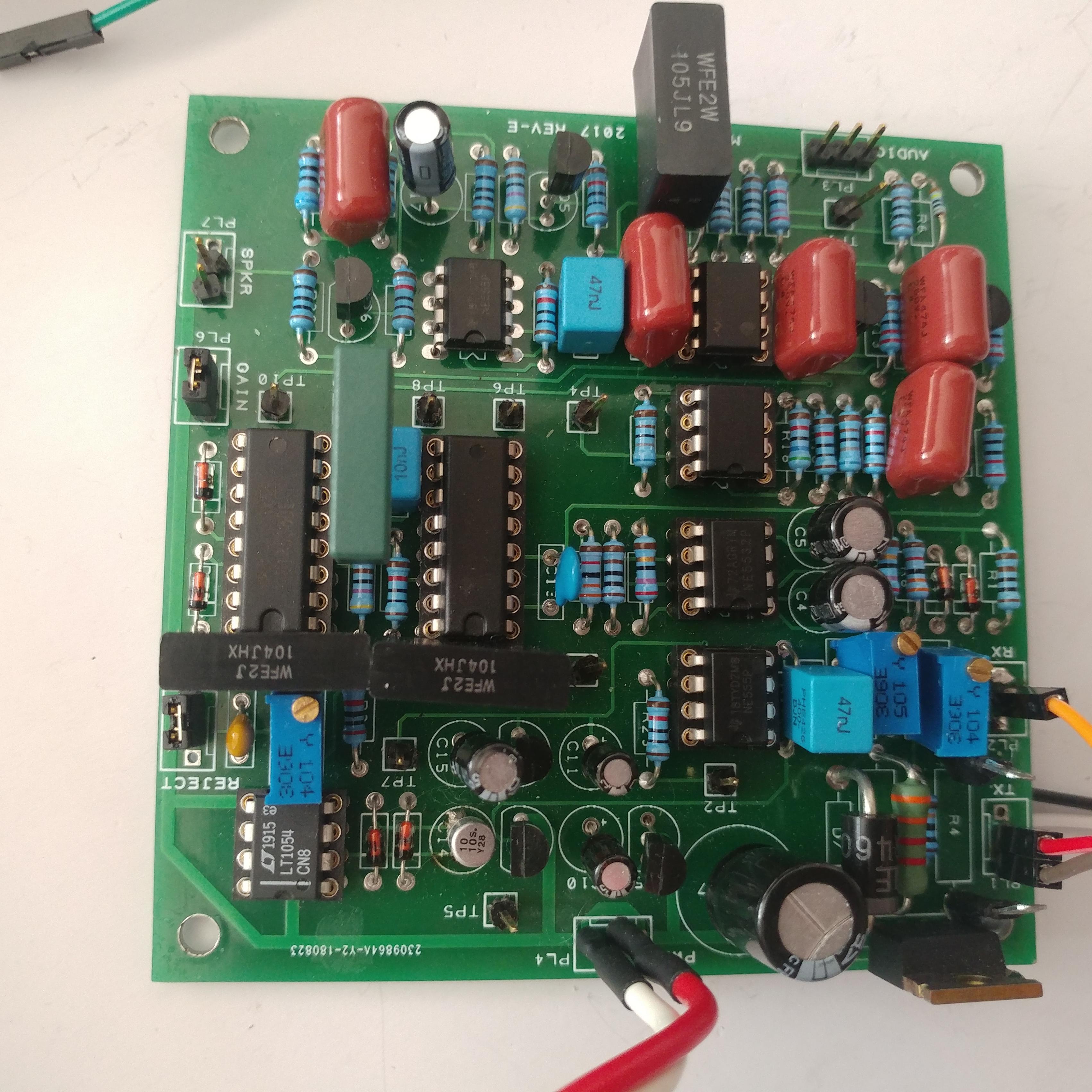

                  Do you think my CMOS could be the problem ? I bought CD14538BE instead of MC14538BCP who was not available. I used 1% resistors and 5% polypropylene capacitors (oversized 2.2 nF_330 V ; 10 nF_630 V) and a 10% ceramic capacitor for C13 (220 pF_500V).
                  I join a picture of my PCB with components Click image for larger version
                  • #54
                    Hi
                    If you look at these two short videos you can compare my build at this point with your results:
                    https://youtu.be/24h2qlO2ggg
                    https://youtu.be/l3dw_DcMhgw
                    My readings do not line up exactly with the build document but seem to be fine and consistent.
                    • #55
                      I saw them.
                      Your EFE pulse width is close to mine 114us vs 118us but you don't show your pulse width at tp9 an tp10.
                      I don't know if I can consider this values as normal.
                      • #56
                        Test Point 9 and 10 are here:
                        https://youtu.be/2VfvT_yaNBQ
                        • #57
                          Thanks surf detector so my problem is not comming from that....the differences probably comme from components and pcb resistance.

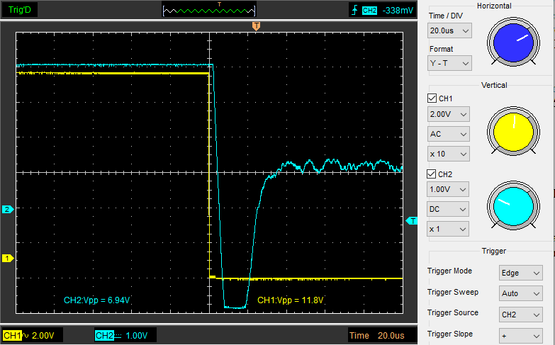

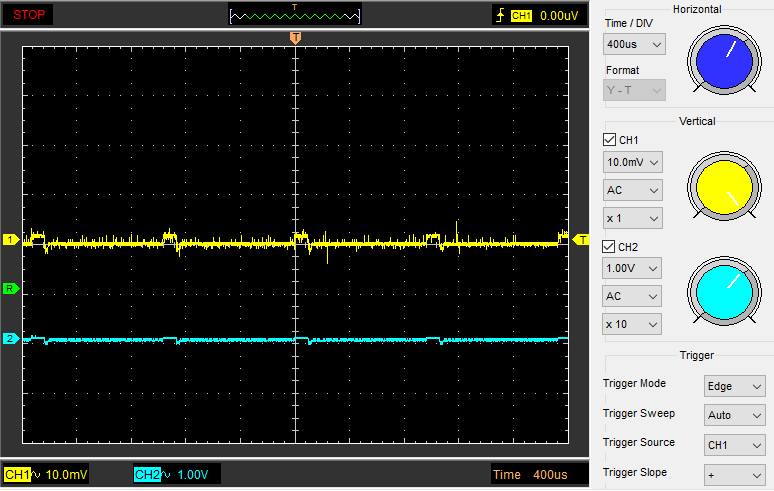

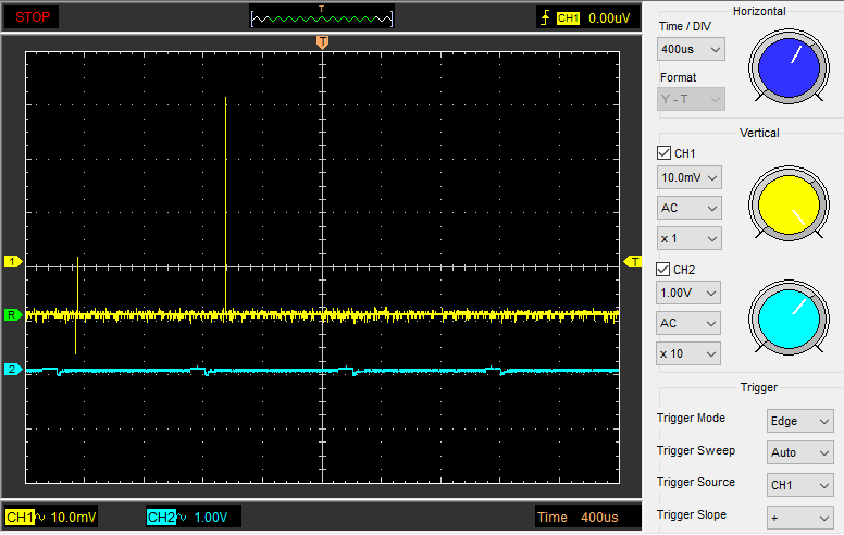

                          In the next step at TP4 the signal do not move with a cola can whatever the coil I use....
                          So I tryed different measurement of the signal on the sampling integrator :
                          -Signal entry (CH1) at U3a without target and with target
                          -Signal entry (CH1) at U3b without target and with target
                          -Signal exit at U3b is the same as TP4
                          I suspect my TL072CP to be broken.

                              -Signal entry (CH1) at U3a without target Click image for larger version
Name:	CH1_U3pin2 CH2_TP4.PNG
ID:	357269 and with target Click image for larger version
Name:	CH1_U3pin2 CH2_TP4 with cola can on the coil.PNG
                              -Signal entry (CH1) at U3b without target Click image for larger version
Name:	CH1_U3pin6 CH2_TP4.PNG
ID:	357271 and with target Click image for larger version
Name:	CH1_U3pin6 CH2_TP4 with cola can on the coil.PNG

                              • #60
                                I think the DC level is supposed to increase (TP4) when the cola can is placed near to the coil.
                                It looks as though nothing is happening. Make sure the chip is inserted correctly.
                                Check for continuity between the socket and the board for each pin of the chip to make sure it's soldered in properly.
                                Replace the chip.
                                I assume you used J113's for the fets.
