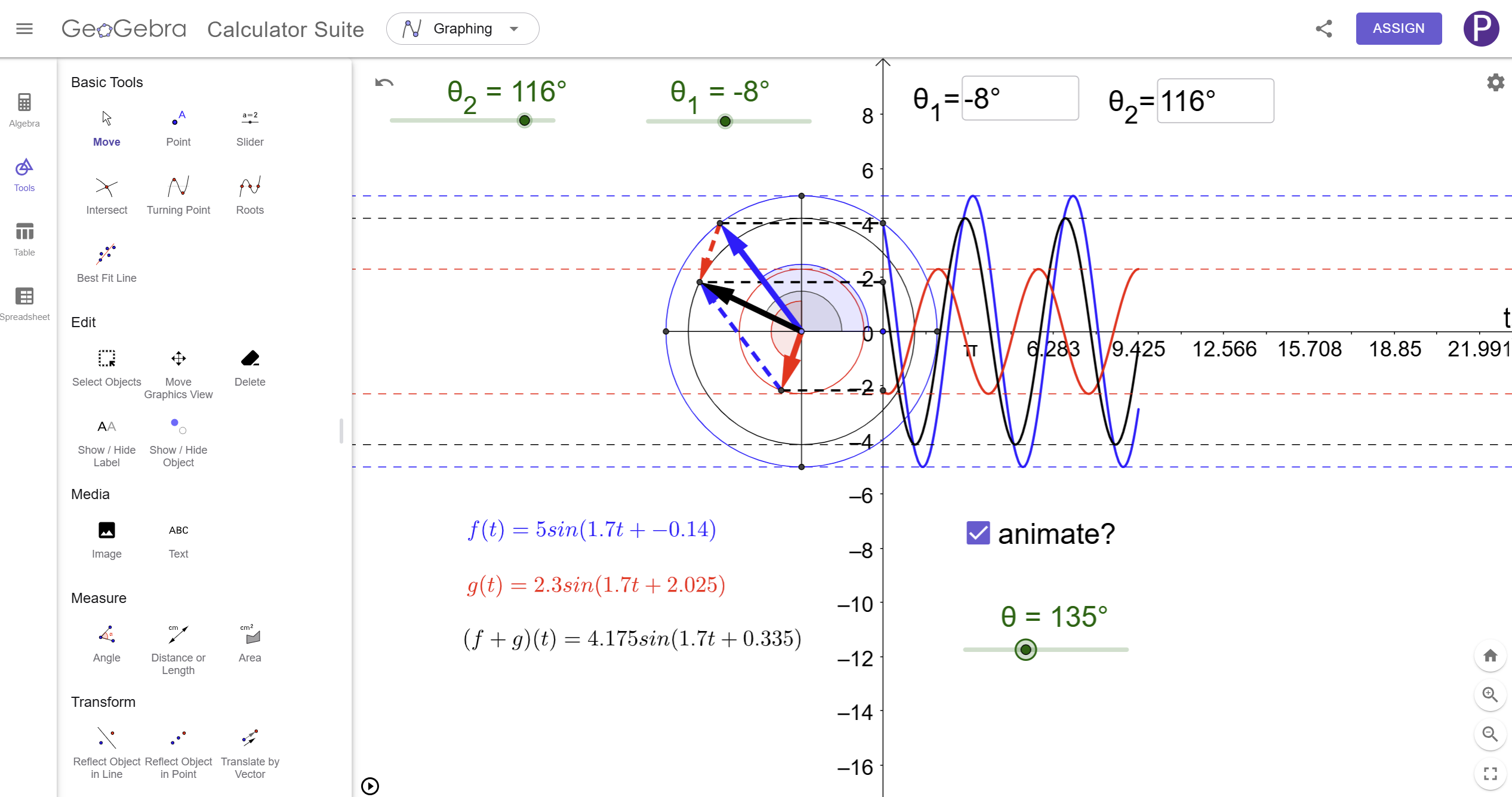

                BTW I found this great tool for testing and animating the various math algorithms for metal detectors and anything else( eg exponentials and phasor diagrams ) called GeoGebra
                You can watch all the variables changing in simulation time.
                Its a math simulator NOT a circuit simulator.
                Interactive, free online calculator from GeoGebra: graph functions, plot data, drag sliders, create triangles, circles and much more!
                Its free for non commercial use and open source.
                Not only that it can export Latex equations and superb diagrams for your patent applications ( which I did very recently ).
                Easier than Matlab.
                Supports full scripting also. ( javascript ).
                You can download the program or run in a browser online.
                Anyway have a look.

                  The variables are samples taken of the decay curve. I call the channels (and their samples) "Tgt" and "Gnd" but in reality they are just 2 samples on the same decay curve. A more precise equation would be
                  GB = response[t - tTgt] - k*response[t - tGnd]
                  This would be for point samples, but in reality we use a sample window and integrate. So the equation should actually be the difference of 2 integrals but I'm lazy and don't want to type all that out.

                      Well, I'm stumped. Don't know what you could have done that's related to my patent but intuitively I can't see a way to implement a universal GB. I do know that some detectors have used ground blanking whereby the ground is essentially discriminated out but this is horrible at masking targets, and I would assume you know this.
                      BTW, I like the math simulator. Trying to figure out if there is a hint in that image.

                        The image is just a phasor diagram from the examples on line.

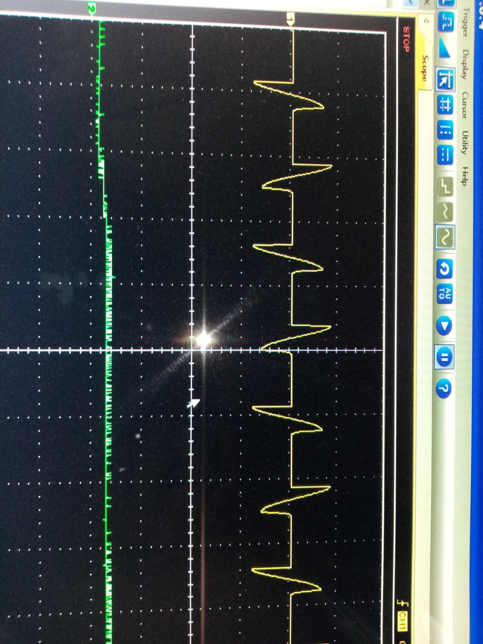

                        • #57
                          Hi Modz maybe a waveform like this?
                          • #58
                            Is that the voltage or the current ?
                            Presuming its the voltage you are saying -pi/4 to +pi/4 wave segment.
                            • #59
                              Yes voltage .. There really is a lot to these waveforms..I mean a lot of magic in the pi-ib region..
                              • #60
                                True but you have some sharp transitions there .... this is a key problem ... ADCs or sampling circuits have problems with sharp transitions as they are not NTSST ...not the same sample twice at the transition sample points ( due to jitter etc )
                                The presence of sharp transitions hides critical information in the magnetic circuit and if you are trying to work out a precise variable like GB then sample jitter will hide the required data.
