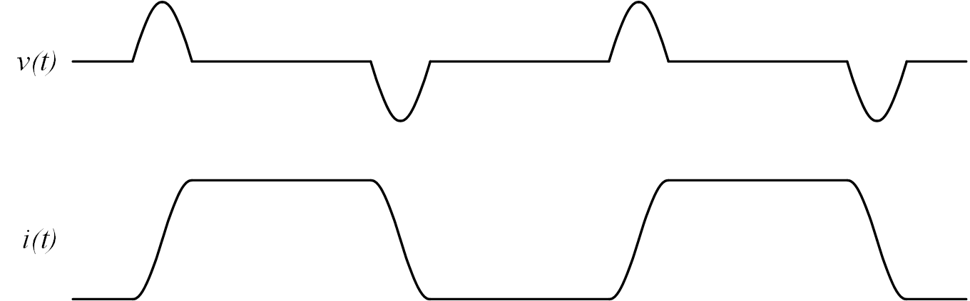

          My application uses a waveform that is characterised by a half sine voltage waveform ( at both the TX and RX coil ) ... I will let you work out what sort of current waveform in the TX coil generates a half sine bipolar voltage waveform
          Basically you get a square wave current with quarter-sine rise & fall.
          During the transitions you get both reactive & resistive components and a strong response from ground. If your targeting response is taken only during the dead time then a ferrite response will have vanished but viscous responses will still be present. I could see that if the power-law coefficient of viscosity was constant then you could then combine a sample from the transition with a sample from the dead time to cancel any such target. But the coefficient varies so I'm not so sure this will work for all hot rocks.
          This is exactly what I was working on with the White's half-sine. The patent claims omitted the GB technique because I was still working on that and it was to be a follow-on patent. That never happened.
          • #65
            Click image for larger version  Name:	image.png Views:	0 Size:	20.2 KB ID:	436151​
            That is the waveform I use (general form of it anyway) ... though the GB technique will work with other waveforms.
            This one was chosen because it has partial di/dt = 0 and partial di/dt = sin(x) there is no need for a waveform where i = 0 for some time because this waveform does have i = 0 for an instant and that is all that is required mathematically.
            Sudden transitions are very hard to sample using an ADC unless the ADC is much faster than the transition rise / fall.

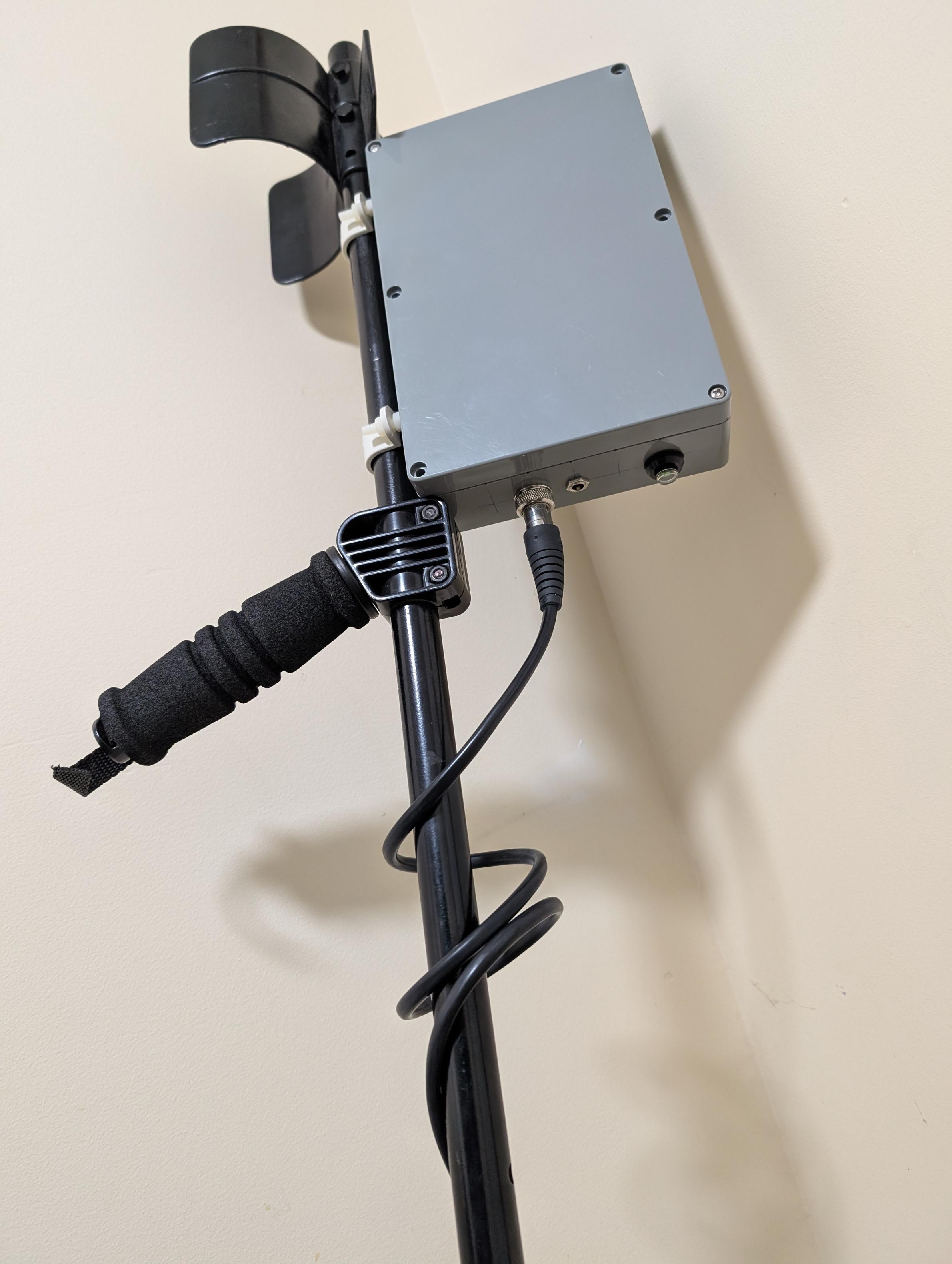

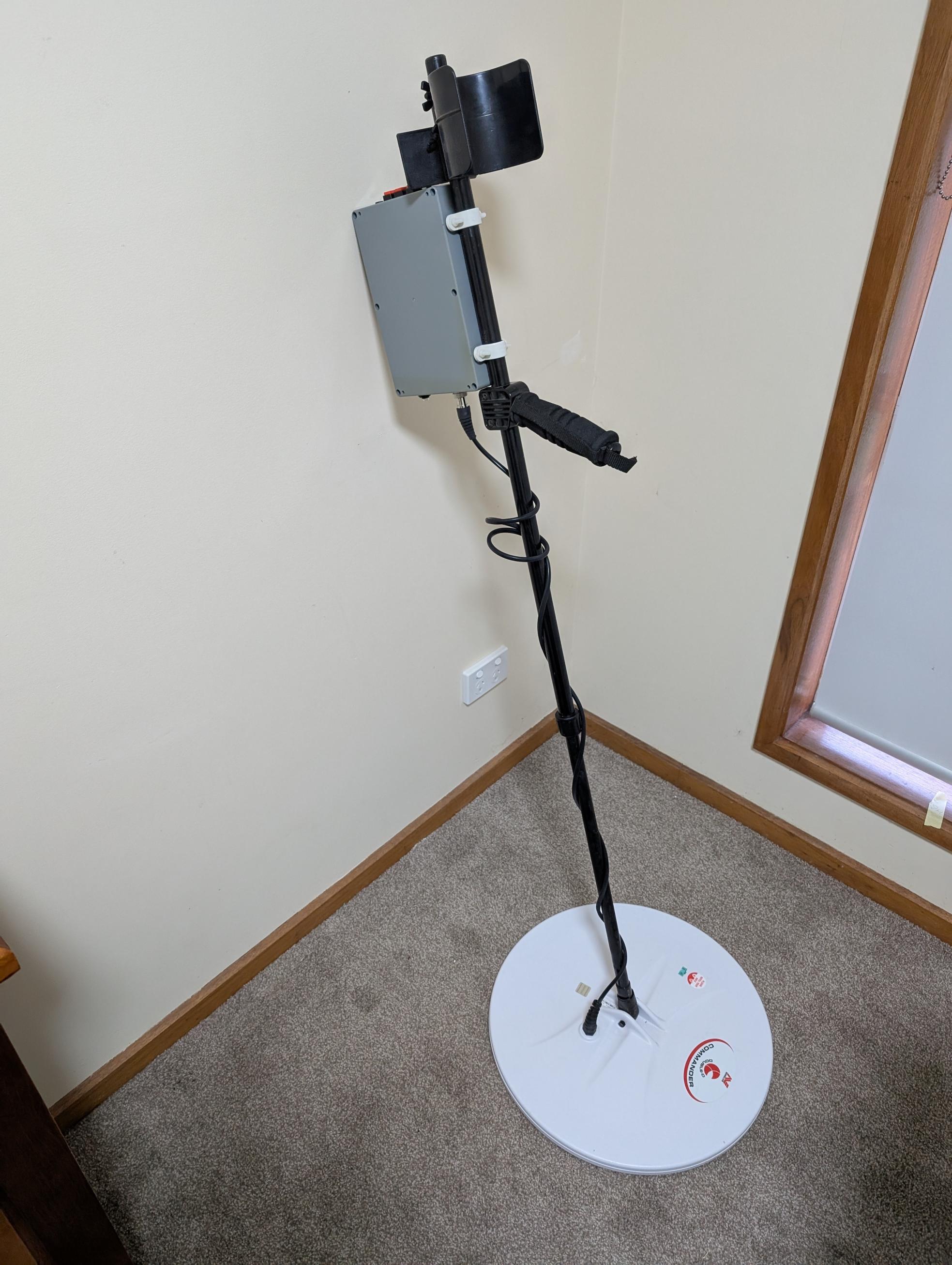

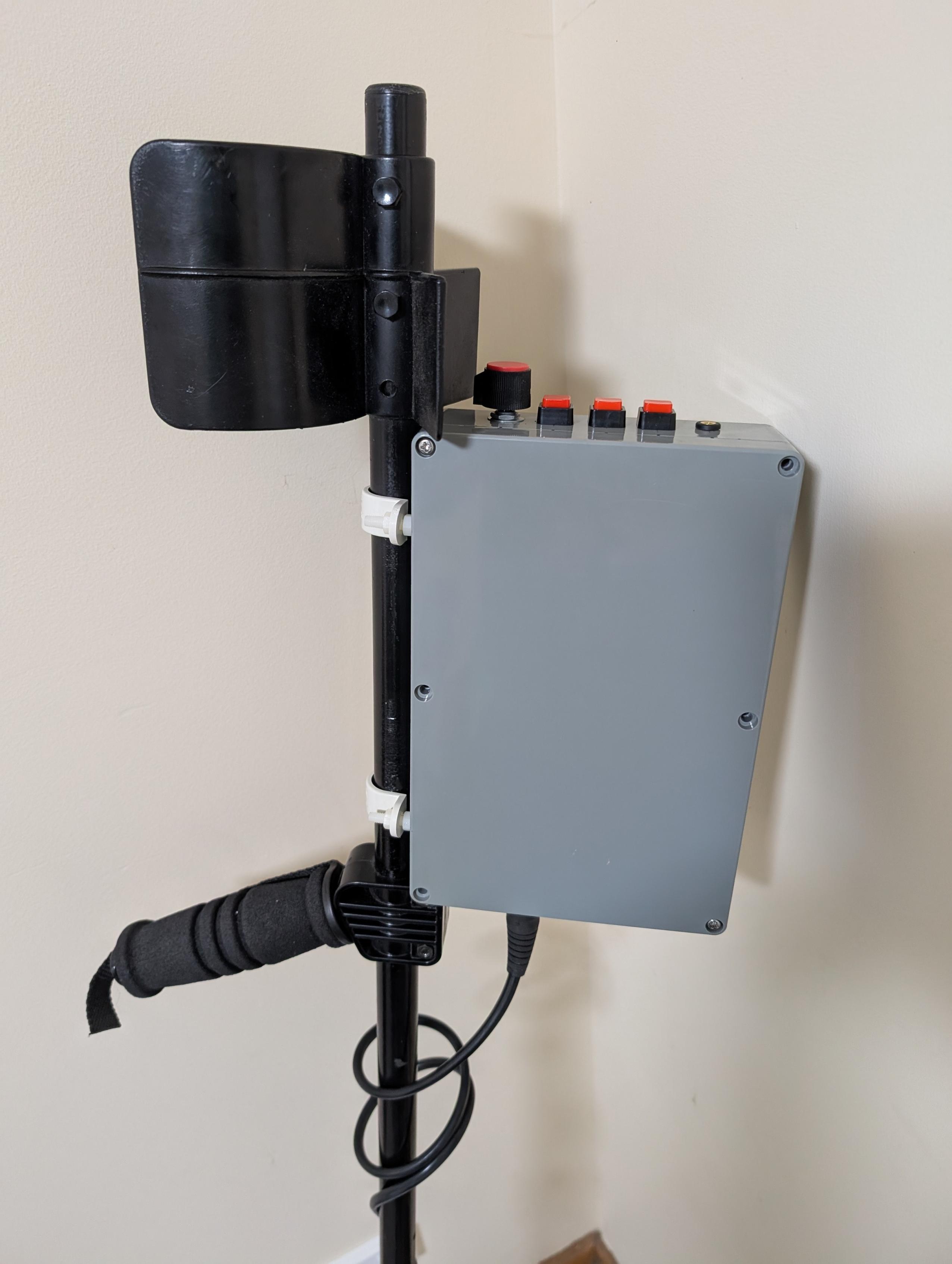

                  ... built up a new detector with the auto ground balance ready for field testing in the golden triangle in victoria, australia.
ID:	436245Click image for larger version
ID:	436246Click image for larger version
ID:	436247Click image for larger version
                  • #70
                    Four screws are missing, please put them in.
                    I know why you left them out, you anticipate going back in.
                    But she looks like a beautiful woman who is missing teeth when she smiles. Good luck.

                      • #72
                        Congratulations Paul! I'm curious what would happen on the monitor screen (and the sound indication) if the stone in the video passes 1-2 centimeters from the probe? What would happen if a stone and a piece of ceramic ( ceramic dust should stick to a neodymium magnet) at a distance of about 5-10 cm passed sequentially about 2 cm from the probe? This happens quite often when working in the field in Europe. Such videos should always show how strongly the stone sticks to a standard neodymium magnet from a hard disk. For example, from what distance a magnet placed on a table will jump to the stone (a rough measure of the magnetic permeability of the stone). All the improvements in cutting the ground are wonderful, but I have repeatedly been to fields with a cultural layer over one meter. there the soil has extremely high active losses – high conductivity + ashes from hearths (fireplace ) + organics + slags. This terribly reduces the real depth of target detection- the soil is terribly "noisy". The prototype has too many “buttons” - 4! A colleague told me that his client said, “I want a detector with two buttons – one for starting and one for stopping.” :rotfl
                        • #73
                          Hey Paul, I expect you to show a bag full of gold, (of course and a few larger pieces).
                          Good luck and success.
                          • #74
                            The work is done grandly! My respect! And yet, judging by the size of the coil, I can assume that in a littered area, where there are many metal targets nearby, there may be problems with the search. For clean places to search for gold nuggets, this will be a great option.
