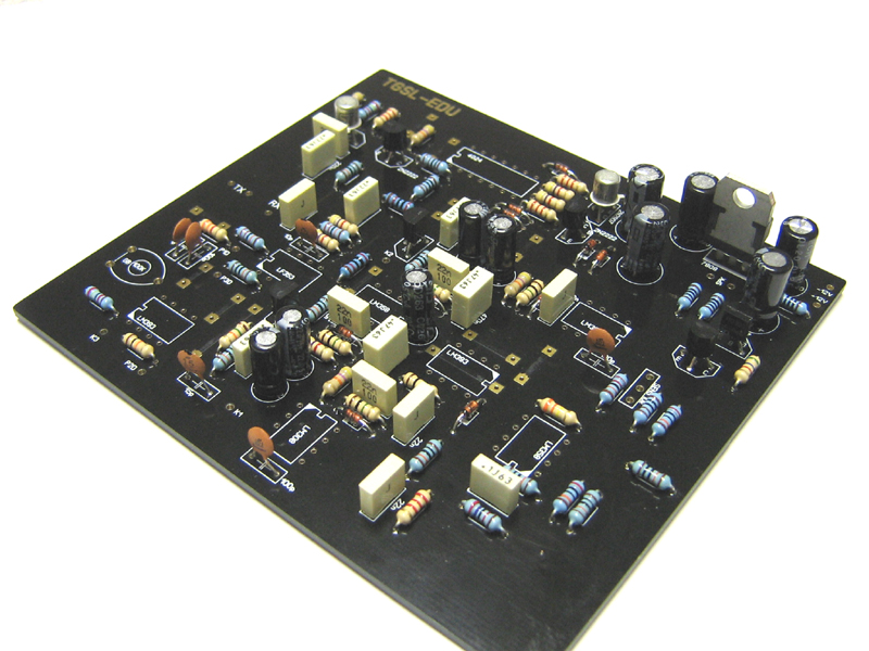

    I am soldering up the board tonight after looking at the pics of older green boards, people had to solder jumpers. On this black board it appears jumpers are already there along with plate-throughs.
    Do I still need to solder jumpers on these newer boards?
    • #62
      No, it's all done for you!

        Just done soldering the board last night.
        I am now debating on using the IC sockets that came with the kit or get the more expensive Augat style sockets that some of the people are using.
        Are there any benefits using the Augat sockets?
        • #64
          I used the cheaper type sockets in my first project and although worked ok still had that nagging feeling that something was amiss.
          Fit best quality you can get your hands on, but ideally ics should be soldered directly onto pcb.
          Only problem with that is of course if you got a duff ic you need to desolder it which is a pain the ***.
          Im in middle of second TGSL assembly and thinking of using all ics from working first project and solder directly.

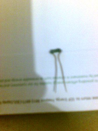

                          installing resistors
                          If you have trouble fitting resistors horizontal due to there size and dont like fitting vertical providing you got the room all you have to do is kink the leads so they go partly underneath each end of the resistor as shown, we done this for years in the TV trade.
