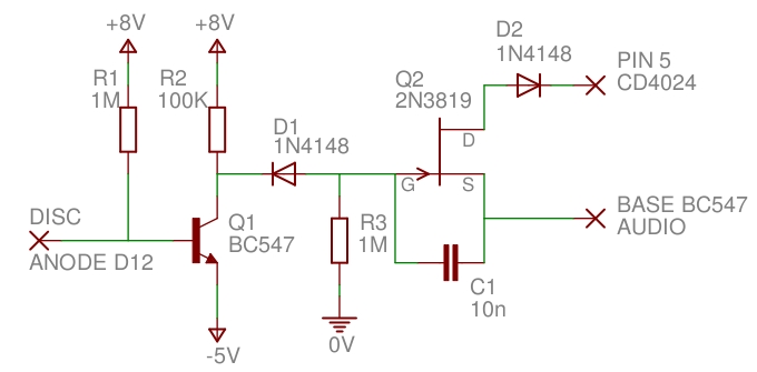

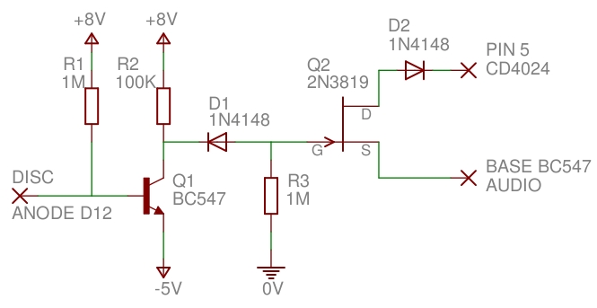

        I was not very satisfied with the two tones. Not enough differents.
        I've tried to work with a channel P FET ... without success .
        Then I've just reversed the command of the N FET by adding a NPN transistor (BC547).
        In Audio disc mode, without signal, the FET is ON.The audio stage is connected to the PIN 5 of the CD4024 through it.
        If the target is ferrous, the output of U106 still low, the FET still ON, the tone is low (PINs 5, 6 & 9 of the CD4024 connected).
        If the target is non-ferrous, the output of U106 turns high, the FET switch OFF, the tone become high (PIN 5 is disconnected, only PINs 6 & 9 are actives).

              I've added a capacitor around the FET to smooth the sound.

                  I think I've found why my last try with a P FET has failed.
                  I've used a 2SJ178. This FET has two protection diodes inside (marqued in red).
                  I'd better use a basic FET like a 2N5460 to do the job.
                  I'll let you know...

                          But you better use my last schematic for the audio.
                          The sound is better.
                          Note : A small mistake on your PCB, the FET is connected to the CD4024 pin 8 instead of 9 ...
