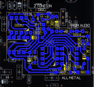

                    • #55
                      @silverdog,
                      You're right, all of us need to think about the future of this project.
                      But for now, the fastest way to upgrade the existing boards is to use add-on PCB.
                      I've already got a layout ready for the Minelab mod.
                      The layout of the two tones mod can be available shortly.
                      The green areas simulate the two PCB.
                      Does anybody can post a video of the VDI working onto a TGSL ?

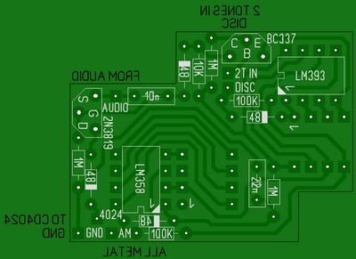

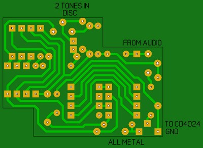

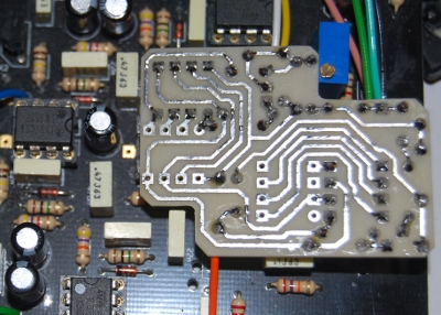

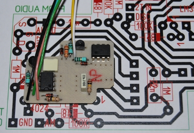

                            2 Tones PCB
                            Hello,
                            Here is the last version of my piggyback PCB for the TGSL.
                            I've done one last night but not populated yet.
                            It should be mounted upside down into existing DIL supports (U106 & U107).
                            I'll keep you inform about the results.

                              • #60
                                Some photos of the PCB
