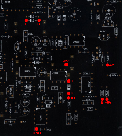

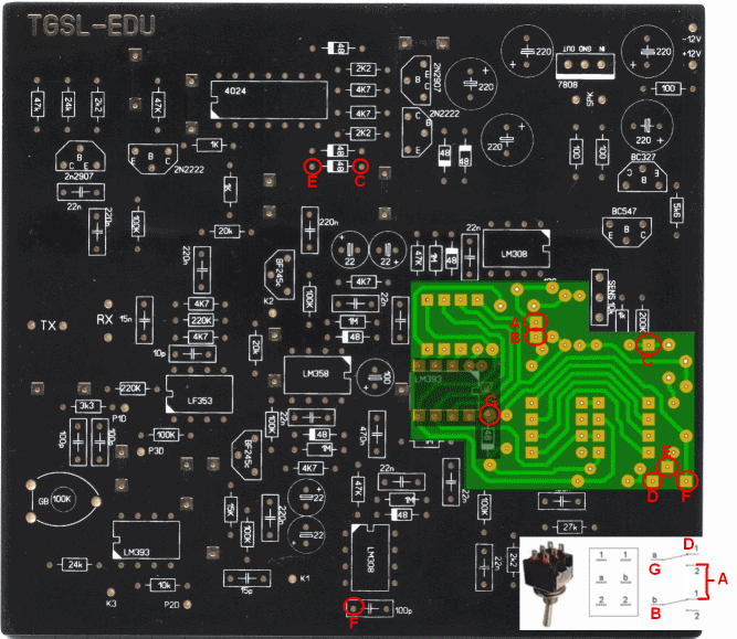

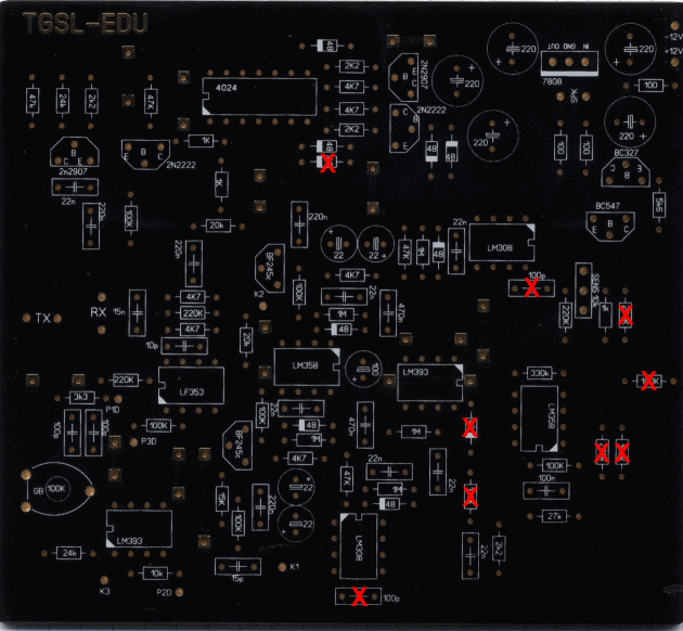

          • #65
            Mod wiring
            Hello,
            Two more photos about the mod.
            The first one shows components to be removed.
            And the second one, the wiring between the PCB, the piggyback board and the DPDT switch.
            Note : The G point (don't laugh ! Unwanted joke !) is hidden on the main PCB (1N4148 Anode) under the piggyback board.
            Have fun,
            Hugo

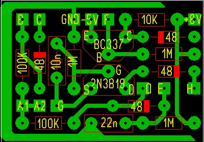

                  • #69
                    @satdaveuk :
                    Please find below a standalone PCB.
                    I haven't test it so double check before doing it.
                    Have fun,
                    Hugo

                      Hi Hugo
                      Thanks for that your very helpful.
                      Do you or anybody on here know how i can turn your PCB into black tracks and white background so to be able to make PCB, I used to be able to do it but cant remember how.
                      If not I can draw one because you have done the horse work on it.
                      Thanks in advance
