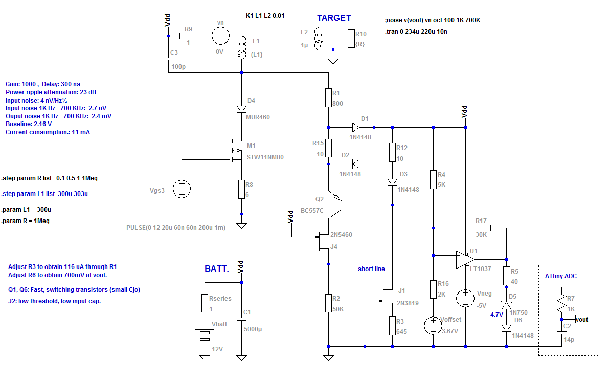

I want a few more people to comment on your amp designs Teleno. I am happy with the latest one. Have you run a component value variance sweep (MonteCarlo) on it to see how it performs? I envisage all values in the final build will be 1% resistors, but if the thing still works with 5% then we can wrap this section up and move on if all agree.
FYI I have acquired an ML Etrac with an 18X15 SEF coil (plus standard) and on the beach it simply ROCKS. Deep, quiet and it discriminates, but I KNOW I'm missing those deep and thin rings, THAT is why I want to make a good PI. The Cscope 4PI just can't cut it in terms of the deep finds (sadly).
I have posted my novel GB scheme in another thread, should be tested in Aussie goldfields. If it works then gain shouldn't be a problem.Originally posted by Sean_Goddard View PostI was quoting the low gain front end as it seems that high gain ones suffer in Australian goldfields
The final design will be MCU based. I'm thinking ATtiny. The amplifier will be self-adjusting by two DAC outputs directly controlling the gates of J1 and J3. Tolerance is of no concern.Originally posted by Sean_Goddard View PostI want a few more people to comment on your amp designs Teleno. I am happy with the latest one. Have you run a component value variance sweep (MonteCarlo) on it to see how it performs? I envisage all values in the final build will be 1% resistors, but if the thing still works with 5% then we can wrap this section up and move on if all agree.
The current at Q2, which is the most critical parameter, is temperature compensated by D3.

The following components should be added:
1 x ATtiny84 MCU (evt. ATMega family)
1 x MCP4728 quad DAC 12 bit
1 x standard 5V regulator.
1 x BS170 for driving the MOSFET's gate.

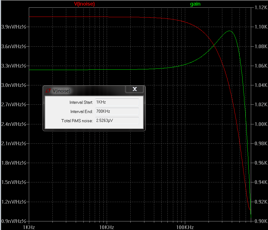

AD8610 is 6 nV/√Hz, my amplifier is 3.6 nV/√Hz.Originally posted by eclipse View PostAs for the preamp op amp consider the AD8620(x2) or AD8610(x1) - lowest noise, high speed, etc.
AD8610 is dual supply, my amplifier is single supply.
The purpose of my design is to do away completely with op-amps, be faster and achive lower noise. Look again at the circuit (download the simulation file). It's based on discrete components and has a gain of 1000 x Input noise is 3.2 uV (can be made 2.5 uV with emitter degeneration on Q4 and Q5).
AD8610 might be an option as a second stage though, not as preamplifier. I'll consider it and thanks for the sugestion.
P.S. LT1037 has similar characteristics and is usually cheaper.

The discrete solution does not require tight tolerances because an MCU will adjust the 2 offsets required (via gates of J1 and J3). That's all.Originally posted by eclipse View PostThe LT is not JFET type like the AD (not sure?!). Descrete solution like cutting edge standalone op amp offers "repeat-ability" - it's all there in the package.
If you take 10 different op amps they will perform the same.
While the other solution may give unexpected results - lots of connections may pick up some noise long the way, component tolerance, etc.
If you look at the circuit, all the connections except the input one are low impedance, carrying currents in the order of mA. Parasitic noise stands little chance.

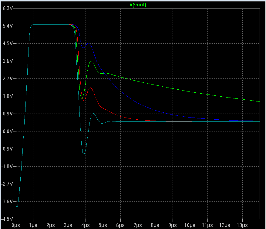

Here's a version with LT1034 as a second stage. Noise-wise is the same, but the op-amp version is a bit slower to settle and the output swing is limited. Then there's the added overhead of a negative rail.Originally posted by eclipse View PostIt will be interesting to see a real working example, if it will prove better / worse.
