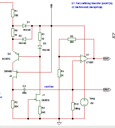

I'm thinking Teleno's amp needs to be capacitor coupled to the integrator. I've been direct coupling with my test circuit. Wondering what the advantages and disadvantages are. EF cancelling works because the two samples are the same. With capacitor coupling they won't be, is that a problem?
Only if the cap decays during the TX off time. If it is large enough it should not be problemOriginally posted by green View PostI'm thinking Teleno's amp needs to be capacitor coupled to the integrator. I've been direct coupling with my test circuit. Wondering what the advantages and disadvantages are. EF cancelling works because the two samples are the same. With capacitor coupling they won't be, is that a problem?
Surfmaster is already capacior coupled, so EF cancelling must be iffy at best.Originally posted by green View PostI'm thinking Teleno's amp needs to be capacitor coupled to the integrator. I've been direct coupling with my test circuit. Wondering what the advantages and disadvantages are. EF cancelling works because the two samples are the same. With capacitor coupling they won't be, is that a problem?
This is it: http://www.geotech1.com/forums/showt...mit-time/page3Originally posted by 6666 View PostCould you please post a link to it ?
Yes, it's 100n in series with a 10K resistor. The time constant is 1ms.Originally posted by 6666 View PostThe typical surf cct uses 100n cap between preamp and int
The late sample (EF) is taken at about 240us after the main sample. This means the late EF is 20% lower than the early EF (it decays to 80% of the initial value after 240us). It can be compensated by a gain coefficient, though.
A better solution is to use a preamp (gain 10 - 20) and couple it capacitively to a JFET-input Op-Amp which, in turn, is DC coupled tot he integrator. In this case you can use C = 100n and R=1M for a time constant of 100ms. The decay after 240us is a mere 0.3%.

Alright I'll do the maths and the electronics design, you do the PCB layout and prototyping. Deal?
I can do the programming as well unless we have a more experienced volunteer.
