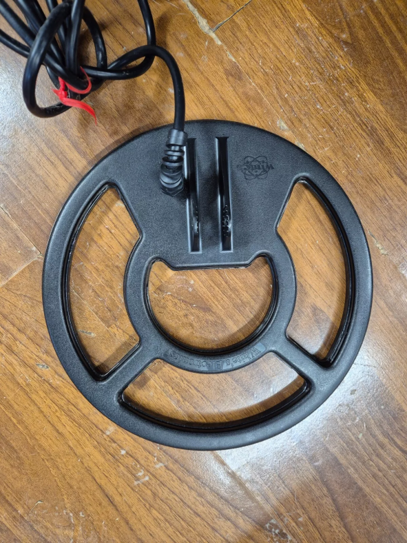

              • I'm looking for a coil for a potential voodoo build. I found someone selling a White's 9" spider coil at a reasonable price, but I don't know anything about this coil other than it is for a Coinmaster / Prizm. Does anyone have any knowledge they can share?

                • From recollection:
                  TX = 540uH
                  RX = 15.7mH
                  • Thanks Carl.
                    • It's basically the same coil windings as the MXT/DFX/V3 coils but without the extra compensation components and a different connector. You can run a Prizm coil on a DFX and vice-versa but the target IDs are a bit off.
                      • So it looks like it could work I think. George tested a range of different coils and the inductance of the White's RX coil is similar to the Tesoro one George tested (15.36 mH). I think the inductance of the White's TX coil should be OK.
                        To get the RX coil to resonate at ~10.5 kHz would need a 14.6 nF capacitor. The nearest I have is a 10 nF which would give ~12.7 kHz or a 22 nF which would give ~8.6 kHz, or I guess I could put 10 nF and 4.7 nF caps in parallel. But it doesn't look like the RX resonant frequency is critical from what George wrote in the book.
