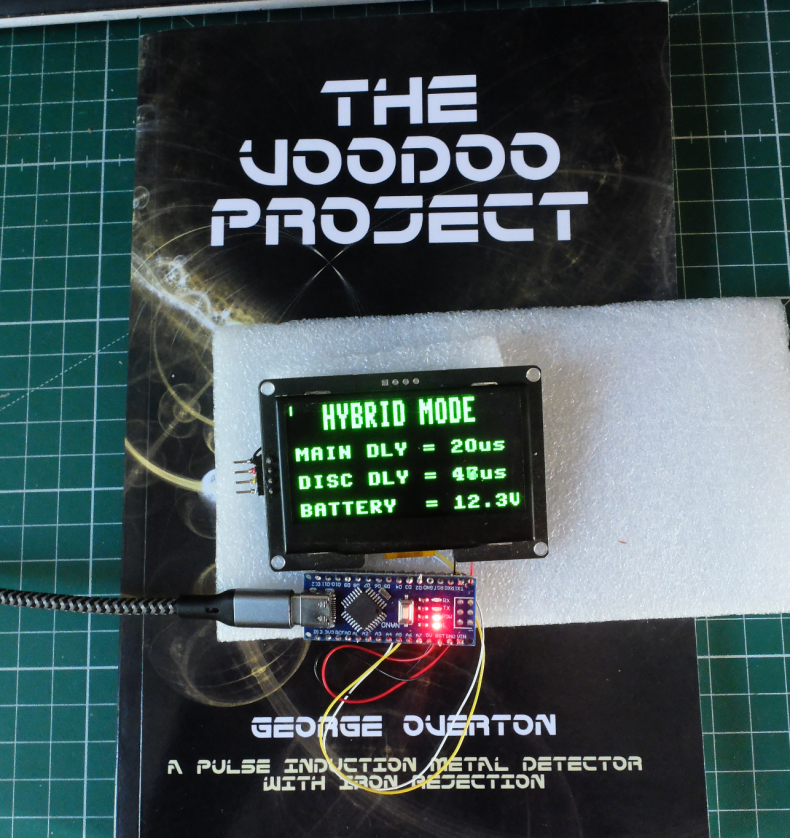

        • Bonjour à tous,
          It was while browsing the Amazon site that I discovered this project.
          I ordered the book and .... after years of absence from this forum, I plunged back into the world of metal detectors.
          Waiting to receive the circuit board, I couldn’t resist testing the Arduino version. Finding the 1.3" display a bit small, I had a 2.42" OLED that slept in a drawer, a little more expensive but so much more comfortable.
          Congratulation for this achievement and the adaptation of the code on the Arduino IDE.​

            Very good, I look forward to your experience with the project.
            • It’s your work that is superb, Georges!
              In a first step, I will fill the printed circuit board according to your description, with a Pic and the original firmware,
              testing its functionality and performance with various coils, homemade of course....
              Afterwards, I would like to retrieve the SPI port of the Arduino (pins 12 and 13), in order to connect a TFT display,
              and if I am able to adapt the use of the Timers, maybe replace the Nano board with a Teensy.

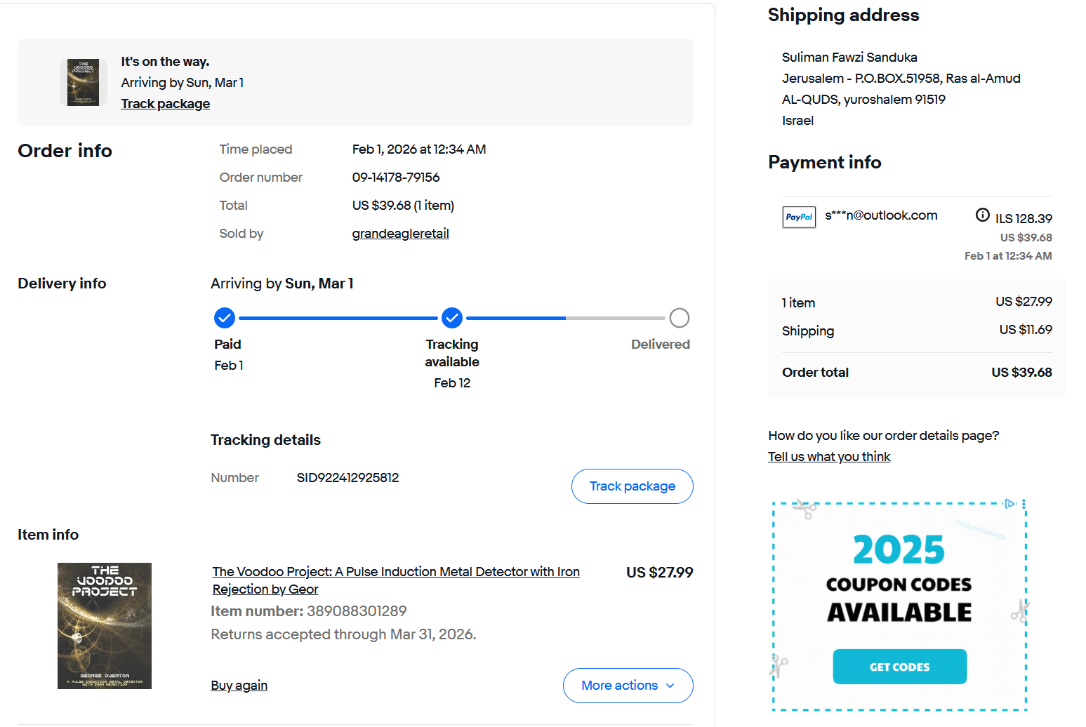

              • Dear Sir/Madam:
                I purchased the book, "The Voodoo Project." Please provide me with a link to the schematics and components.
                Thank you.​ Click image for larger version

                • Originally posted by suli1963an View Post
                  Dear Sir/Madam:
                  Thank you.​ Click image for larger version  Name:	book.png Views:	0 Size:	254.5 KB ID:	445349
                  The Voodoo Project - Published October 2020​
