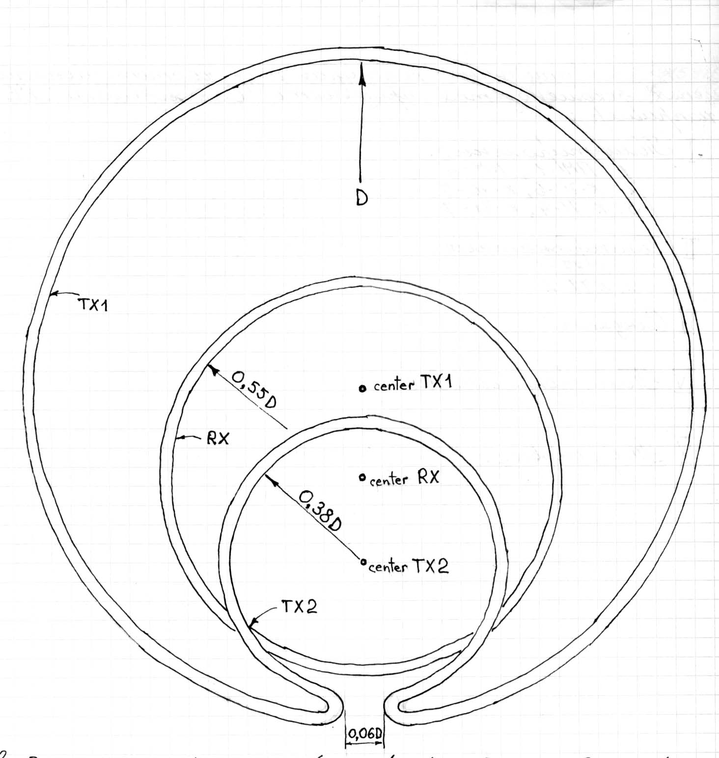

              @Lamoiz,,,I don't think the Voodoo coil has a ' Bucking' coil. I believe it just consists of an outer loop, the TX, and the inner loop, which is just the RX. The TX Coil has a parallel Damping resistor and the RX Coil has a parallel Capacitor. Someone can correct me if I'm wrong or mistaken,,,Regards, Marty.
              good evening Marty,

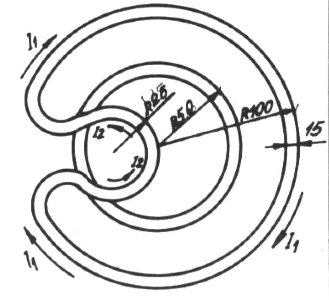

              if there is a canceling coil, otherwise it will be impossible to null the rx coil. I have already made several concentric coils, the development is not easy, even with the calculation, trust me. the double d solution is easy to do, so is the omega. but if this is the only way to make a coil for the voodoo, then it will have to be done. however, I am going to do a 30cm omega and a super d with two rx. I don't think I will say anything more on the forum, because when I ask questions I have no answer .. so ..

                • Hiya Lamoiz,,,Yes, I was wrong thinking there wasn't a Bucking coil but Qiaozhi corrected me. I still have to find out how to calculate the amount of turns needed for the bucking coil of the small coil I'd like to try first. I had some recent success making an Omega coil for my IGSL,,it works quite good but I'm still experimenting with it at the moment. Regards, Marty

                    • Hiya Lamoiz,,,I used this template for my IGSL Coil but I expanded the drawing into a 8" size coil. It may be good for what you are wanting to try? Regards, Marty
                      • With this template you can make it any size.
                            You can try any type of induction balanced coil you desire: concentric, omega, DD, super D, etc. In theory they should all work, but some may be better than others. Personally, I opted to focus on the concentric type.
