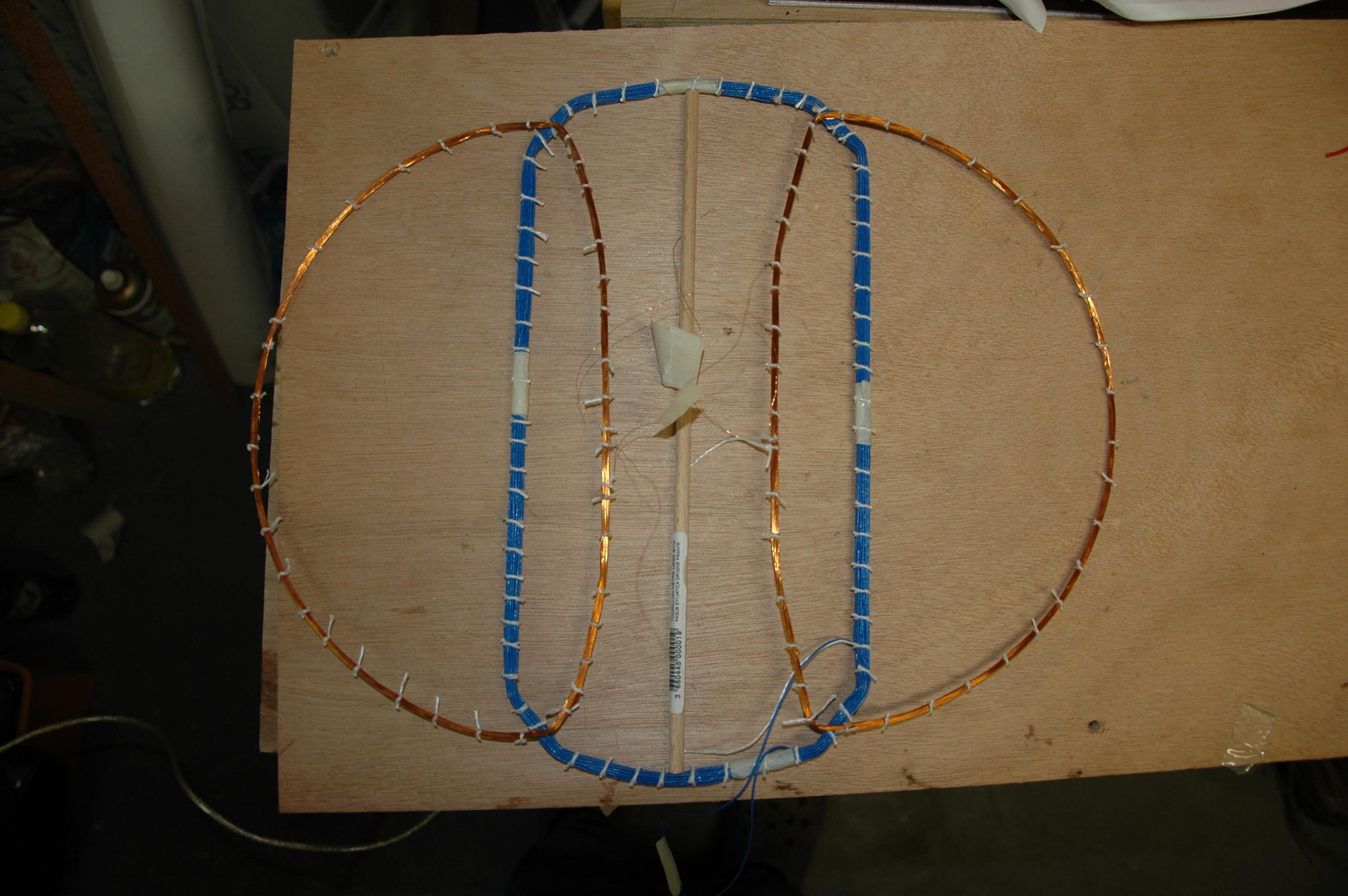

            • it going....Click image for larger version

                  • Originally posted by lamoiz View Post
                    it going....[ATTACH]53782[/ATTACH]
                    • can you show some video of this metal detector in operation? I'm very curious
                      • Hi lamoiz
                        I am also making this coil when time allows. Interesting to note that you have stepped the TX coil upwards. Is there a particular reason for this?
                        • Originally posted by MartinB View Post
                          Hi lamoiz
                          you are an observer! this is just for the shape and stiffness. this also affects the inductance, but very little. what are the dimensions of your coil?

                            H Lamoiz,
                            Very clean coil ! Beautiful!
                            Curious what are the values of your coil?
                            And what is its speed when you get a chance to scope it?
                            • Originally posted by godigit1 View Post
                              H Lamoiz,
                              hi Godigit, the TX coil is 430uh, and its damping resistance @ 650r. wire 0.8 silicone. The two RX are respectively 5.5 mh or a series total close to 11mh ... wire 0.18; all tuned with a capa 21.6 nf (@ 20 ?) .. the purpose being to have a frequency of 10.5 khz, (10.32, to be precise)
                              • in parallel with this coil construction, i made a large omega with oval center, the tx and rx values ​​are close to this one, but the difference is the use of litz wire for tx.
