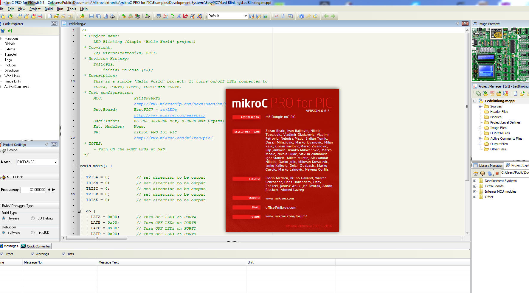

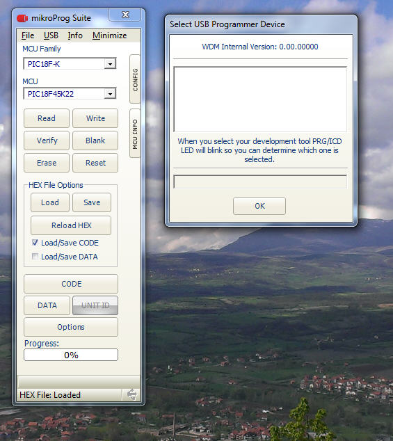

                @Q;
                two screenshots i couldn't post on pm:

                    Similar question:
                    why ...Tools-me Programmer F11... or mikroProg Suite is not recognizing this development board as well?
                    Since both (mikroBootloader and me Programmer) are parts of MikorC Pro for PIC software.
                    What kind of problem is this?
                    (that's why i don't like MikroE and their "philosophy" at all)
                    Probably driver for my development board? Which is? Where to find it? Not on MikroE site for sure!
                    So i have now all the products from the very same manufacturer and those are not recognizing each other!?
                    Pfffffff!

                                If your board is from mikroe then it should be recognized by the mikroe IDE. You probably need to load a driver.
                                The Microchip PIC kits are no recognized either, so I use the Microchip X IPE to flash the PIC directly through the ICSP connector.
                                Update: Go to https://www.mikroe.com/ready-pic
                                and scroll to the bottom of the page. The bootloader software is there ... BUT - it only supports 16F877, 18F25K22, and 18F45K22.
