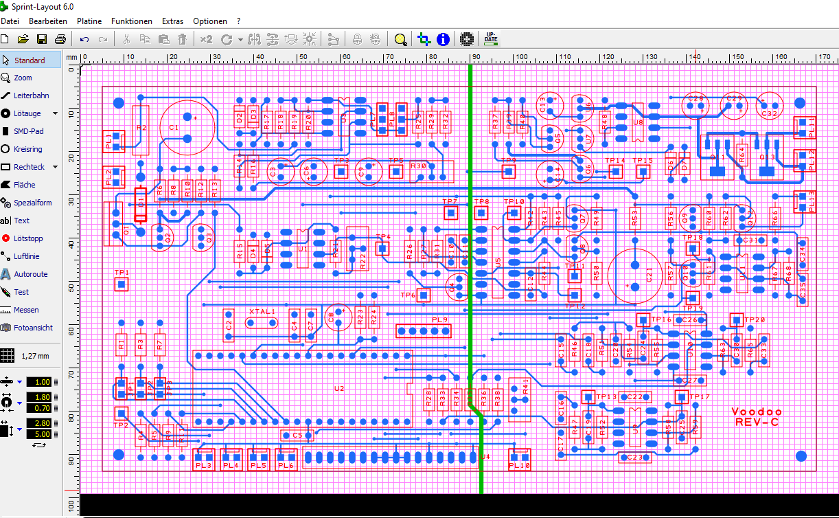

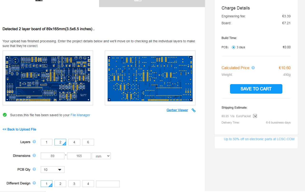

                          good news - gerber are ok for production of pcb
                          but after looking pcb design (as total noob myself i thing) i would do many changes
                          biiger copper tracks, especially at the power consuming parts, other size of soldering pads according to type of soldered parts
                          i would cut it also into two pcb connected with pcb header, or single soldered pins

                            @Bernte one,,,Which PCB Company did you order from? 10.60 euro is a good price! Regards, Marty.
