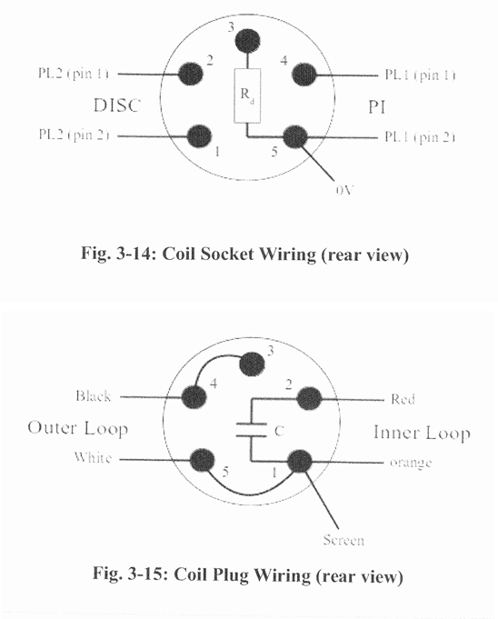

I'm just having a bit of trouble reading the schematics in the book with them being so small but I'm also a little confused as to which terminals are '+' or '-' on some of the 'PL' (2-Pin) connectors and the speaker connector. Really don't want to start building till I know what's what. @Qiaozhi,,Could you look at the pic I posted and tell me which is which please as I'm a littl confused? Both diagrams say 'Rear view'. Regards, Marty.Attached Files

Both diagrams are the "rear view". The top one is for the socket, and the bottom one is for the plug.Originally posted by MartyJ1963 View PostI'm just having a bit of trouble reading the schematics in the book with them being so small but I'm also a little confused as to which terminals are '+' or '-' on some of the 'PL' (2-Pin) connectors and the speaker connector. Really don't want to start building till I know what's what. @Qiaozhi,,Could you look at the pic I posted and tell me which is which please as I'm a littl confused? Both diagrams say 'Rear view'. Regards, Marty.

Thanks Qiaozhi for those answers. So these concentrics then have no bucking coil, is that right? @6666,,Glad you sorted him out, he's a good frend of mine and great bloke,,,I know his good wife Bridgitte bought him the book for a Xmas pressy and he's worried now that when she wraps it up in Xmas paper he won't be allowed to read it until Xmas day!,,LOL.. I sent him a Felezjoo pcb to have a play with,,,he's going to let me know how it handles with our highly mineralized 'Aussie' soil,,,It'll be great to see what yours and Trev's results are using the Voodoo on Aussie soil too,,,Hope your book comes soon, Regards, Marty.
