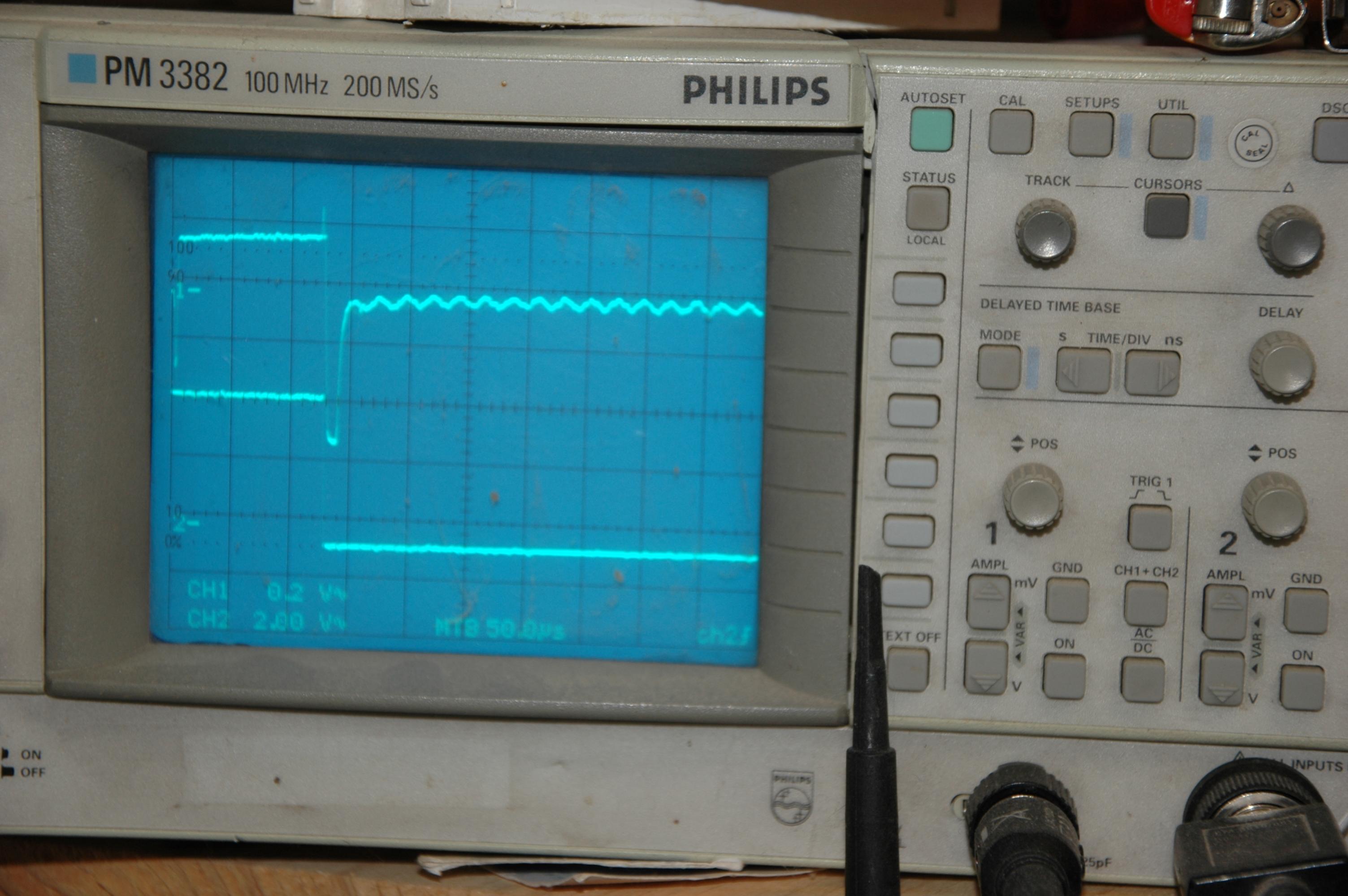

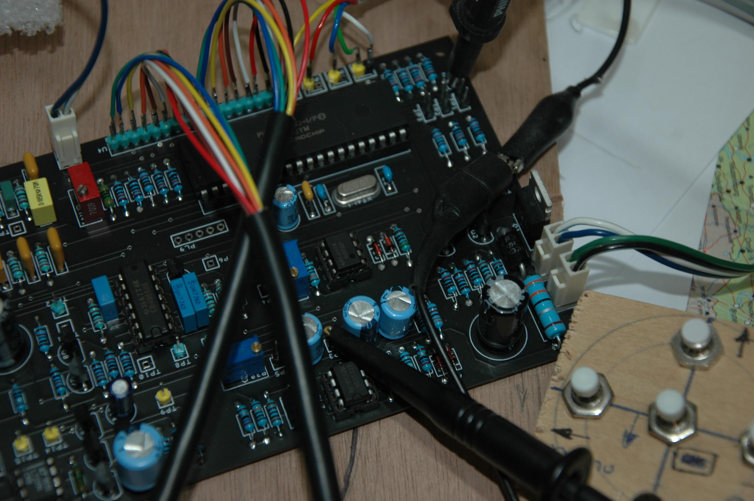

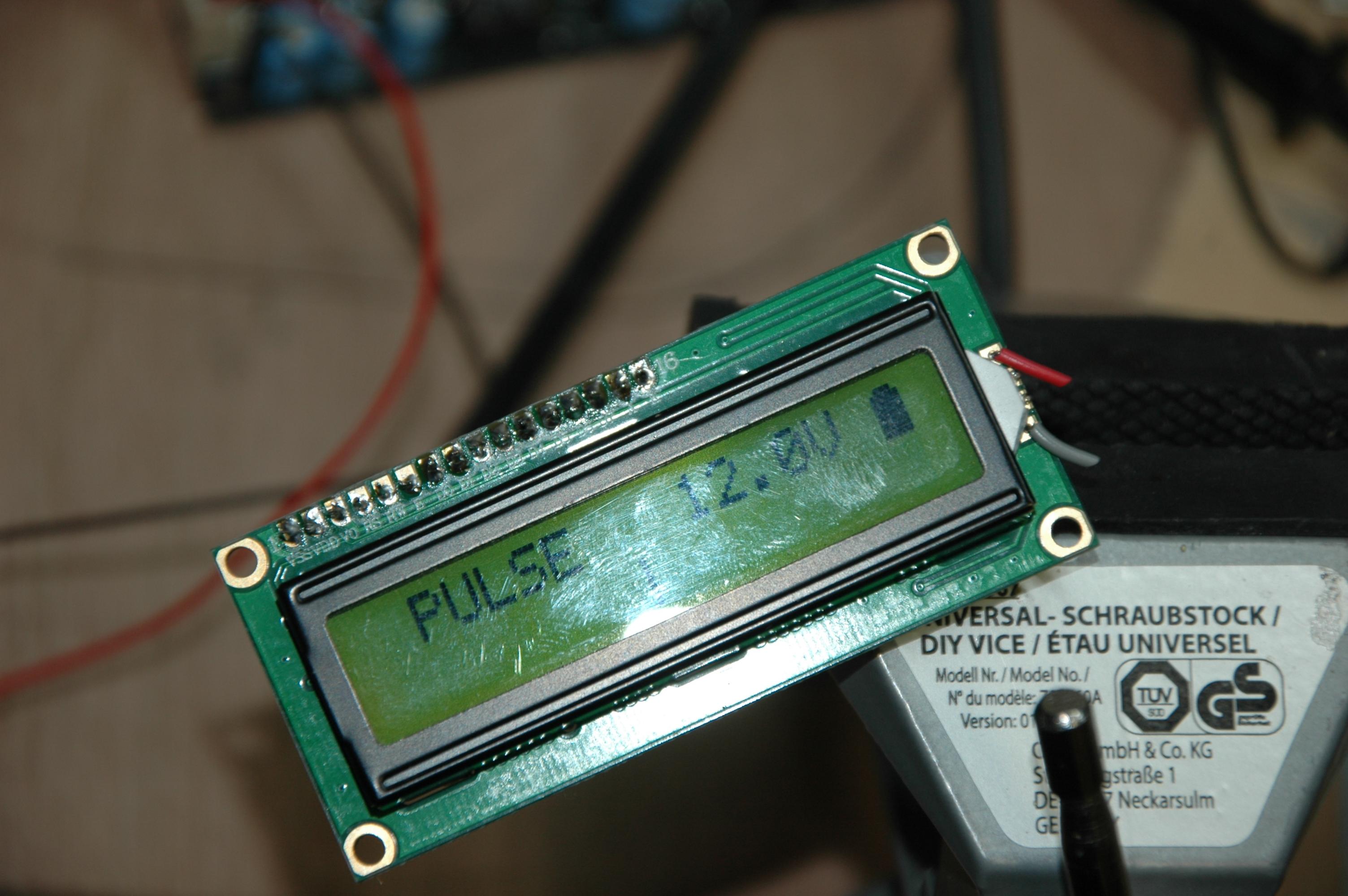

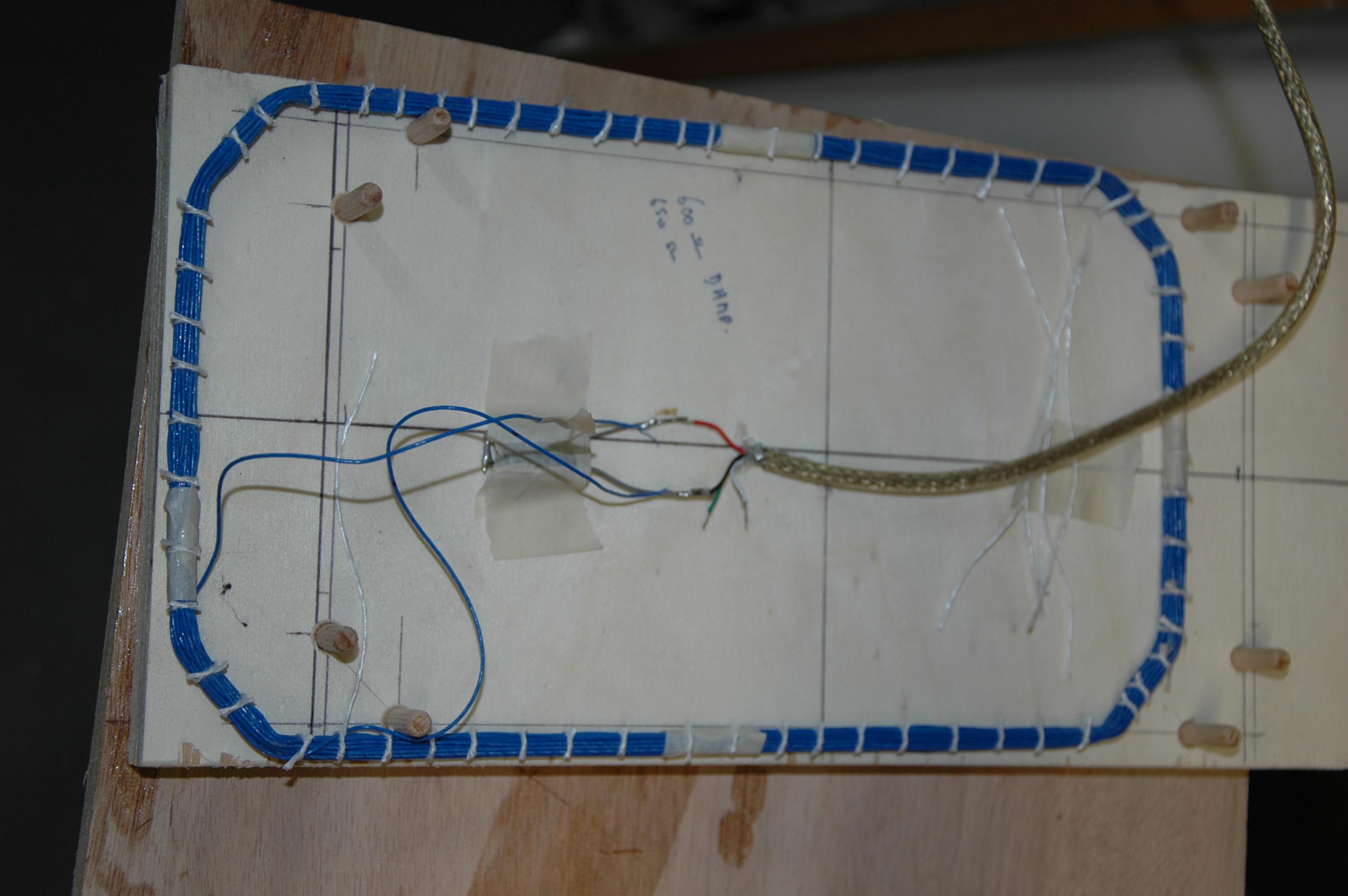

                • I have adjustment problems, the PI coil used is made of silicone wire, and .430uh, r 2.2ohm, damp 650ohm; a test on the felezjoo measures a delay of 14us .. it is a rectangular coil, the tp3 signal on the oscilo is not good .. I will take pictures of all this ..

                      • Originally posted by lamoiz View Post
                        les photos
                        [ATTACH]53769[/ATTACH][ATTACH]53770[/ATTACH][ATTACH]53771[/ATTACH][ATTACH]53772[/ATTACH]
                        Try rotating the coil around, vertical as well as horizontal. Apart from the interference it looks OK to me.
                        • good evening George,
                          Could you tell us more about the R30 and R22 trimmer, how to properly adjust R30 offset and how to properly adjust R22 ...? (with a screwdriver ... yes ...) where should we measure and how much?
                          thank you.
                            thank you.
                            Adjust R30 so that the signal at TP3 settles near 0V.
                            R22 is the gain adjustment for the DISC channel. Simply turn the preset to its lowest resistance setting for initial testing. The adjustment is provided in case you want to experiment with a higher gain setting. This preset is discussed on page 75.
                              yes I do not know where the interference comes from, I am in the workshop, I do not know ..
