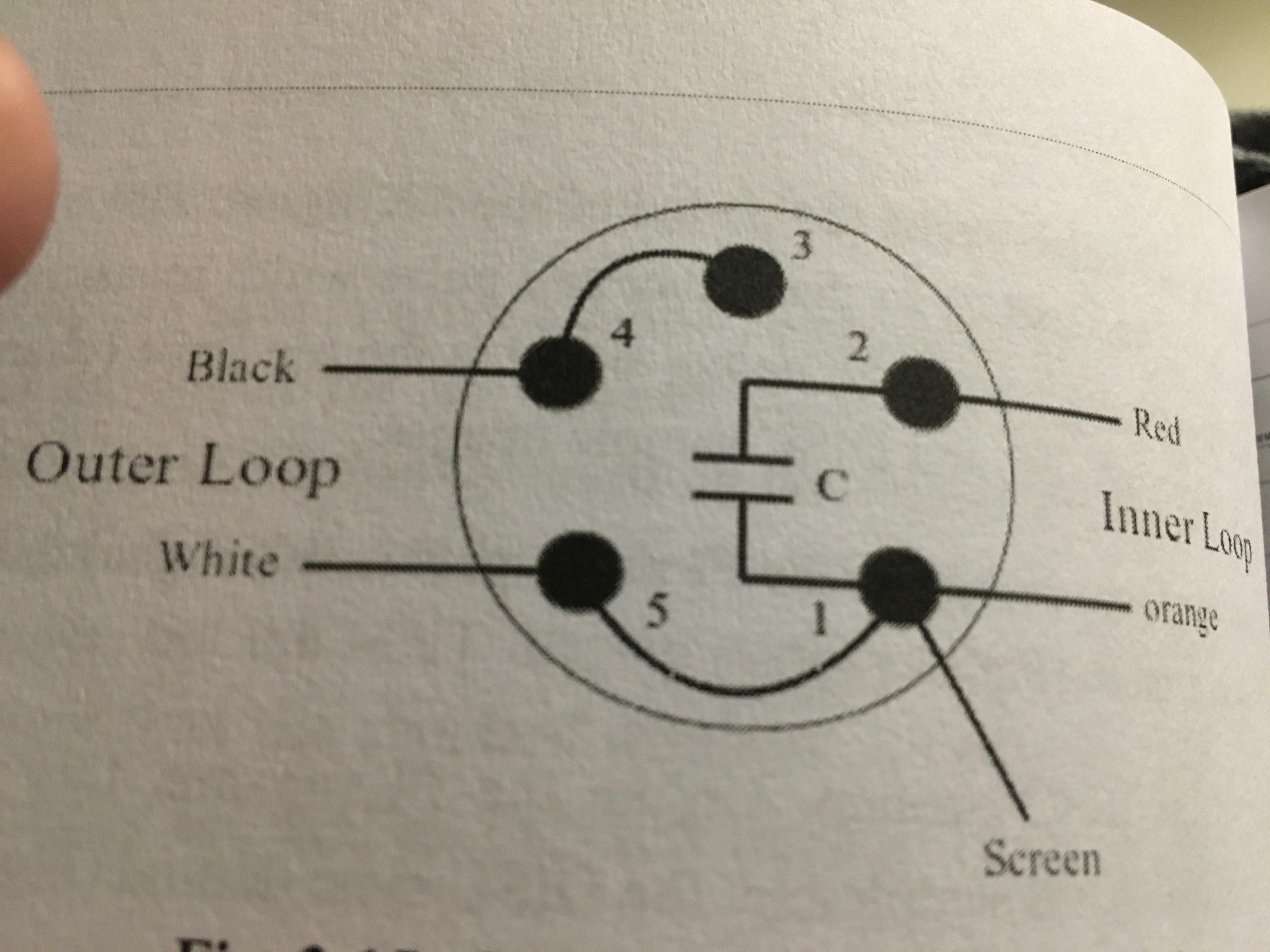

        • Am i reading this correct pin 1 and 5 are shorted together for 0 volt even though it gets 0 volt already and it runs to pin 3 which i assume is used for shield ground also and i used 2 rg58A/U wire so i only have 4 wires so what run a extra wire for ground and does it have to be shielded also but then wouldn't that be running through the resistor that is inline with 3 and 5

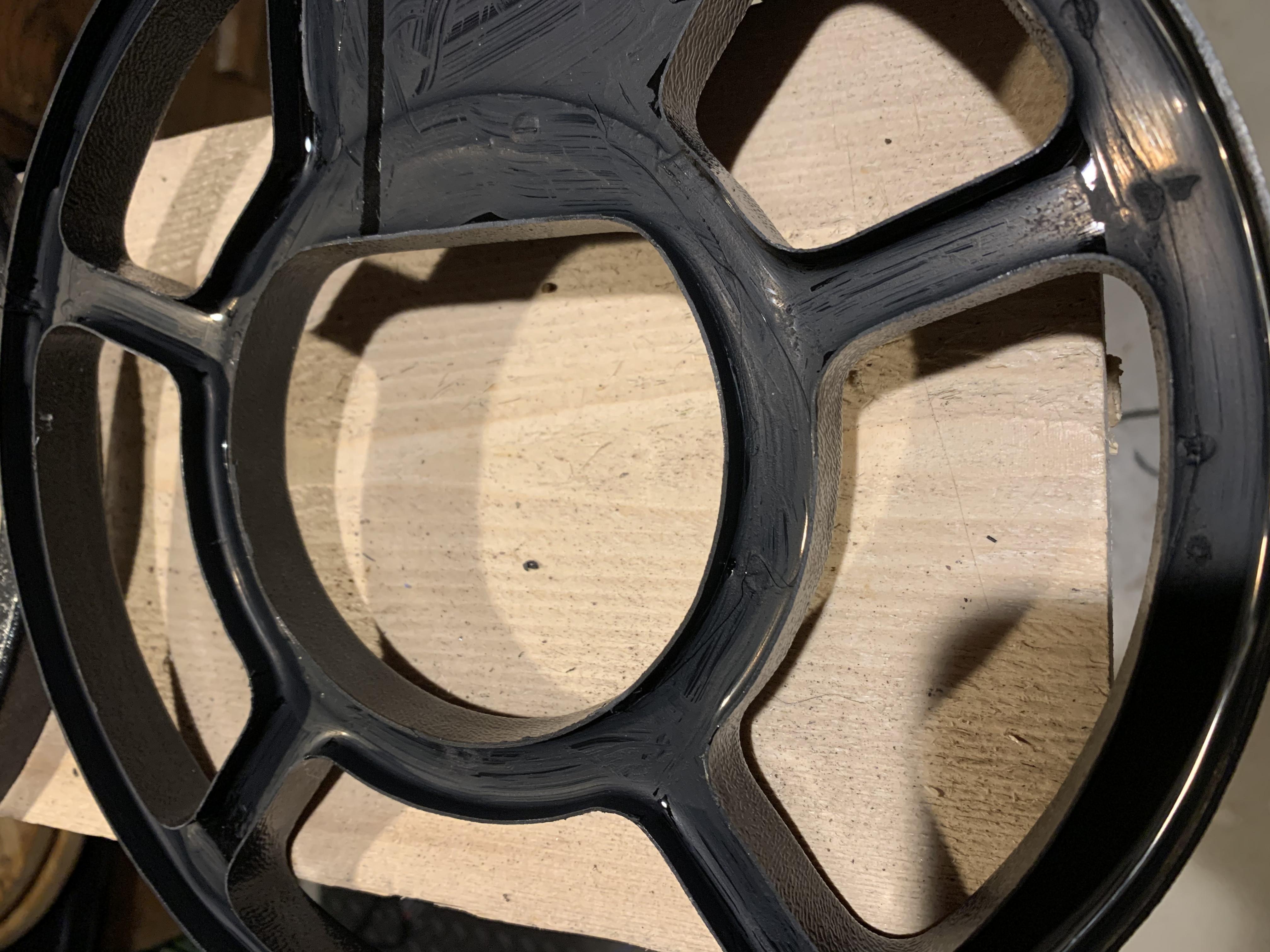

          • Im using that guitar shielding paint it came with a metal grounding lug and wire i don't want to use it have you found a better way to attach a wire to that paint ?
            • Originally posted by SilverSurfer17 View Post
              I?m trying something new, to me at least. I have painted the inside of the shell with an embedded drain wire, then added coils, then an epoxy fill and another layer of paint, then a final fill. If you look really close you can see the drain wire. It?s embedded in the paint. The paint is really thick. Not sure if it will work until I get to the wet grass.

                    • George are 1 and 5 suppose to be shorted together and is screen the same as shield thats why there is no pin for it Click image for larger version
ID:	359064 i want to make sure before i plug it in ?
                        George are 1 and 5 suppose to be shorted together and is screen the same as shield thats why there is no pin for it [ATTACH]54338[/ATTACH] i want to make sure before i plug it in ?
                        Yes, pins 1 and 5 should be shorted together. The screen of the coax cable must be connected to GND (0V), and the other end of the screen is connected to the electrostatic shield at the coil.
