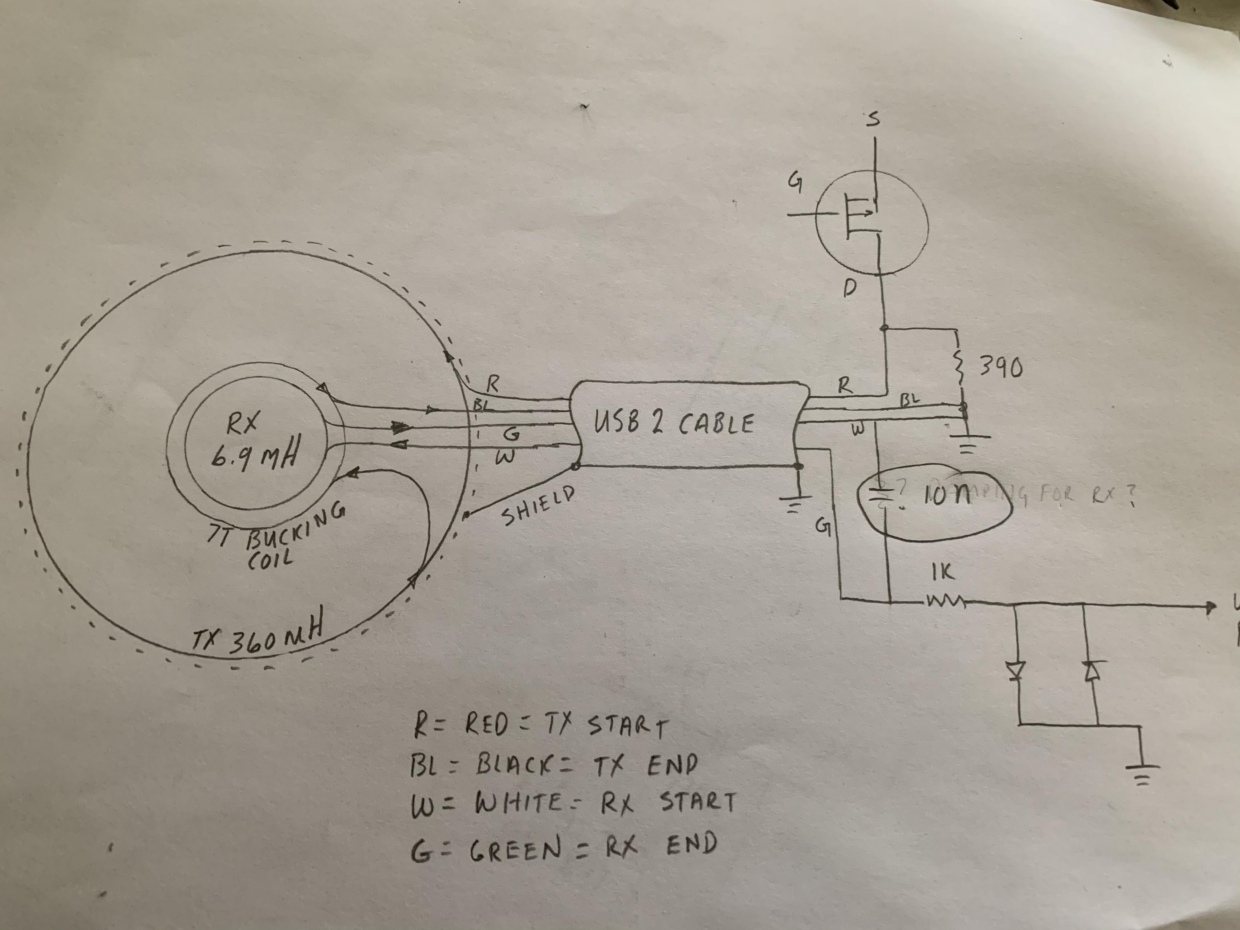

                          • Am I wrong or the Rx coil should be winded in counter clockwise direction? Click image for larger version
