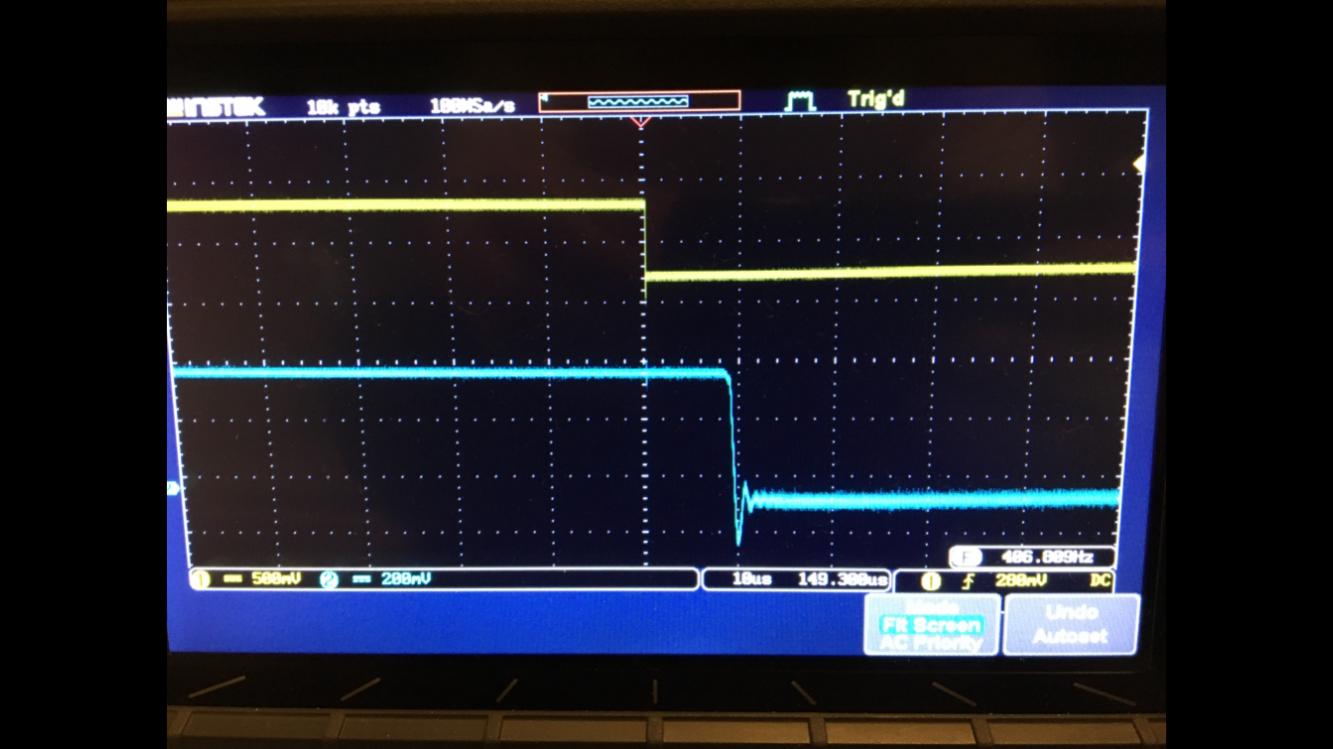

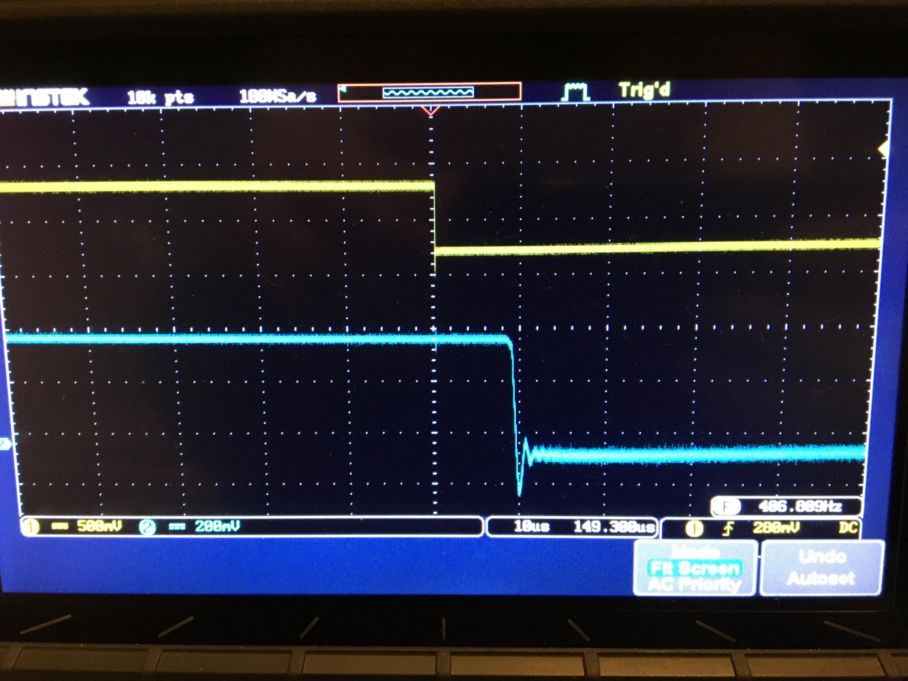

            • I must of burnt something else out on my board when the coil got hot from that speaker TP5 and TP2 look the same with or without a TX coil connected Click image for larger version

              • i eliminated the 5 pin and wired it right into the pcb that inner core to positive and the ground mesh to ground and on the other end one side to one of the tx coil and the ground to the other side and have the shield and the rx disconnected and i ohmed out the cable and coil and they ohm out so its not the cable oh and i have the jig wired one end to the positive side of the coil and the other side to the ground side and nothing changes plugging in the coil or changing the resistance on the jig

                      Disconnect the coil. Put a damping resistor across the PL1 (TX) . Then on channel one, take your probe and connect to one side of the damping resistor and put your ground to the ground side of the resistor. For channel two attach to the TP2 Debug and trigger the scope from channel 2. This will show that the transmit is working properly. I show this in my Part #2 video.
