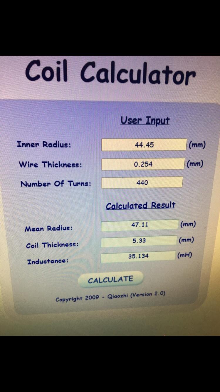

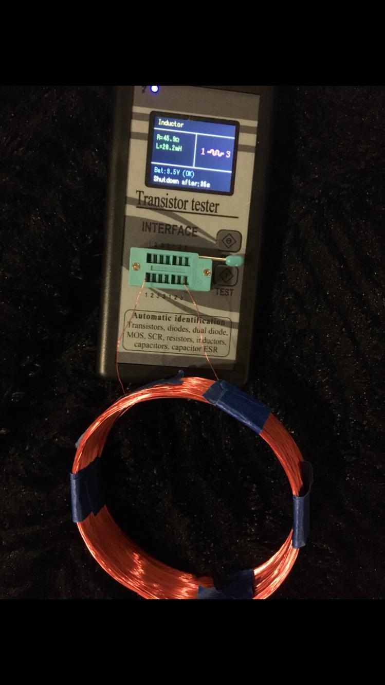

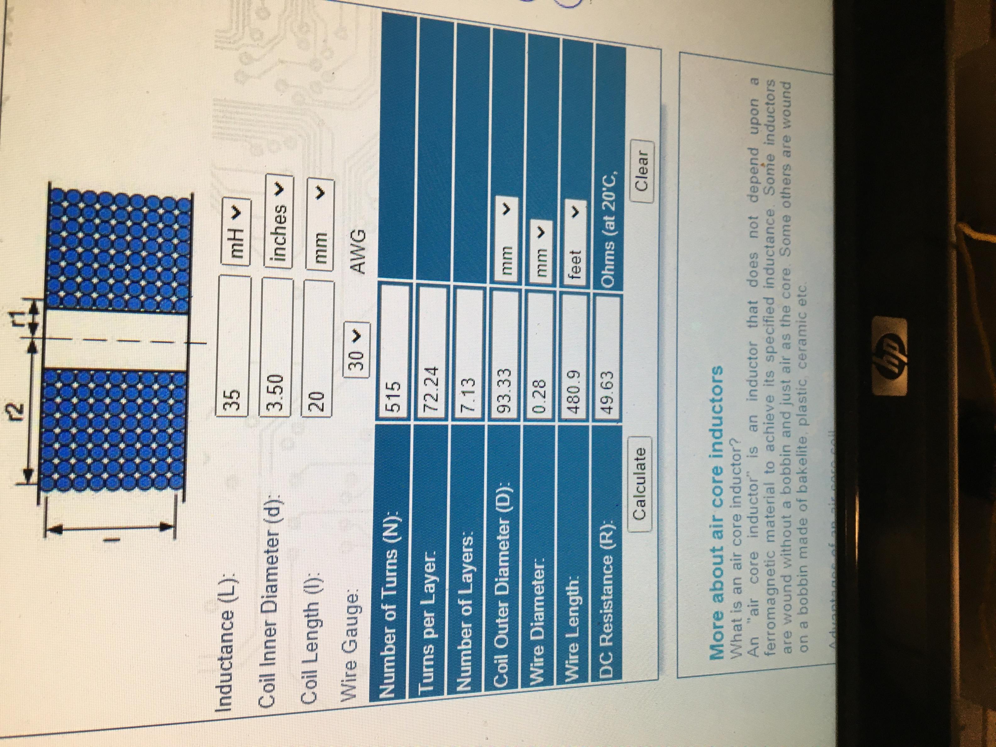

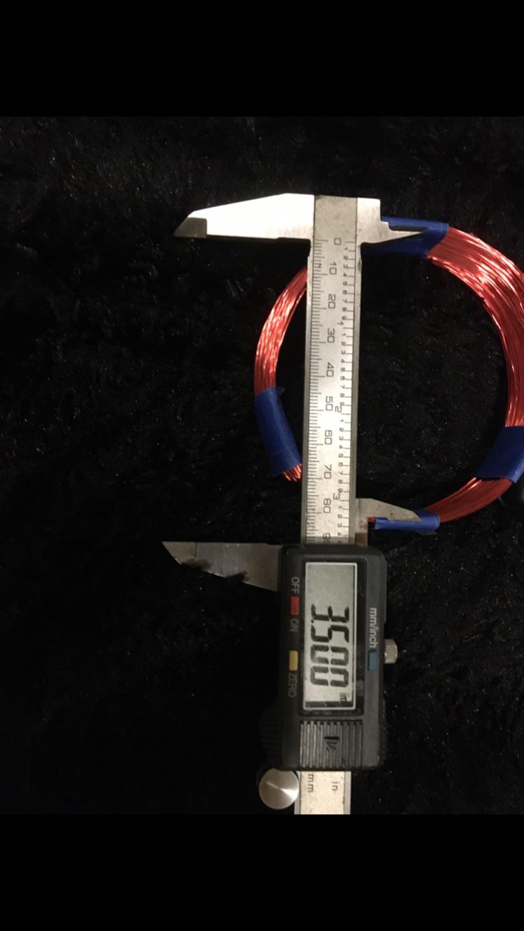

  • ok now i understand but that still means i did the calc right as far as i know and it didnt come out right this coil is 450 turns not 440 so it should of came out higher then i should of been able to remove turns to get it down to 35mh but its way below at 28.2 from what the calc said it should be with 10 less turns Click image for larger version

ID:	359030maybe with all 3 pictures you will understand what i did wrong

              ok now i understand but that still means i did the calc right as far as i know and it didnt come out right this coil is 450 turns not 440 so it should of came out higher then i should of been able to remove turns to get it down to 35mh but its way below at 28.2 from what the calc said it should be with 10 less turns [ATTACH]54299[/ATTACH][ATTACH]54300[/ATTACH][ATTACH]54301[/ATTACH]maybe with all 3 pictures you will understand what i did wrong
              Looking at your photos it is obvious why the inductance value is lower than you expected. You have left the windings loosely bundled. Once you tighten the windings the inductance will increase.

              • If you look at the last pic i posted it says around 500 turns the coil calc on here said 440 so it shorted me around 60 turns so either it is wrong or i typed something in wrong i don't know I'm just posting what i see

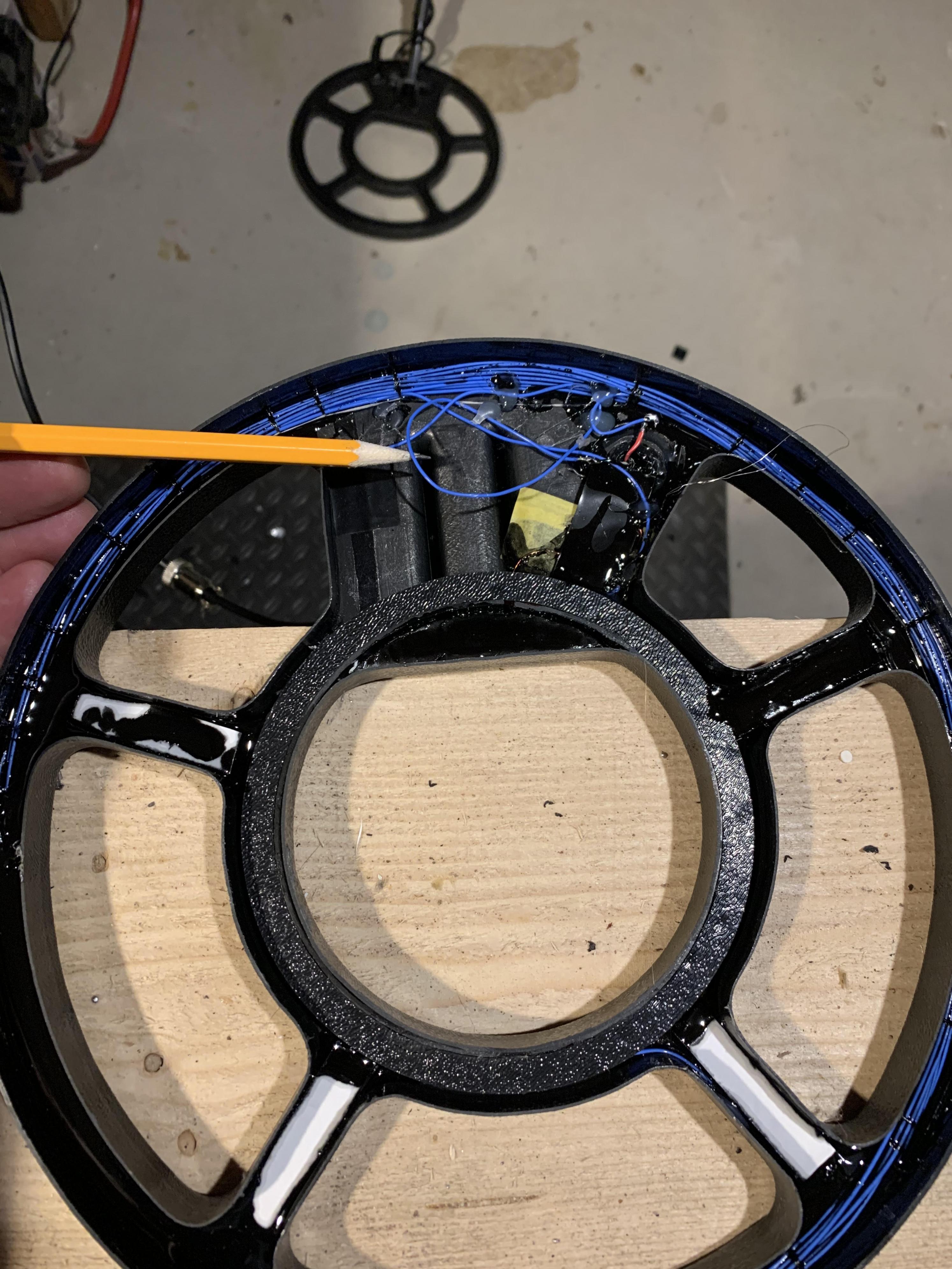

                          • Thanks for the CC tip, what is the blue wire at the bottom of picture in the spoke next to the white object ?
                              Haha.. You noticed. I went about 6 1/2 turns for the bucking coil until it nulled, and since it's an open center shell I could not return the wire directly to the ending point across the center . But.. I found out if I thread it through a spoke and double back same way that the main TX coil runs it has just a minor effect on nulling. The rest can be fine tuned with a small loop.
