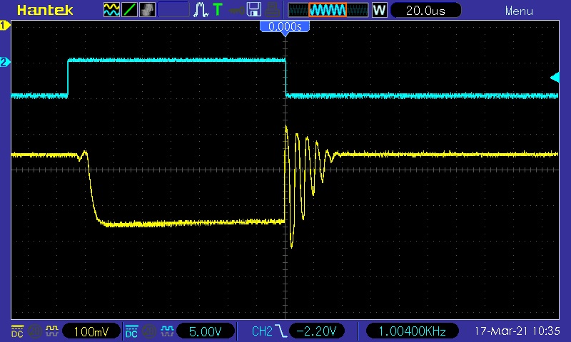

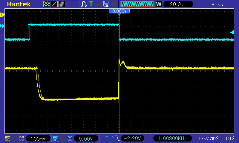

The TX inductance is in the accepted range. If the coil is well balanced (and I expect it will be) then there should be no ringing at the PI preamp output due to the RX loop. A parallel capacitor across the RX loop of 470nF will give an frequency of 10kHz.

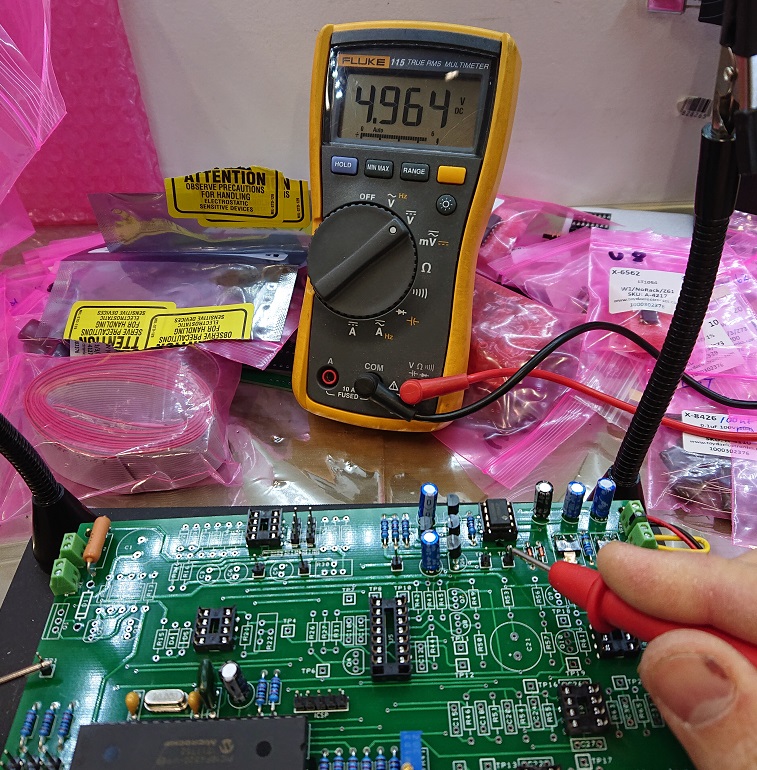

DFX coil attached. But TP5 has me stumped. I feel like I am missing something critical, but for the life of me I cant seem to find it. Pic's attached.
TP5 is the output of the first stage of the PI preamp, so there's some very basic fault here. Are you sure you have a +5V supply?Originally posted by dingbatca View PostDFX coil attached. But TP5 has me stumped. I feel like I am missing something critical, but for the life of me I cant seem to find it. Pic's attached.

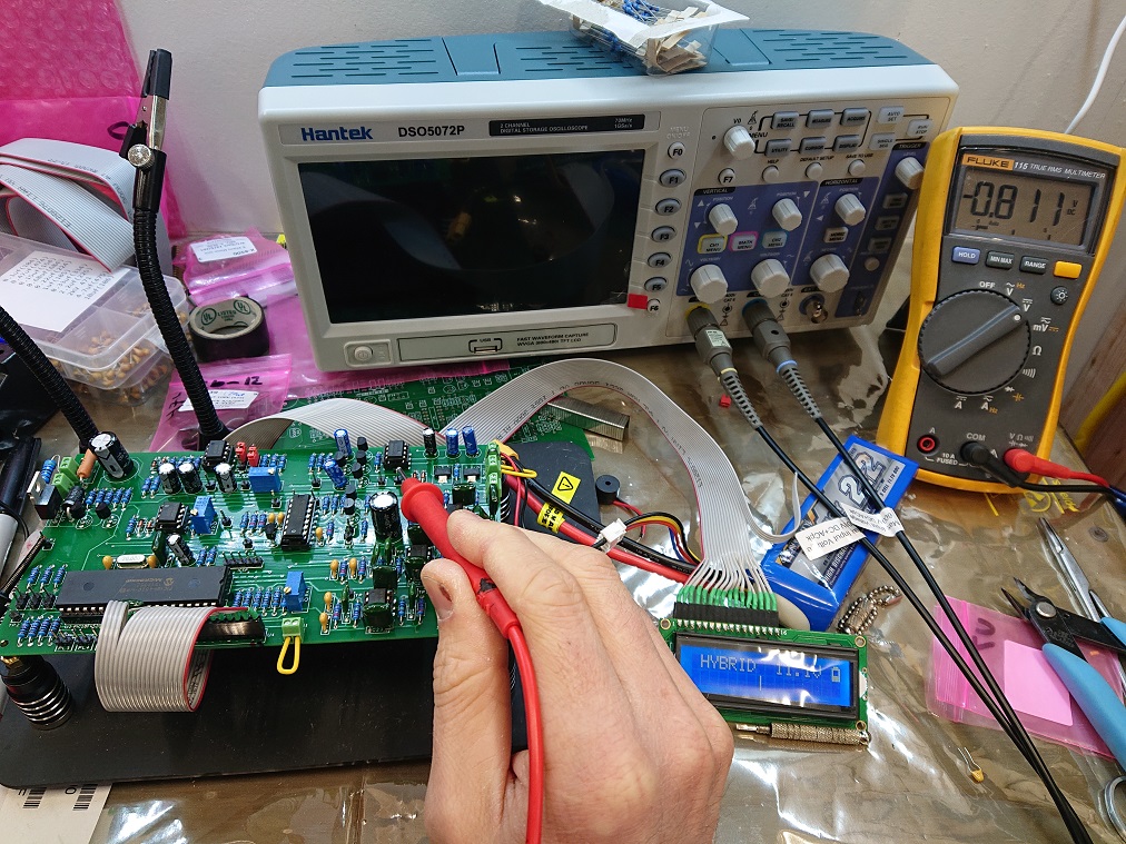

Correction. TP15 was reading +4.96V. Now it's reading -0.8V. I swapped out the 78L05 (U7) thinking I was having a regulator issue. No luck, still reading -0.8v. Any ideas? Pics attached.
Check the input pin of U7 (measure at the cathode of D6). I suspect the voltage there is too low.Originally posted by dingbatca View PostCorrection. TP15 was reading +4.96V. Now it's reading -0.8V. I swapped out the 78L05 (U7) thinking I was having a regulator issue. No luck, still reading -0.8v. Any ideas? Pics attached.
Then check the voltage on pin2 of U8.
U8 might be kaput or there is no sync pulse on pin 7. If sync pulse is missing, check on TP9.
Cathode side of D6 is at 9.51v. The data sheet for the 78L05 say minimum voltage should be 7V, so I think that's good.
Pin 2 of U8 is at -2.54V. Swapped out U8, no change.

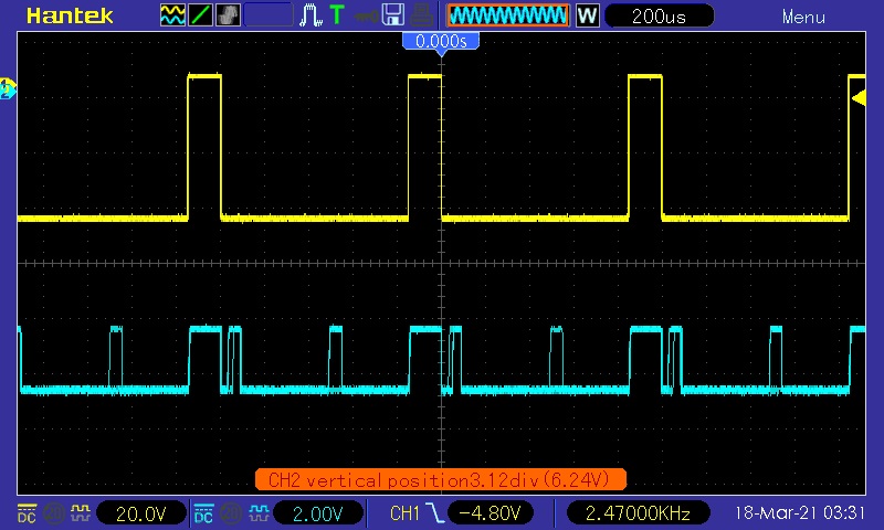

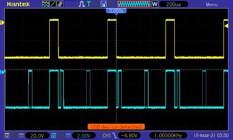

Sync pulse on TP9, and U8-pin7 both look kinda correct. Its not the exact same as the book. Scope pics attached.Attached Files

Pulled most the IC's and systematically put them back in. Looks like U9 is the problem child. Swapped out a new TL072 and the problem remains. I check the soldering and it all seems clean. I am guessing I have a component level issues. Any advice on debugging it? I will deep dive the chip data sheet and DISC schematic tonight.
